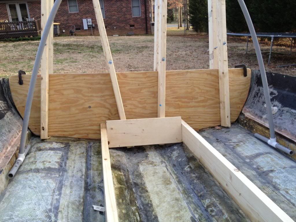

I don't have any pics right now... But the stringers and transom are both cut and ready to be glassed

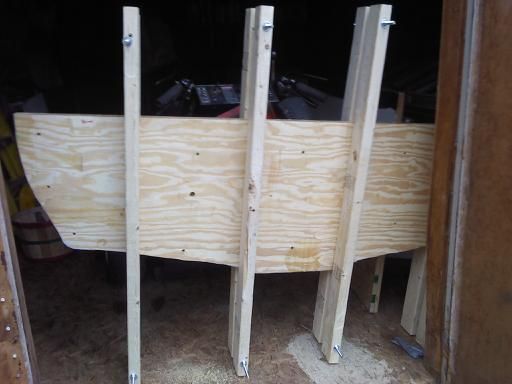

Here is the transom glued together

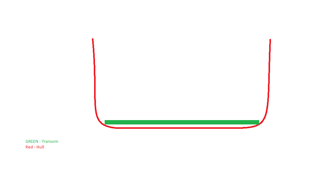

Ok I am a bit stuck! I knew that i was making the transom a little bigger than it needed to be so that it wouldn't be too small and i would have to start over... However it was supposed to be only about .5in to wide. well yesterday i went to fit it in the boat, so i took my belt sander and mad it fit like planned, but now i am noticing it is not setting all the way against the hull. it touches the hull on either side but there is still about a .5 inch gap in the center where the drain whole is. ?!!!????!!! I am thinking that i may need to cut my transom in a little more. i amthinking that the transom is hetting where the hull makes the rounded transition from the back of the boat to the side??? *picture below* But i am afraid that if I cut it in too much i am going to loose the strength of my transom.
any suggestions?

Your graphic is looking down on the transom from above correct?
If so, chamfer the BACK vertical edges only of the plywood transom....

Re: 1973 Chrysler Fin & Fun Rebuild
yup trim off the corners and sides until it fits down in all you need is another 1/4" then fill the other 1/4" with peanut butter. You want that on the sides too.
