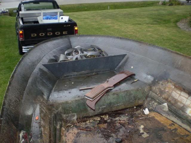

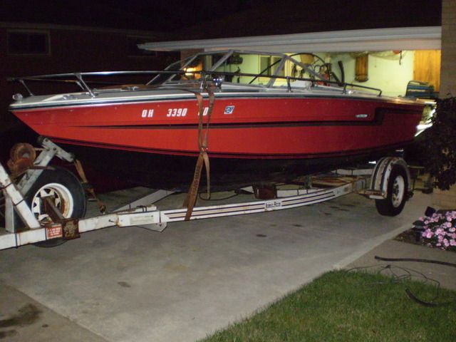

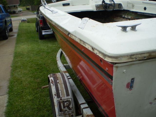

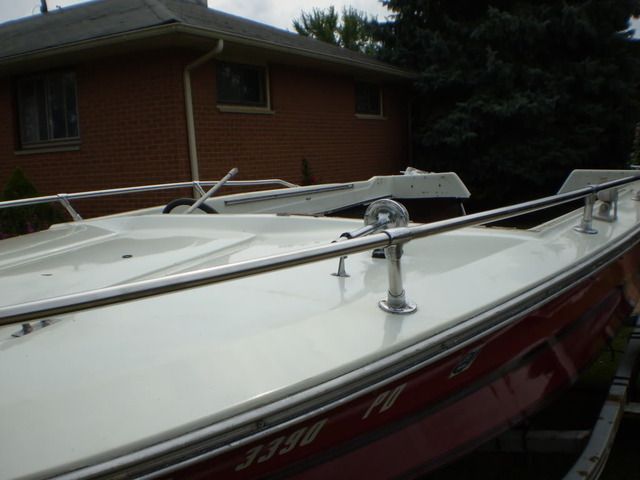

Ok I have done enough lurking around, check out everyone's builds. I have purchased a 1973 Sea Ray Srv 190 outboard boat, bought it on a trailer with a Force 120. Motor runs so i bought was told the transom rotted and the PO started to remove it but stopped didn't wanna replace it. Ok no big deal right just a transom.......
Well did some diggig and found this AWESOME "patch panel" that was installed.

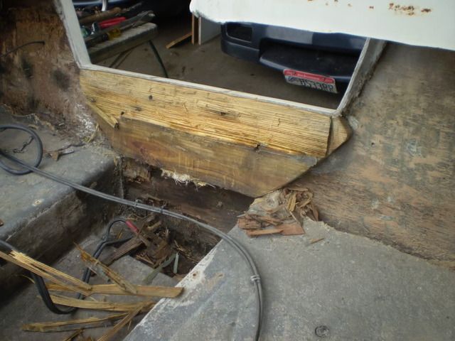

... Well ASSUMING it ONLY need a transom i cut out the splashwell.... dont yell at me yet this was before I found this wonderful place called IBoats.com. I wont post pictures of cutting the well because it hurts me that i did that:mad:.
Well at the moment i have any open hull with just stringers. i will post more pics tommorw. its late here and im tired from resizing all my pics. (At the moment have 100 pics) Josh

Welcome to iboats..... yes people have taken the route of cutting the splashwell out...... not our first choice but, it happens.
Resizing in photobucket is easy and gives you the 640 x 480 option ;)

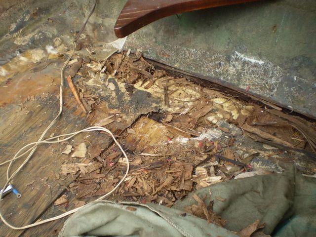

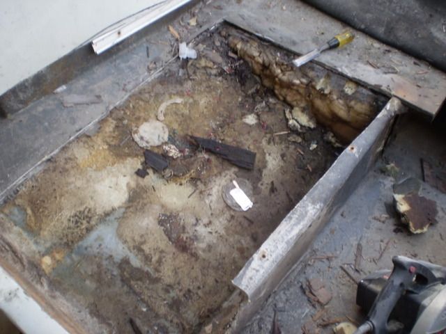

Okay, I'm not going to *try* to be the bearer of bad tidings... but I have done teardowns and resto work on two Sea Rays of that vintage, and learned some things.
In your bottom picture above, the small circular hole in the deck at the lower right is one of Sea Ray's foam injection holes. Part of their build process involves cutting these holes then injecting foam under decks to stiffen everything up and add floatation.
The problem is, the glue or putty they used to seal them shrinks over time, and cracks easily. Once that happens you have from 8 to 10 holes an inch or bigger on the top of the deck, usually under the carpet, that drain water right into the bottom of the hull.
Unless your boat is unusual, I'd recommend you plan on some serious work to get under the deck (which is probably wet too, from the edges of the holes) and remove a lot of wet foam. If you're lucky the rot of the stringers and the rest of the structure isn't too bad, but judging from the patch you found the boat has already needed work due to rot.
Soo.... I recommend you get all the disappointment out of the way now.. find out what repairs are needed. Dig in and plan your restore work. The question to ask yourself is whether you like this boat enough to do a complete rebuild so it's safe on the water.
I could be very wrong about the boat's condition of course, but it's a good idea to find out regardless.
On the bright side these are nice looking and handling boats, and once restored will last a long long time. Getting all the rot out will mean the boat will handle better and move faster... water is heavy.
One final note: Force outboards are not popular for a number of reasons, not the least of which is parts availability. If I were you I'd use it while it runs, but plan on replacing it when it breaks...

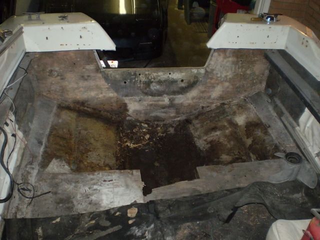

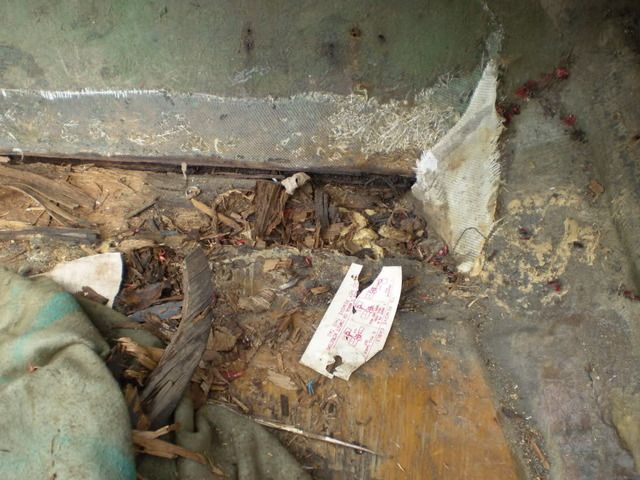

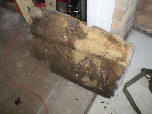

Ok well figured i post an update of stuff i've done. After i removed the splashwell, and chipped away the patch panel.
I was chipping away the transom that was next to the deck and water was starting to pour out.
So decided to tear up a section of the deck by the transom to inspect, and found nothing good.
this thing must have weighed 40 lbs.
So i removed both side and found tons of wet foam, this was my stopping point for the night it was getting late.

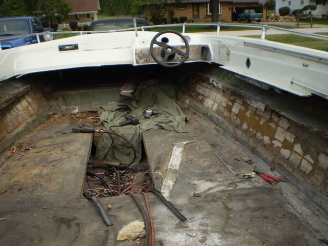

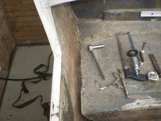

This was around the time i found iboats and was reading drewpster's thread and oops thread i mean book, it gave me motivation to do mine and do it right. Up with the carpet off with the cap etc.
Deck with carpet removed
After i removed the carpet, around the dash area i found the entry way for the water i found.
This is starboard side by the helm around where your feet would go.
This is port side same area by your feet, since this boat sat outside uncovered this was most definitely the entry point for the water. So off comes the cap i know there is problems underneath just waiting to arise.
Windshield removed.
Rub rail removed and car ready for removal
Cap is removed. In this pic you can see by the front there someone did a patch job on the deck and gave me a headache.

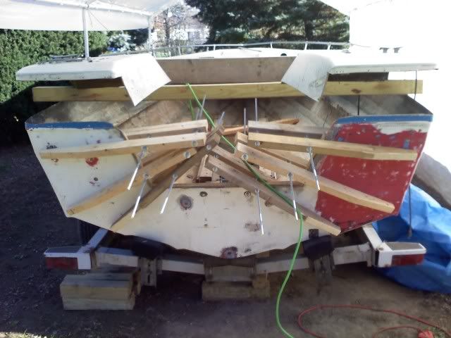

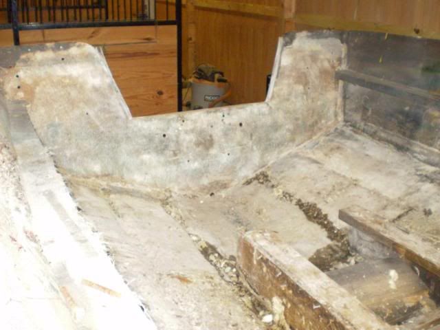

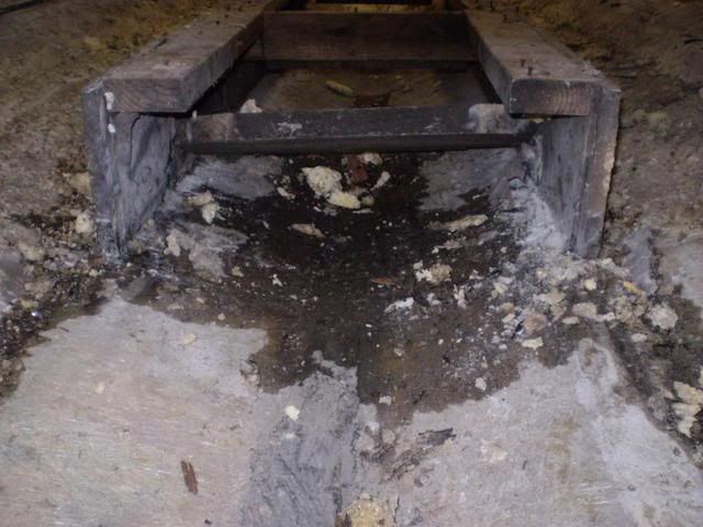

The above posted was done right before winter and during winter, just catching up. After i removed the cap i added a support to stop the hull from spreading to much and cut out the deck. I used my air die grinder and a hammer.
After that i removed all the foam, sorry no pics was to busy ripping that garbage out. Here is a pic after
And the water that was left over from the foam that was after some drying time.
As you can see in this pic someone already did the stringers and used dimensional lumber.
In the top pic you can see the stringers are about 2 feet short of the transom. Well those were rotted completely and who ever "repaired them" the didnt even scarf joint or biscuit them, just butted them together and threw some glass on them. So thats why they aren't there.
This is after some grinding the transom a bit.

Okay, I misunderstood where you were at. Nice work so far, looks very familiar :)
You're replacing the entire length of stringers, right?

Most definitely no point in half a**ing it now im there actually got some acx ply im picking up this weekend gonna get a ruf cut out done. Just added some PB to round the corners of the hull where the transom goes and hopefullly get it set in this weekend. (Had some voids in the hull)

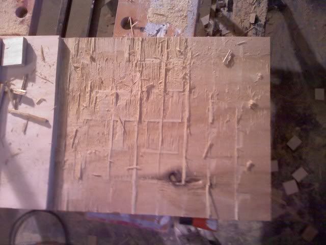

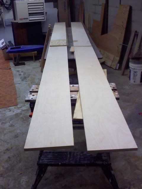

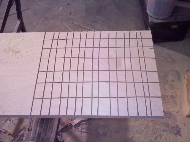

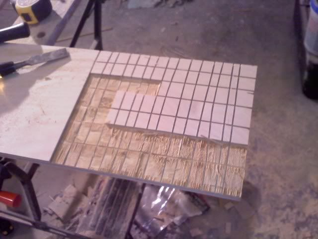

Recently i started making the stringers out of 3/4 inch thick birch, i cut out 4- 10'' wide strips, since my tallest height is 8.5 to 9 inches ill have some extra give room..

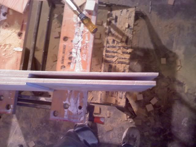

i then started to make a lap joint by making a few cuts to chisel out the chunks to make a 15ft long piece.
All chiseled out and ready for a final scrap and sand.
ready for glue
continued.............

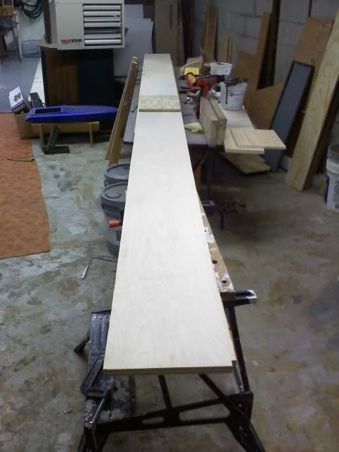

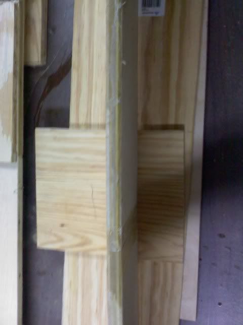

Since the 3/4'' ply is 5 layers I chisel out 3 layers on two of the board and 2 layers from the other two boards, that way at the joint it was a flush transition..
i put the two pieces one with 2 layers one with 3 layers together mocked it up screwed them together, removed the screws then added pl, spread it with a notch trowel then stuck them together and reinstalled my screws...
here is one stringer done ready to use old one as a template and do a trial fitting.
here they both are i will hopefully get one side of the old ones removed from the boat to make the cuts on these..
here is a pic of the joint to see how i made it flush..

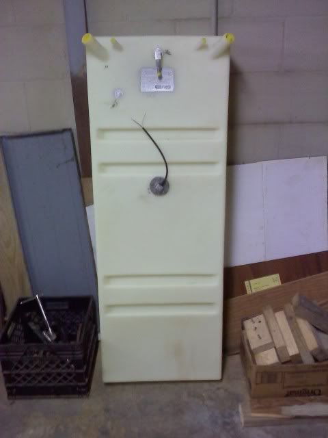

In the mean time i also have purchased a belly fuel tank... its 32 gal but i got it for 180 shipped.. its from moeller marine.. came with a sender and a pick up tube in the tank.....the only thing is i have to install 2 fills and vents.. unless some one knows a way to block off one of the fills/vent thats USCG approved?
