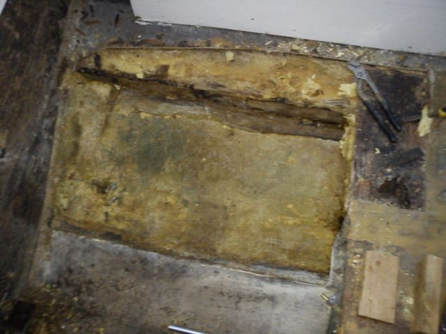

Here's a question for ya...my stringers dont go all the way to the transom...they stop about 1-1.5" short of the transom..inbetween the stringers and the transom is the foam...
hard to imagine how much strength it is adding to the boat without being tied to the transom.
anyone else every see a setup like that?
boatnut74
Aug 29, 2010
1,835
Re: 1973 SRV 220 OV Resto
Looks like you found a whole lot more work for yourself. I have seen a few boats where the stringers aren't tied into the transom but I think it is alot stronger when they are.

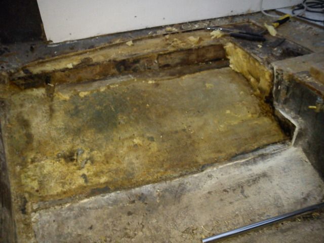

got some more of the transom out and part of the deck and foam..

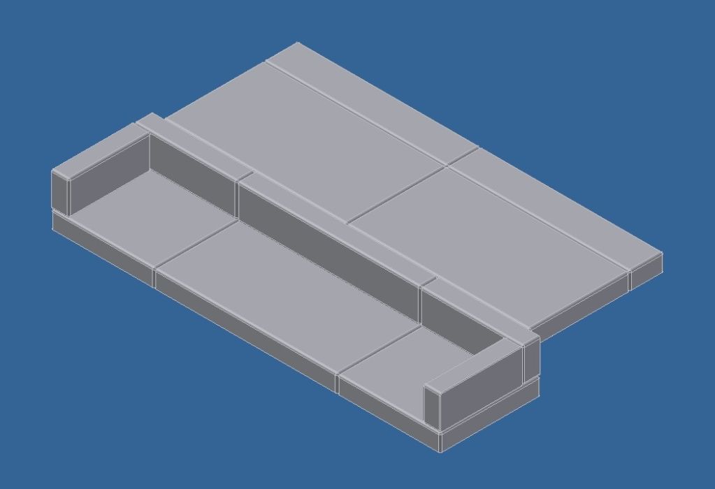

okay...here is my original design for my seating, and i have these seat cushions made..
if i re-arrange the side seats and their backrests...i can come up with a 72"x30" sundeck..
i can put the hinges on the outer sides of the deck and have it open from the center outwards to the sides...could put a couple of linear actuators on there so i can open/close with the push of a button
