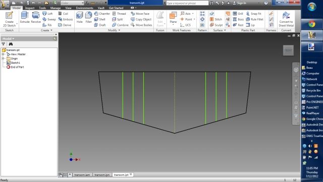

figured i would spend some time working on my transom layout.
one problem i am having is that i cannot pre-assembly/laminate the transom before placing it in the boat...the cap is in the way, and removing the cap is not an option..
here is one thought...3 layers of 1/2" ply with glass in between each layer..each layer is also divided in 3 sections..
each seam from each layer is staggered 6" from the seam on the adjacent layer...depending on the order of how the layers are placed.
i have a stress analysis running on a few different scenarios of different layouts of which layers are placed in which order
thoughts??

was also thinking about cutting the joints on 2 of the layers at opposing angles...so when all 3 layers are stacked, the individual panel joints will form a sort of crossing pattern...

i think i have decided to do the angled cut patterns...using 3 layers of 1/2" ply...with either csm of 1708 between each layer, which ever would be better....
i am also assuming that the first 1/2" layer gets bonded to the inside of the transom with PB or PL??
thoughts?

my thoughts on the lay up of my transom (see above posts why i'm using 3 layers of 1/2" vs 2 layers of 3/4")
your thoughts??

I really like your lay-up schedule and if you can carry it out on the vertical, it will be Heck-bent for solid...
Just make sure you...A- have everything ready to go for each layer of CSM and Ply...preferably have a helper, pre-prepare your resin batches { don't make one giant batch because it will kick off faster than you can shake a stick at it, due to the heat generated by the volume} pour out several small batches, say a quart at a time, with the MEK-P ready but separate, to be added as needed, have all your CSM pre-cut and marked as to there respective locations...and...2- Most of all do a couple of rehearsals to make sure you have everything in "synch"...remember that as you lay up the laminations, you need to clamp them solid before they start to kick off...for speed, you could use Stainless Steel drywall screws and just leave them sealed in place...Remember, that you only have about 15-20 minutes of working time with the resin, so you have to make sure you have everything worked out beforehand to prevent a catastrophe...
