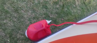

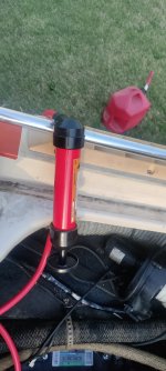

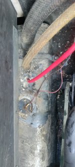

Meant to post last night:
Just got done pumping it out. Filled two 5 gallon cans to the brim, no more, no less.
Wasn't able to get filler or vent hoses off. But there was a plug for a starboard-side dip tube that I was able to pull and use with a transfer pump. Not the most labor efficient way, but it worked. As does the gas gauge which I periodically checked.
Fuel didn't look bad... Smell was a bit off, but not like varnish. No rust. 1st can was black but that's because the pump was last used for changing the oil.
Once I get the old fuel disposed of, I'll get some fresh fuel and see what happens.
Edit- My front yard is non burnable enough that I once set grass on fire while welding my mailbox and it didn't spread very far.

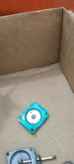

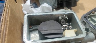

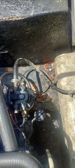

Pulled the carb apart after finding that clean fuel going in was becoming yellow fuel dumping out... and that accelerator valve and primary jets are not flowing. I'll add pics later, but lots of dry deposits inside with a bit of rust on internal springs. Venturries are black as coal... yeah, needs cleaned and rebuilt.
Wasn't planning on replacing floats but those are starting to crack... :poop:
ratdude747
Sep 30, 2023
487
Got everything tore down and cleaned.
Seems that idle mix screws were both bottomed out... weird. I'll have to see if there is a stock setting to try intially (for now, I have them set to 1 turn out). Also, the inlet screen was partially varnished over... and the choke heater air breather was also plugged with dirt. The accelerator pump check valve weight was seized with varnish/junk, which is likely why the accelerator pump wasn't working.
I should get the kit (and two new floats) in this week... fingers crossed, but it seems I'm finding answers to questions.
Added pics, including the old fuel line.
