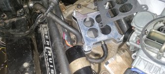

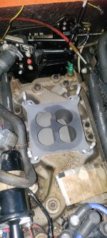

Got it to idle a bit better:
  • Tightned the carb nuts with a 1/4" ratchet instead of a nut driver.
  • Discovered I had a loose connection at the engine wiring harness plug (causing me to lose all 12V power after idling a bit)
Still has a bad vacuum leak. In addition to the PCV issues, I'm pretty sure my carb/carb spacer gaskets are wrong. used the same soft paper/foam type eBay gaskets (4 bore) on both sides of the spacer. Might be wrong.
Will edit in some pics.

Took the PCV apart:
  • Looks like the big hose (Marked "Motorcraft 5-55") and it's PCV valve (an aluminum Motorcraft EV8, Made in USA 🇺🇸) are in fact stock. The hose isn't in that bad of shape for 48 years old... some mild internal cracking on the very ends (past the spring clips) but the working area is crack and rot free. The PCV valve is still moving nice, and moving a lot nicer after rinsing it with some carb cleaner. Call me cheap, but I'll reuse both of these (although I may swap the hose for a molded replacement, some of my old ford truck suppliers make such things). The hose and PCV nipple are 1/2"
  • The other hose is just automotive fuel line. Where it curves it hits the intake... and the cardboard they had as an insulator is there because the hose was actually burnt to a crisp! Didn't have any obvious through-cracks, but not a good part at all. I can do better!
  • The carb spacer is tapped for 1/4NPT... not sure if that's something edelbrock made as a custom part or if somebody else did it (if they did, it looks well machined).
New plan: ($40 shipped on Summit racing)
  1. To fix the carb spacer to intake sealing issue, I found a fel-pro marine gasket that should fit the bill (17847)... Holley 4150/4160 bolt pattern, 1/4" thick, open center (which I read is good- allows some crossover). With some photo editing, here's what that gasket will roughly look like CarbGasketSimulation.jpg
    Should fill the gap nicely. Closer to/better than what was there originally (I think it was 1/8, thicker than what I currently have!
  2. To fix the PCV issue, it's easy. Spin the spacer 180° and install a proper barb (such as this one I ordered). Might need to trim the hose due the 4 barrel being longer than the original 2 barrel, but I think that'll work a lot better than having the extra loop that burns up...
https://www.degreesymbol.net/​
