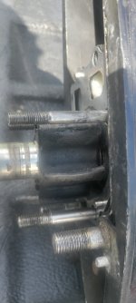

Outer tube not looking too good. Inner tube still in upper outdrive and looks ok.
Edit: should have bought another housing kit. Housing is melted. So much so the impeller is stuck on the shaft. IMG_20240518_123107.jpg

Game over.
After a 5 hour round trip I made it back with the mercruiser kit... Only to find the shaft and lower housing are also trashed.
Had to do a lot of filling on the shaft die to impeller can material being friction welded to the shaft:
And the lower housing is melted...
The shaft may be OK since I dint really file the seal area. But the kit didn't include the lower housing... And I long threw away the old one.

Dunno if the mc-1s have the same plastic water pocket in the upper as the alphas, but that drive got toasted pretty good, so might want to check that out while you're in there
ratdude747
Sep 30, 2023
487
Will look. Yes, there is a plastic water pocket upon review of the best exploded views I can find.
In the mean time, I did ebay an NOS OEM lower impeller housing. Wasn't worth today's drive since I'll have to cover up the exposed outdrive areas anyway...
Edit- water pocket looks fine.
