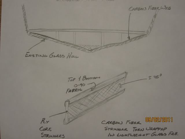

MM, not sure how pulling out some poundage during the rebuild would change the vessel dynamics. Currently, the 22 gallon gas tank is in the bow and there isn't a great deal of change in the feel between full and empty, so that is a weight change of approximate 120 lbs (this might be an argument not to worry about weight?). What if I could pull out another 80-100lbs. The stern sits pretty flat where the engine sits so she seems pretty stable.

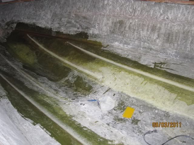

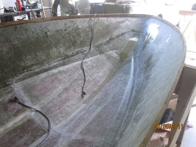

When I look at a transverse cross section through the hull it looks just like a truss. What if I lined the inside of the hull with a carbon fiber weave oriented 0-90 from stern to bow to behave as a stiff web attached (bonded with epoxy) to the bottom side of the stringers. As pressure from the water loads the web, the truss will absorb it, as it should. I could really stiffen the structure up by wrapping carbon fiber in the stringers oriented +-45 on the sides with bottom and top caps running 0-90 (considered using unidirectional on top and bottom). My thinking is the existing fiberglass hull just goes along for the ride and absorbes impact damage.
I'm thinking out loud here...
I sketched this out
