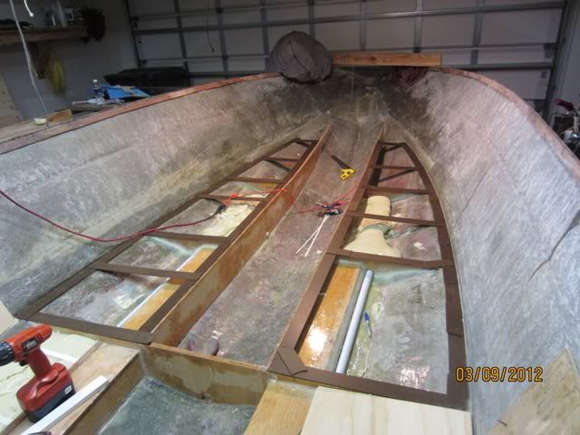

I got all my drains in. I detailed this out in another thread, though in hindsight I should have just kept it all in one place. So, here is the process I used for the drains.
1) I ran a hole saw through my stringers prior to installing them and placed a 1.5" stub of 3/4 CPVC to drain in bilge. The 3/4" pipe fits a 5/8" plug very nice. Once glassed in and over it was easy to grind it out. It must be plugged with a bilge plug to prevent water from going in. An inlet was made to the bilge in both the bow and stern. I thought if I ever wanted to blow dehumidified air "through" I could as long as the drain sytem made a circuit.
2) A piece of drywall corner beading was laid in all the low areas and covered the bilge CPVC inlets. It was tacked in place with a couple of drops of hotmelt. The engine runners were a little higher than the main stringers so there is also a segment that connects the two - I have this in the photo. I used epoxy so you will not see glass wrapped around this particular hole, but there is certainly enough epoxy on it.
3) The key is timing and making two pours. When the 2 part foam was mixed I kept stirring until I could actually see the foam just start to expand. At that point the foam will transition to being really sticky so it must all be poured within a couple of seconds after expansion starts. This prevents the foam from going through the holes in a liquid state and does not clog the void you are trying to create. So, the beading is just covered in this pour, then the remaining cavity can be poured in as a liquid becuase your drainage void is already established with a hard foam cover.
Ground pipe that will drain to bilge and rest under the corner beading
Plug that will seal the drain off

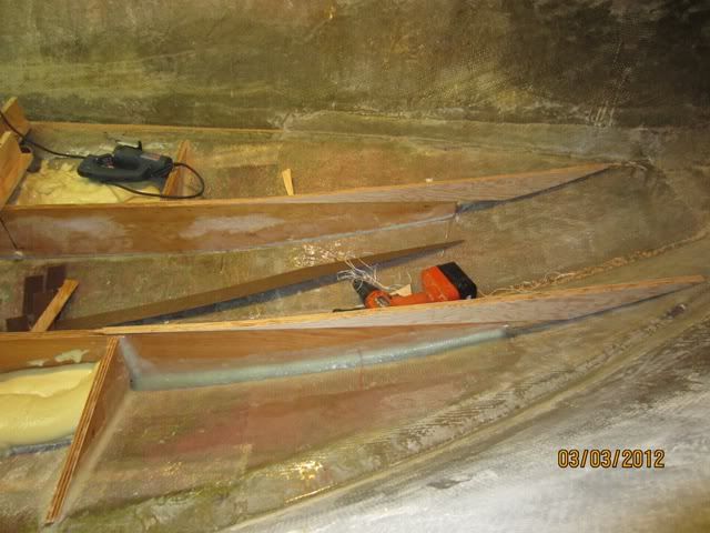

Additionally, I made a little more progress on the stringers: they are all done. I just need to do some fillets and glass in the blige area. Then down with the deck.
Curved Transition in Bow
Shows port side drain. She is dying for some foam and deck.

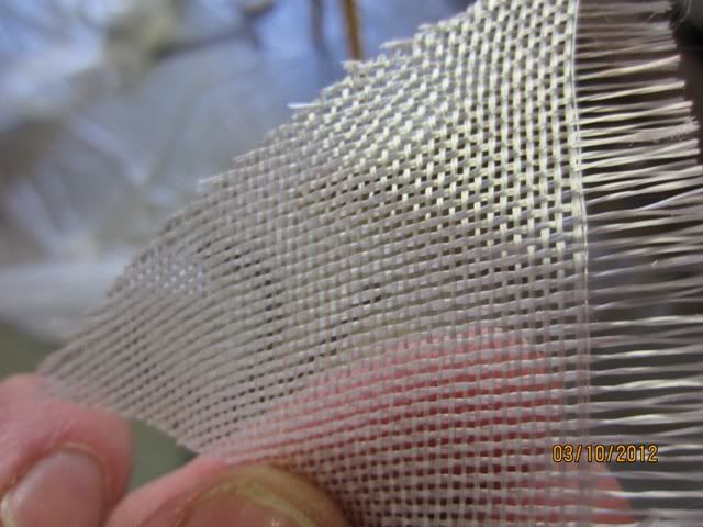

The goal today is to get this ply cut and seal up the bottom side. I am using epoxy so the glass that wil go down is just a 4oz loose weave. Someone please chime in if you believe this is not adequate.
I am leaving the center ski locker section of the deck out for now so that I have good access for painting. This section will be all constructed prior to painting though, just not assembled.

As long as the 4oz is epoxy compatible, it will be extremely sufficient. Epoxy is stronger then poly resin, and usually poly resin & 1.5oz CSM is used. So 4oz glass plus epoxy should be more then good.

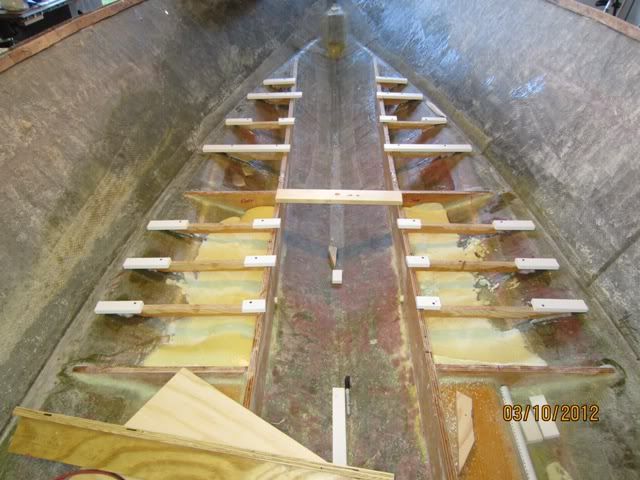

I accomplished my goal for the day. Easy task to transfer the pattern to the 1/2 deck ply, which is the Arauco brand that so many speak of in this forum. Since the bow in concave I screwed on a stiffener to pre-bend the plywood prior to glassing. The 4oz glass that was used wets out really easy with a squeegee. It was placed on dry and epoxy poured over it then I used a utility knife to trim off the overhung glass.
Some ribs were also added to the hull primary to be used as stiffeners beneath where captains chars might be installed - I haven't decided yet what kind of seating I will be using so these were just in case. Since they were easy enough to install I continued them up the bow to be used for additional nalers (screwers) for the deck. There are some plastice pieces at the end of each rib just to temporarily hold them in place.
Deck pre-bow
4oz woven glass
Glassed deck
Added ribs

It all looks really good, just a Q:
The break between 2 adjacent sheets of floor deck fall on a rib you added?
And 2 things to consider:
Depending on which seats & or pedestal your using, you can double up the thickness of ply UNDER the deck, or lay a 2nd piece of ply on top of the deck (Friscoboater used the over method). I like the way Friscoboater's deck looked w/ the cut to fit carpet and the top layer of extra ply. Doubling it on top of the deck allows you to use T-nuts without having to make a firm seat decision now. Doubling it below w/ out a seat setup decided yet makes T-nuts impossible. But isn't a visible doubler.
A slight tab or ledge around the underside of the lip of the ski locker will help support the lid. Again reference Friscoboaters build.
