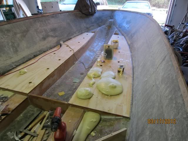

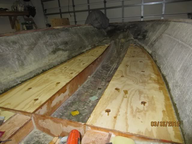

She's all foamed in now. By the time I finished the very last section I was starting to get the hang of it. One really has to be careful with the mix volume. I found that heating the liquid prior to mixing gives the best results. Also, purchasing a package of clear drinking cups was a great help.

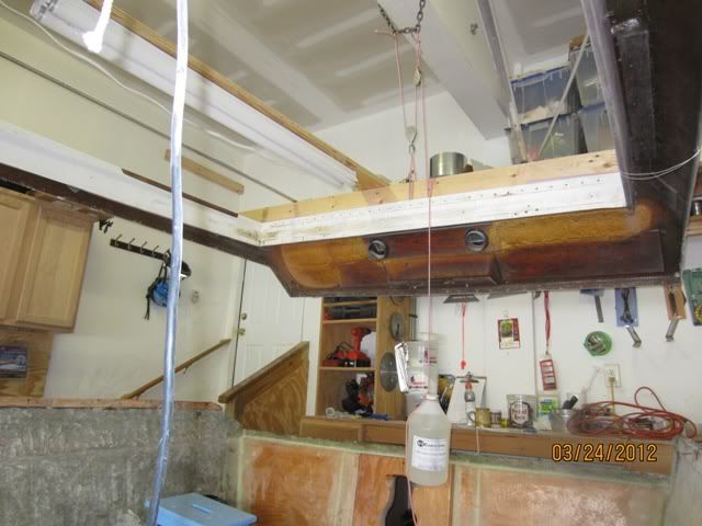

I set up a pulley rig for the cap so that It could be lower onto the hull with one person. This worked so slick. A two pully system was used and the free end of the rope was wrapped several time around the 2x4 screwed to the cap. Even with the multiple rope raps the cap would fall if I was not holding on to it. So I tied a bottle of resin to the end. This allowed me to push up on the resin bottle with the smallest of force to lower the cap.
The cap is only on temporarily so that I can easily mark out the location of the gas tank, engine mounts, seats, and ski locker cover. All of these measurements were recorded prior to cap removal. I am telling you I am so glad I took the time to make the hull cribbing in the initial stages of this restoration as the cap snapped right on without a single issue.

First foam pour was a little messy
The last pour shows I was learning
Pulley system

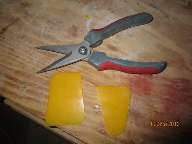

In my last post you will not notice any glassing except at the transom. The reason for this is the preference to make a wet layup with the fillet. What worked best for me was to lay the fillet and let it set up for an hour-ish, then lay the first layer of glass in by hand as it will stick very nicely to the fillet. The little $0.65 chip brushes worked great for applying the resin. The squegees work great for applying resin in other areas, especially on large flat areas.
Below is a picture showing my best friends for the fillet process. I custom cut the squeegees (from the same supplier you bought the epoxy) to the fillet size I want. Works like a dream. I have tried spoons and the like, but nothing compares to the squeegee.

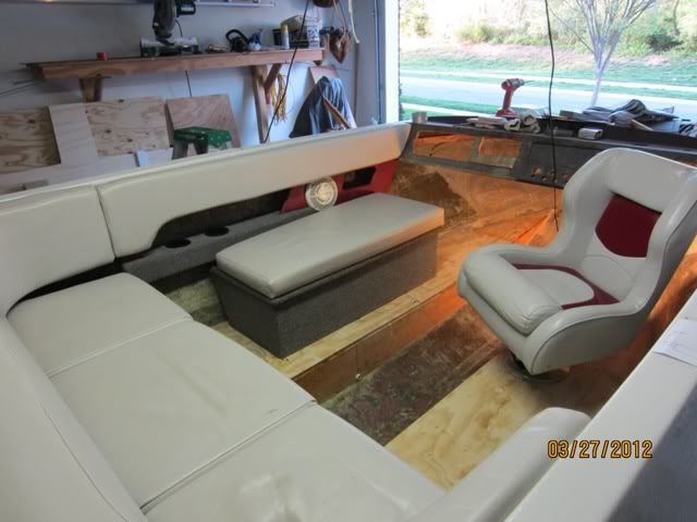

Guys and gals I need you opinions... and creativity

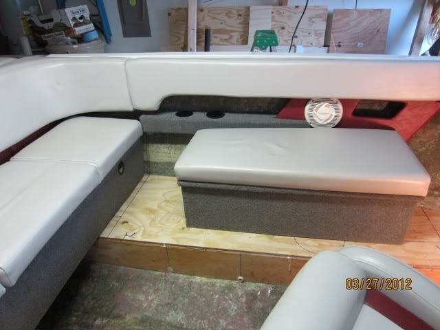

I placed some of the old interior parts back in the boat to start thinking about future layout. While parts are not in bad shape I think it is a little chopped up and the styling is a bit to modern for the boat.
The thing I don't like at all is the port side seat. It is really just a box, which is good for storage but looks ugly.
I am thinking a wrap around L-shape seating with the single captain's chair, or two captains' chairs up front and bench in back. For the latter, I lose a lot of storage.
My hope is that you who have been around the boating world for many years can help me decide. I want to balance functionality with good looks and comfort. Pictures would help a lot.

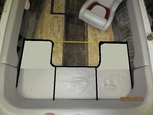

JB, thanks. I kind of like the wrap around idea. Is this what you were thinking?
Maybe I could narrow the whole u-shape by 1.5" all around.

Yep, in fact you drew the forward (top?) portions of the U further forward then I was thinking. Just enough forward to allow a more lounge type sitting position when facing forward, seated w/ your back against the bench backrest, & barely enough room for a kid butt to sit on that U leg & face inward, w/ their back against the gunwale.
If there's room to do the front to back fold out lounge as a passenger helm seat, keep the port side straight across the transom, no U leg on the port side. And make the starboard U leg as far forward as you can & not interfere w/ the captains chair. The starboard U leg extending even a little further forward then you have drawn above. That way when at anchor or just afloatin', fold out the passenger front to back & have a HUGE bench seat from the passenger side dash all the way around to the leg behind the captain's helm seat. But when only 2 people are in the boat, they are both in the helm seats.
We were all gunwale rats on my buddies fish&ski, sitting on the gunwale & splashwell bench back..... Hardly ever used the 2 front to backs as loungers, but they were always folded out when afloat.... Make the seating fit how you will most often use the boat. And then if you can tweak the layout a little to allow for some different configs, even better.
