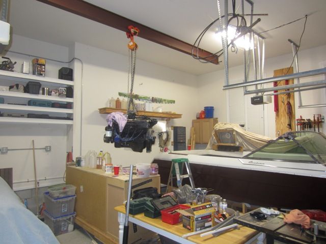

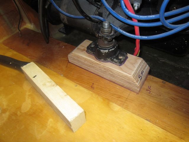

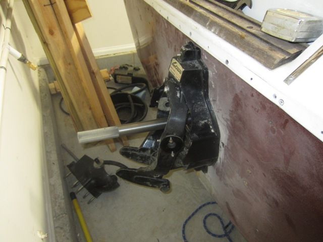

The first thing for me to do starting back up was to set my engine mounts, which required the engine to be in the boat. Since the garage set up was new I was thinking future so I completely tore out the floor in the room above the garage and built a truss structure within the the floor joists to support an I-beam for ease of engine installation and removal.
So the pictures to follow

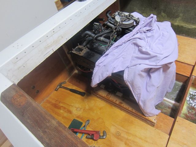

1) New I-beam set up
2) Ensuring engine alignment
3) Engine mount setting
4) Set engine mounts.

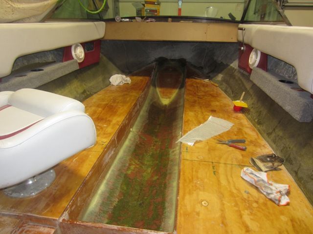

5) Glassed ski locker - I need to paint this next to finish floor construction over the top of it.

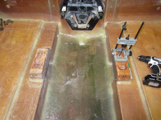

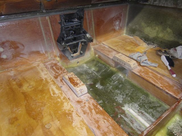

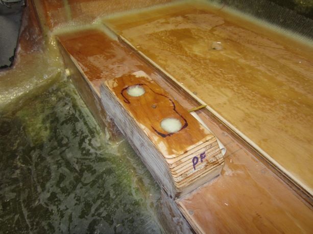

1) Engine Mounts - my strategy here is to never have a screw or through bolt touch wood, so I pre-drill and holesaw everthing oversized and then fill with epoxy peanut butter with chopped strands. Then I will come back with through bolts. Overkill? Perhaps, but this is how I am rolling with this.

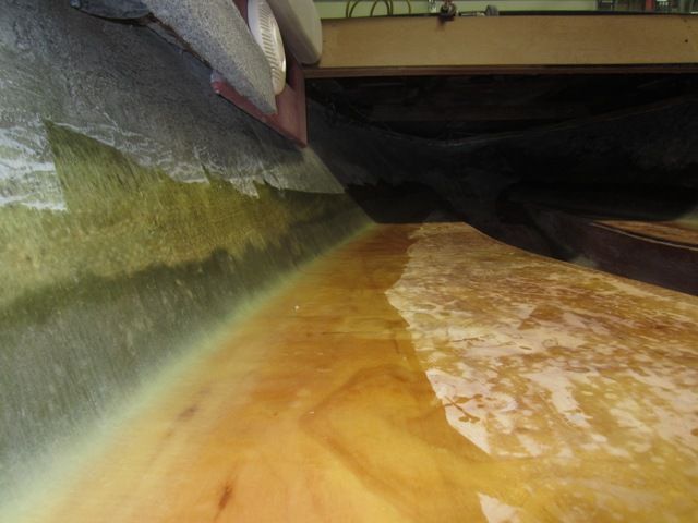

2) Tabbing - Applied my fillets and tabbed the gunwales to the deck in the engine compartment. Hull to stringers next.

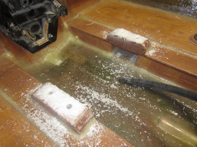

This weekend I focused on the engine compartment. I have it all gassed up, engine mounts set, and dropped the engine back down just to ensure I have maintained alignment with the over-sized glassed in through holes. The Engine alignment tool was also used to ensure proper alignment, and... Perfect.
Photos:
1) remarked the location of engine mounts and maintained perfect alignment as previous. Used a makeshift guide for drilling the holes straight, which worked pretty well. Its no drill press but does the job.

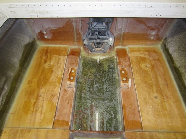

2) After piloting the through holes I went with over-sized 5/8 drill. Absolutely no wood chips after drill. There will be no future water penetration here.

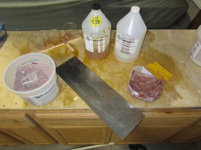

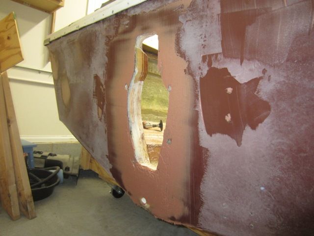

So I got a little bug to do something after work today. When I clamped the transom ply together with the outer skin many months ago there was always a bit of a dip in addition to a hollowed out area by the drain. So today I pulled the transom plate assembly and leveled this area out.
Pictures:
1) Equipment and materials used to screed the fairing compound. That chunk of sheet metal was just the right size!
2) final results immediately following the screed process

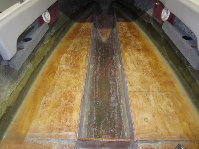

Continueing on... fillets were added with reinforments. Since a portion of this work will be visible on the interior I added an additional scrim layer to finish off the layup. I am really happy with the way this last layer finished things off.
The layup schedule is as follows:
Fillets with 1/4 chopped strands
2.5 inch wide 1700
7 inch wide 1700
10 inch wide lightweight fabric (can't remember the weight)
Pictures:
1) 1700 and scrim scraps in the infamous milk carton mix container
2) Close-up of the complete tabbing
3) Final result
I need to get some paint to finish off the bilge and ski locker area before finishing up the deck.

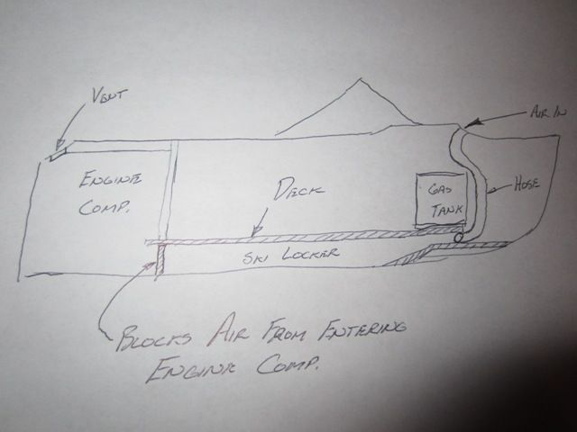

Could use some help on this one.
I am about ready to paint my ski locker and cover it up with the remainder of the deck but I am concerned about something. There are two hoses that attach to a front vent in the cap and run into the ski locker area - it would be just forced air from the boat moving forward. From the current configuration this does not make sense as there is nowhere for the air to go except up throught the ski locker door.
What makes more sense to me is that the air would ventillate throught the ski locker and into the engine compartment. I would have to cut a couple of ventillation holes in a partition that currently blocks the air from passing.
My question is what should I do? How is this particular system supposed to work. I believe the pictures from my previous post and the sketch below my help with what I am trying to describe.
Thanks in advance for you help.
100horse
Jan 20, 2012
Re: 1976 Century Arabian - Mercruiser 888 - Boat Restoration
I have enjoyed your build.
The venting as I see it is for moving any gas vapors out of the lowest part of the boat -I would be concerned on giving the "vapors " an additional path to get back to the engine compartment.

100horse, thank you for your thoughts and comments and welcome to our forum. I am honored to be your first post. What you have mentioned is my first concern, which leaves me with the question: what purpose does it serve. The air has nowhere to go unless I place gaps in my ski locker cover boards or some other way for the air to flow. The previous owner was a hacker so I do not really know the original configuration. Arabian Owners - Does anyone know the original configuration? I would like to just replicate it. The help would be appreciated. Thanks

Hi There Jones
Just came across your thread, your doing a great job here.
I think having vents in the ski locker is a great idea. You say there are 2 hoses bringing air in. I am not clear what the vents look like on your deck, but assuming they are some kind of cowl, perhaps you can turn one to face forward and one to face aft. Then when your running the vent facing aft is the exit for the air. That may have been the original intent as that's a fairly common way to vent a cabin.

Chris, thank you for your response. Attached below is a picture from my previous post. There is a grill on the front with the "Century" label that is slotted and has two cylindrical attachments behind (inboard)for the hoses to attach.

Ahh. In-only.
I expect you will have better venting of the ski locker if you open up a passage to the engine. And off hand, I cant see any drawback. A lot of bilges are "vented" from bow to stern to allow water to get out. (bulkheads are not tabbed at the very bottom)
On the other hand; unless the ski locker hatch has a gasket, having it blow up around the cracks probably keeps it vented well enough. Certainly better venting than none at all; which is what my Glastron has.

Chris, thank you for the feedback. At a minimum I believe I will place provisions in for a vent. Maybe two 2" holes in the single bulkhead between the engine compartment and ski locker. 2" PVC can go through the holes. I'll cap them if I don't like it. It seems a though ventilation configuration would also be required for an inboard. 4Winns, I appreciate the comments on the work. Believe me, it is nothing to be intimidated by, especially when you consider the date I started. One little step at a time (the one year hiatus didn't help). I think about the process during the week and try to be as efficient as possible in the few hours available on the weekend. Thanks for the link also. I have not yet seen this and I love the history. Purchasing the Century book is probably in the near future.... thanks guys.
