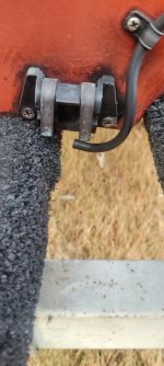

Take the screws out of what appears to be an old transducer mount.
If water come out , bad.
Drill hole slightly larger and describe / show us the wood that comes out.
Put appropriate sized larger screws back in. Use lots of 4200.

I think the hose back there is supposed to be the pitot tube for the Speedo. But it doesn't look like one.
redneck joe
Mar 18, 2009
15,989
Yeah prob right. Cut it. If cracked inside the boat then that could be a cause if rot issues . And could be pretty localized if that is what has happened.

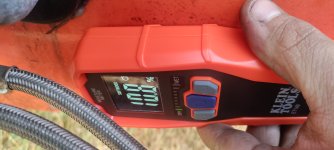

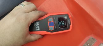

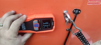

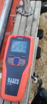

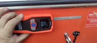

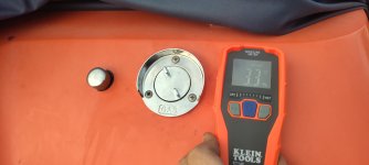

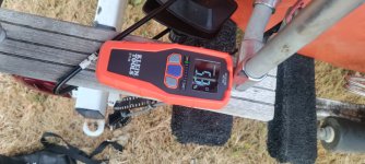

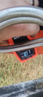

As promised, I obtained a moisture meter. Attached is what it says about the transom.
At the fuel filler (known to be very dry) I'm getting about 4.5%. This jumps up to 8% below the bumper, gradually increasing up to a peak of 11.5% at the bilge plug. Also of note is that both swim steps are around 5%
Yes it is technically wetter at the bottom... But not to the point of being "Wet"?
