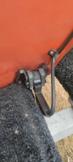

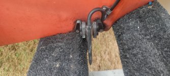

Pitot tube should stay on all the time, yours prob got snapped off where the tube attaches. Just put a speed app on your phone.
ratdude747
Sep 30, 2023
487
Next time I have the cover off I'll look. There was a weird black plastic piece in the glove box that looks like it'd fit there. Seems the bunk on the trailer interferes
ratdude747
Sep 30, 2023
487
Found it!
Sure enough, the bunk is interfering. Add it to the "why this trailer stinks" list. And to think it had a factory alloy low trailer, that was swapped at the dealer due to an issue of some sort...
Edit- got it on. Seems the actual issue is the hose is short. Should be fixable with some automotive vacuum line and union?

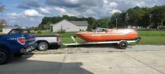

Just odd the boat is that far forward on the trailer.
Attached is a pic shot the day I drove it home which shows the full profile. Trailer too big for the boat?
(Side note: this was shot at my inlaws, who were on the way home... )

I am not an expert and am not there so for what its worth, yes.
I have a 96 ford and comparatively yours looks much more squatted. Too much is better than too little. There is a sticky thread in the trailer and towing forum.
Bunks typically end before or right at the transom so things like pitot tubes do not get broken off.
Your bow post cannot be moved back so either diff trailer than designed for or bunks replaced incorrectly.
I'm beginning to suspect your known history is not as accurate as you might think.
Drill into those pitot tubes and post up pics of the shavings.

Looked again and the trailer and the bunks are same length so not a bad bunk replacement job.
ratdude747
Sep 30, 2023
487
The trailer was a dealer swap. Trailer manufactured in 1975 (per the VIN decal), boat bought in 1976 or 1977 as a "last year's model" clearance item. Original trailer rode low and had mag/alloy wheels but for reasons unknown/forgotten to/by the friend and his dad, it didn't work out and was swapped for the current trailer not long after.
The trailer likely is too long... The back roller doesn't touch the keel and actually prevents full lowering of the outdrive. Not to mention the bow post is a rusty mess (Ice expansion damage, possibly a leftover from the marina incident) and the wiring is a joke (will be running new wire and proper submersible taillights). I don't like it, but it's what I have.

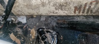

Found the rot... Deck board above the back of the ski locker is shot.
Found an old rodent next in there that was soaking wet. My boat cover failed and allowed some water to come in, been airing it out the last several days while the weather is ok.
Here's a chunk of fiberglass and rotten wood I popped off the bottom of the board:
That explains the soft spot and the rotten skis inside. Collecting condensation perhaps? Everything else in the area seems to be OK other than the carpet glue peeling a bit.
Given that everything else seems to be solid, I am electing to consider this a problem to solve down the road (after I have it running, perhaps this fall). I know that eventually the interior will need to at least partially come out and the deck repaired. For now, I've pulled as much wet loose junk out of there as I can in hopes that the rest will air out with the locker cover removed. May also put some damp rid in there to draw more of the wetness out.
I have ordered a new boat cover. This time I will be using a support pole instead of buckets and trash cans in an effort to stop the pooling condition that caused this issue in the first place.

Sorry to deliver vad news, but that small rot area is just a tip of the iceberg. They rot from the bottom up, so get under where you found that spot and you will find more !
Some of the wood may be enclosed in fiberglass and feel solid, but drill into that encapsulated wood and it won't be pretty. Remember that wood is the skeleton of your boat, when the skeleton rots, the fiberglass will give way and fold up or crack open. Good Luck !!

I'll try. Underneath that area is the ski locker. The side walls and back wall of the locker as far as I can feel are solid (no flex or sponginess). The back wall would be the most suspect area, but it's far enough under the floor that I'd need a very long bit to drill it (I don't have a bit that long that isn't way too big to not be destructive). I could try the locker floor though.
The ski locker should be encased in fiberglass over wood. If thick enough it will not flex and the rotted wood would be inside. That is why we say to drill. That said, if you do drill and there is no rot MUST fill the drill hole with 4200 or 5200 and NOT silicone.

Having no luck drilling it.
JB waterweld ok for filling holes? I have some and that was my plan.
Never mind. Pulled the carpet and the locker floor is soft and failed the test. Ugh. Guess this is a bigger project or a sunk cost ...
