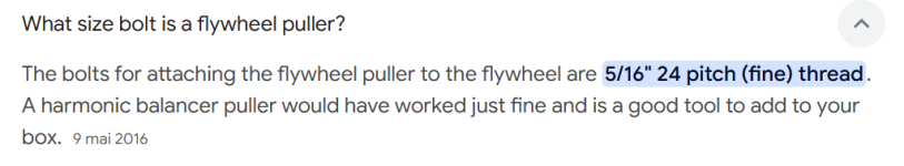

The above illustrated puller with inverted nylon nuts is probably the cheapest you will find. No.... it is not OEM stuff $$$ but works fine on small OBs . The inverted nuts will keep the depth of bolt insertion in the FW even and keep the bolts in place so you don't go loosing any.
Crosbyman
Nov 5, 2006
6,052
yes that is what I have but the bolts you have in the kit don't fit the FW holes on top . Buy what you need (3) at the HW store with 3 nylon lock-nuts and some flat washers to keep the bolt heads from slipping thru the trianle opennings . Bend the flat washer 90 deg. on one side to fit them close up to the main shaft
If I recall you need 10 size 24 tpi bolts. buy the stainless steel ones CHECK THE SIZE...in case my memory is faulty!
Crosbyman
Nov 5, 2006
6,052
"everything you read on Internet is true" ....Abraham Lincoln
wasn't 100 % certain which is why I said to CHECK THE SIZE...in case my memory is faulty! guess it was.
thanks for clarifying

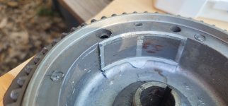

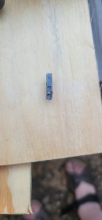

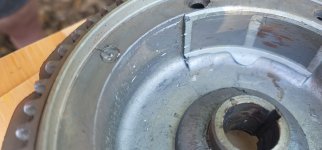

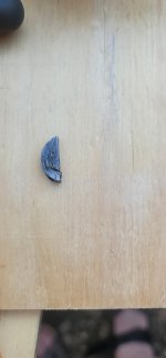

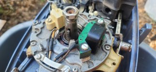

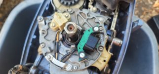

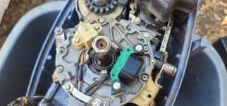

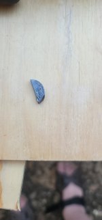

oookay.... so I got the flywheel off... pretty uneventfully... and I think I know what happened.
Inside the flywheel I found the key that inserts into the shaft was loose underneath the flywheel and wedged in between the flywheel itself and the magnet inside.
I also think I figured out how it got loose... the flywheel nut on top is super easy to loosen.
I'm going to upload pics in just a sec... I just need to figure out how to make this nut stay on... I suspect this is the reason it got borked to begin with.
Mc Tool
Aug 7, 2024
1,212
Maybe somebody has had the flywheel off recently . I have seen where when one is fitting the flywheel the key is picked up by the flywheel magnets , begs the question tho why the flywheel was removed in the 1st place. Stick it back together and see how it goes 🙂
