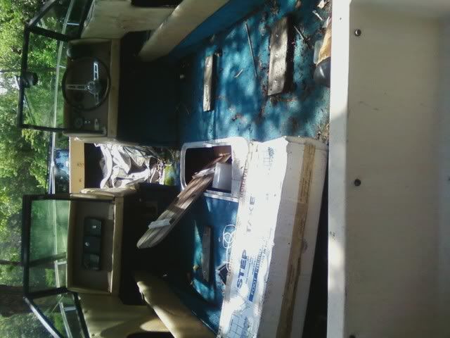

Re: 1977 Starcraft restore
boat%20restoration
This pic GLORIFIES the interior... I ripped up the carpet which was doomed and pulled out all the moldy paneling and dashboard and other gross stuff (leaves, bugs, a dead something) and powerwashed a the hull and interior.
zopperman
I got anxious and Hung the motor late last night :D I even did the controls and she fired right up and idled better than ever.
but now, what tool do I use to cut the floor fiberglass?

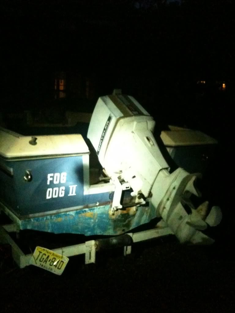

Woodonglass
Honorary Supreme Mariner
Dec 29, 2009
25,933
Welcome to the iBoats Dry Dock Zoop!!!
Looks like you've got quite a project there!!! Sorry to say, but there are NO quick fixes here on iBoats. We all believe in "Doin IT Right" and in your case you REALLY need to tear it ALL out. Your last picture makes me REAL nervous about the condition of your Transom the Disoloration is a good indication that it is in bad shape too. I think if you took a core sample of your foam you will find it is going to be saturated with water. You can do this by taking a piece of 1 1/2 inch pvc pipe, cutting some teeth in one end and " DRILLING" it down into the foam. Knock out the "Core Sample" and you'll be able to see what the bottom of the foam is holding. I'm pretty sure it won't be good. In the long run you will need to replace the stringers, Transom, Deck and Foam. Your total cost will be some where around $1,000 to $1,500 bucks and about 100 hrs of work. Is it worth it??? Only you can be the judge of that. Lot's of examples here on the forum. Do some searching on "WET FOAM" "STringer Replacement" "Transom Replacement" and you'll see what I'm Talking about.
Welcome Aboard!!!!

PS -- Are you talking about the green? I think that's algae stains... came right off with a pressure washer. Does algae indicate rot?
