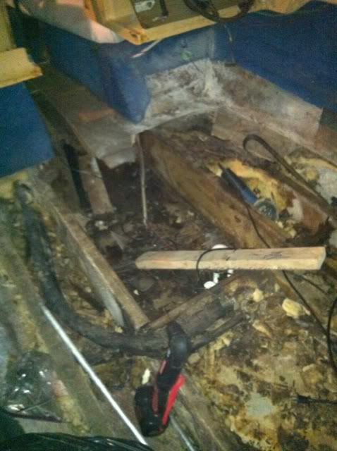

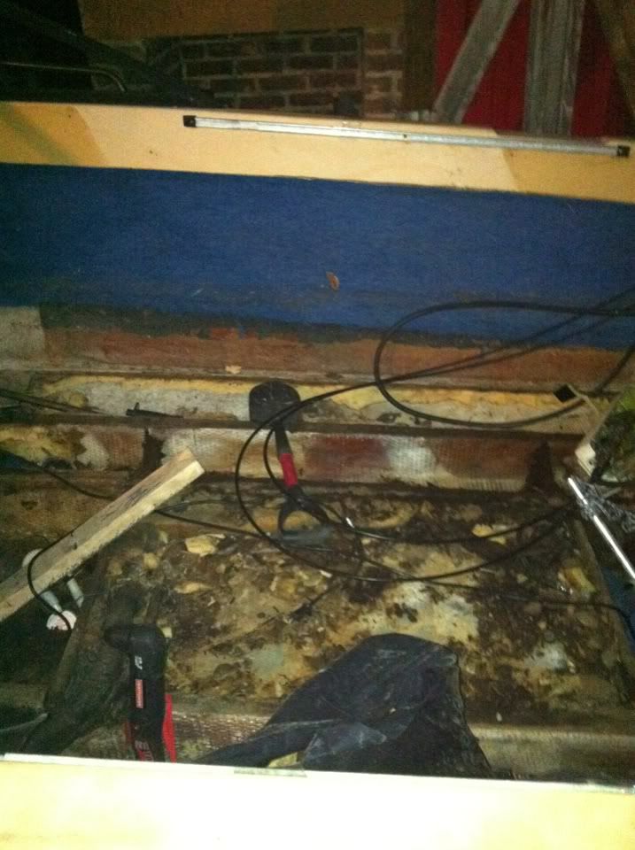

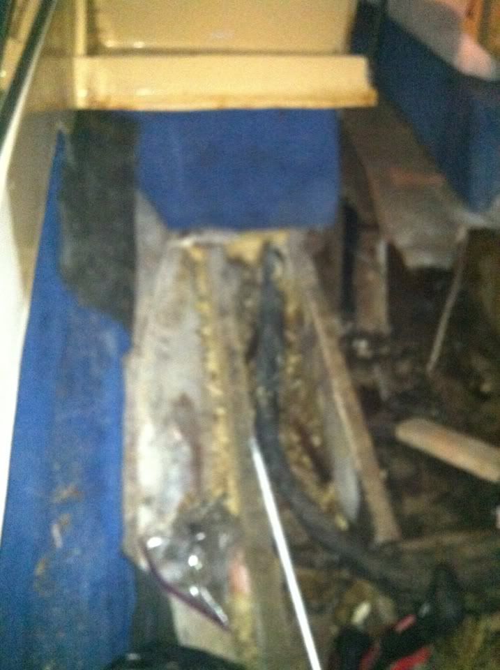

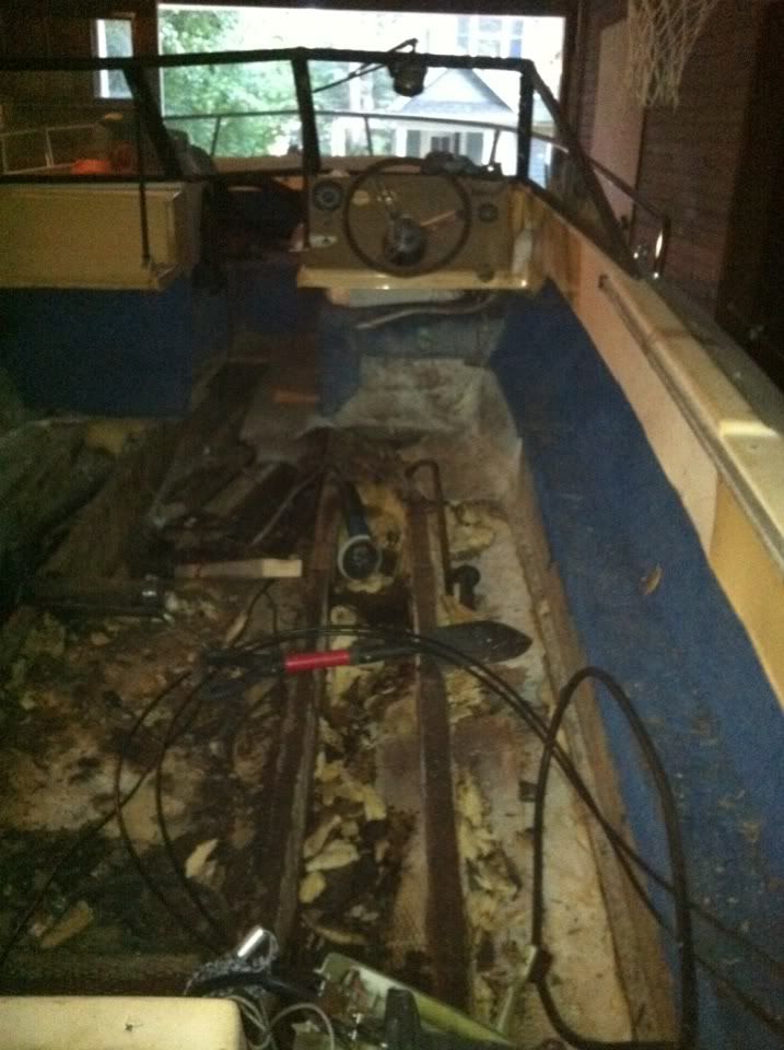

So I did some engine work today and fixed my ruptured fuel pump diaphragm and did some research and I'm thinking about using PVC boards for my floor... any thoughts? It's a bit messy, but here are the PICS to date!!
After a lot of cutting and grinding I got most of the floor and foam up. I need to shopvac everything. The stringers are staying -- they are OK!
Soon the CONstruction will take over the DEstruction!!
I can't wait to start customizing this boat and making it fun :D
Nope, Resin will NOT adhere to them and they are NOT structural enuf for a boat. DO NOT use them.
