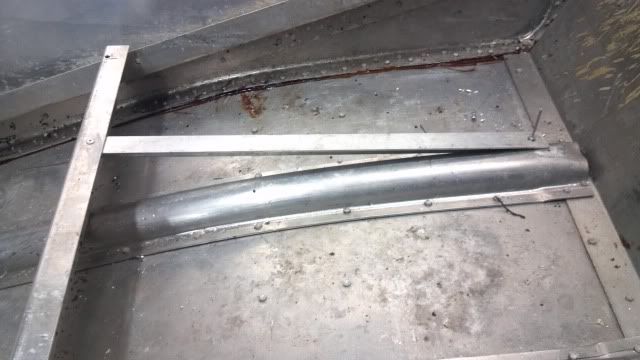

Today I got the SS back in the garage so it can dry out from all the rain we have been having (not going to complain as we need the moisture). I also started working on my underfloor support structure. I'm using 1" x 1" 1/8" thick aluminum angle for this. I got one cut out and riveted into place. It is super strong. I think I am going to install them on every other rib and see how well that stiffens it up. If I have time at work tonight I will get the rest cut out of the material I already have. I think I'm going to need about 10' more to complete it.

The cost of that alum angle sure adds up fast (that's why I used a smashed ladder:facepalm:) but the strength it gives is sweet!

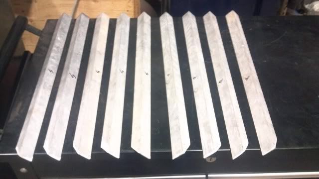

I got the rest of my supporrts cut out. I will need 6 more to complete it so about another 9' of angle should cover it. If I feel up to it when I get home I'll crack open a frosty and see if I can get a few put in.

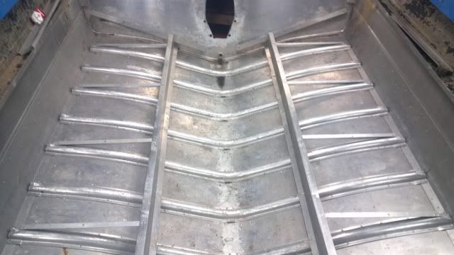

I got home last night and put some of the braces in. I got two that I need to trim up some to make fit. Other than those two I got al the ones I had cut in. It really strengthened up the stringers.

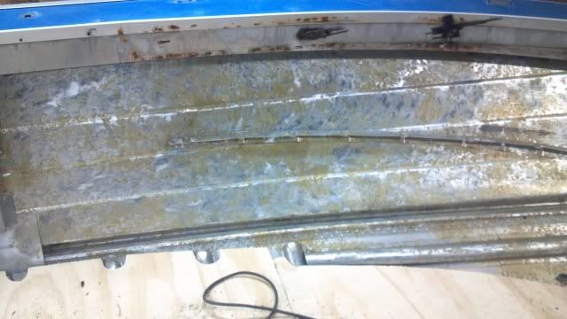

I also got a little bored and started on the carpet reminants/ glue removal. I was using a wire wheel on the angle grinder. It actually went pretty fast. I think I may go this route instead of spending $200+ to have it blasted.
Before.
After about 5 minutes.

Lookin' good BN --- no doubt that will really add a good amount of support to the floor and to the rigidity of the 2 stringers.

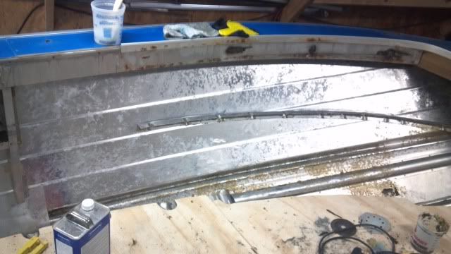

This morning I applied some paint stripper on the glue in the area I wired wheeled off the carpet remanants. I applied it, let it sit about 15 minutes and scraped it off with a plastic scraper. It worked really good. I think I can have the whole inside done this way in about 4 hours.
From what I can see, they put the carpet in before they put the cap on at the factory. There is alot of stuff I can't reach. I drilled out the rivets and have the cap ready to lift off. I know this is complete overkill but I know it will bother me having those carpet remnants under there even though I wont be able to see them. I can be a little OCD when it comes to my projects. It only took about 5 minutes to drill out the rivets so not a big deal there.
