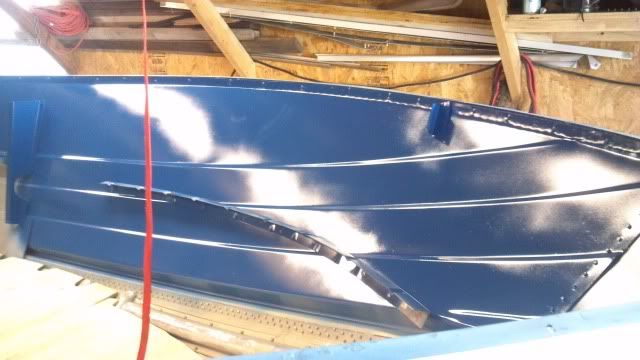

Today I got the inside painted. I'm not real happy with how it turned out. The gun wasn't spraying very well. I think I will scuff it and spray another coat with one of my better guns. I had to paint outside so I got lots of dust and bugs in it. Overall it looks ok but it does have a little orange peel.
boatnut74
Aug 29, 2010
1,835
Re: 1977 Starcraft Supersport
Since I had some trouble spraying the paint yesterday I thought I would post up how I did it to maybe get some pointers.
I used rustoleum thinned 20% and shot it with a 1.4 tip. I was a little breezy so I kind of battled that. It really didn't want to lay down smooth s I'm wondering if it needed thinned more. There were also some spots I didn't get very good coverage so I probably should have put it on a little thicker to help with that. I also had a ton of dust land in the paint so I might shoot the next coat in the garage.
I'm going to scuff it back up and shoot another coat. I think I will use one of my other guns and might try the 1.7 tip. Any advice would be appreciated.

Ya the last time i sprayed (about 8 years ago) it turned out really nice but I was using one of my better guns. Ill scuff and re shoot this week and see what happens.

I sanded the paint down and sprayed another coat today. It turned out a little better but still has some orange peel and i have a few runs now. Ill sand it smooth again and spray one more coat and call it good.

On the inside? How much of it will be exposed & visible?
Pix when you get it where you want it.
Hope your doing better.
Its all on the inside. Not very much of it will be visible. Im getting ready to go out and wetsand and buff and see how it turns out.
boatnut74
Aug 29, 2010
1,835
I wetsanded and buffed a small spot and it turned out alot better. Ill try to get a good pic.

DANG man.. You are wetsanding the inside of the bow and then buffing it? You are a friggin animal for sure... BOO YEAH!

I just want it to look nice. Im a little ocd. I figure if im going to put all this time into it I might as well make it look nice.

most of us want em to look nice, we just confine our concern in that regard to places people can see.......;)

Some of this will be pretty visable. Ill focus most of my attention to these areas.
