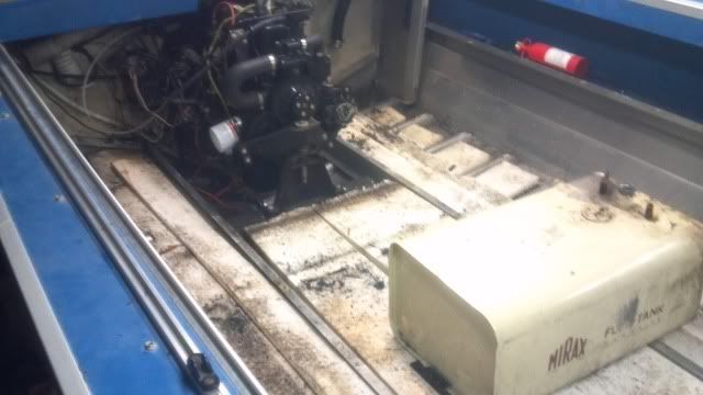

Here is a few pics.
The boy helping me out this mornig
Side panels and half the deck out.

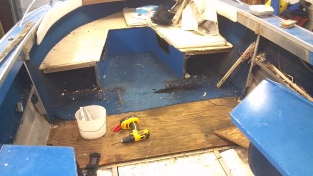

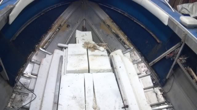

Alrighty, progress pics from this morning.
Crawled into the boat and found a surprise from the kiddos. They left a bunch of their beanie babies up on the console. Those kids are awesome :D
Both consoles out.
Front seating area and the rest of the deck out.
This week I have a bunch I want to get done. The consoles and fuel tank are still sitting in the boat so I want to get those pulled out and put away. I also need to vac up all the styro pieces and wash out the hull.
