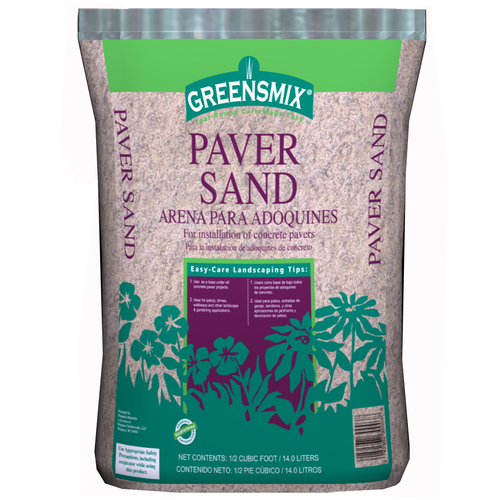

Not sure if you have Lowe's but if you do this is the sand I used on my, should I say it, "Glasser" and it worked great.
Put down a coat a paint, sprinkled it on, let it dry, broomed it off, shot another coat of paint, Done. Feels good on the feet. Not too rough.
But then again, I am a "Glasser":redface:

Thanks WNG, if the play sand doesn't come out then maybe I'll grab a bag of the rougher stuff like that or less fine however you feel like putting it. That is the more coarse stuff right?

Do NOT use that aluminum rusto color. That stuff is HEINOUS. Had a guy on here do the whole inside of his boat with it. Looked horrible. Stick with grays.
"Play sand" nowadays is that brownish silica-free stuff that's safe for kids. I don't think you want this. Crap I got for my sons sandbox is ugly and has little rocks in it.

The sand I got was the stuff sitting next to the concrete mix at the lumber yard. Fine and clean, good stuff.

Also got some more coarse sand, made to mix with cement. I think this stuff will work much better! I'm going to sand my seams and lay down another coat of epoxy with the sand on top. Also if I can get my consoles painted and everything. I know it isn't good to paint in the rain but I need to get it done.
