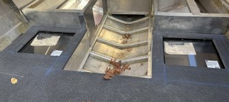

After I installed the floatation foam around the port-a-potty I installed it down the port & starboard sides. I left the aft for later because I still have work back there. I'm using Total Boat's 2-Gallon kits. Each kit is supposed to float 300lbs and so far, with more to go yet, I've used 1.75 kits. In addition to the kits, I stuffed some of the purple insulation board that everybody uses for flotation where I didn't want to pour in the foam, and I've been hacking up chunks of the original boat flotation Styrofoam and using it with the expanding foam, because both, I think it's cool to reuse it, and it saves on cost to do so.
As I've been explaining in prior posts, last year, I installed sheet vinyl that bridges the ribs of the boat creating a cavity under the foam. The open cavity allows any water that gets into the boat to flow freely down to the bilge, and to the bilge pump. This helps the issue of water being trapped between the hull and the foam. I used "Buck" brand HVAC Tape to install the sheet vinyl, and I have to say, I am very impressed with it. It's quickly becoming my best friend on this build. It seems like that tape comes in handy a lot. It will stick to anything, and it doesn't let go. It sticks through the extremes of winter and summer. I use the tape to fasten down the sheet vinyl and manage the foam, keep it from spilling into areas I don't want it.
With the fuel tank being in the adjacent compartment to the compartments, I installed the foam, I was worried foam would creep into it, which usually happens a little. Nothing. None at all. I squeezed my face to the bottom of the bilge to look and saw daylight down through the entire fuel tank compartment.
You can see in the pictures, I poured the foam right onto my natural ventilation hoses. This will protect and secure them.
