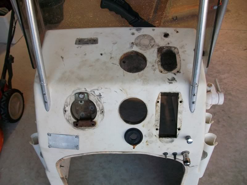

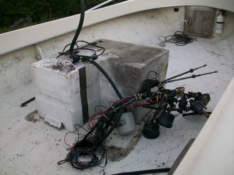

Well, this was a productive weekend, but was cut short in thanks to hurricane Isaac... Looks like we are going to get a bunch of rain this week so I had to prep the house...
So I had a good friend of mine come over and help me with getting the console off of the boat. Proved priceless after the hours of fighting rusted nuts and bolts and sorting through rotted wiring. Anyways, I will post some pics here after this post. There were a few pics I were able to get of the inside of the hull. Had to stick the camera down in that obnoxious hole of the middle of the console. You can tell how rotted the floor is. The picture is from the middle of the boat facing the bow underneath. To my amazement, it seemed as there is only a bit of foam.. kind of curious if this was a degradation issue or just how it was applied initially.
I wasn't able to get the motor off just yet, as the engine hoist was 70$ for the day... Plus it will be some extra weight to anchor the boat down during this hurricane... :)
