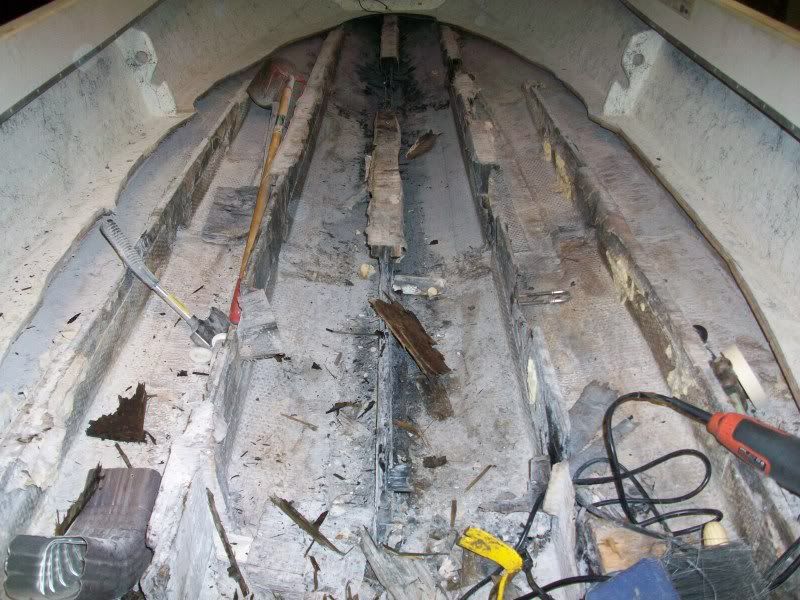

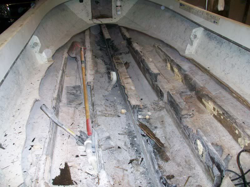

Well... got a lot accomplished this weekend. Got the floor out and removed all of the foam... had no idea how time consuming that would be! Anyways, a lot of it was soaked... and I got a clear look at what was left of the stringers. Seems as though there were only a few spots not completely rotten. The sturdiest thing was the glass. I'm not even sure how we weren't crashing through the deck this season! Anyways, my priority now is the transom. Spent hours today with a crowbar and hammer trying to separate the wood from the skin. Had to completely remove the inner layer. I wanted to try and salvage as much as possible to make a template later, but this thing was ridiculous. So at this point in time, I am going to be forced to make a new template for the transom. Going to do some more research and see what other folks have done in this situation.
Will post some pics tomorrow.

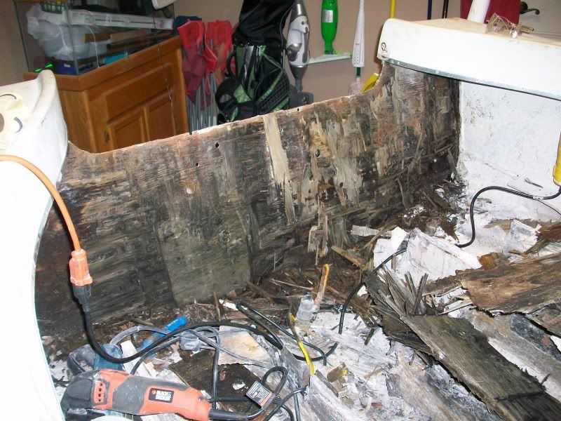

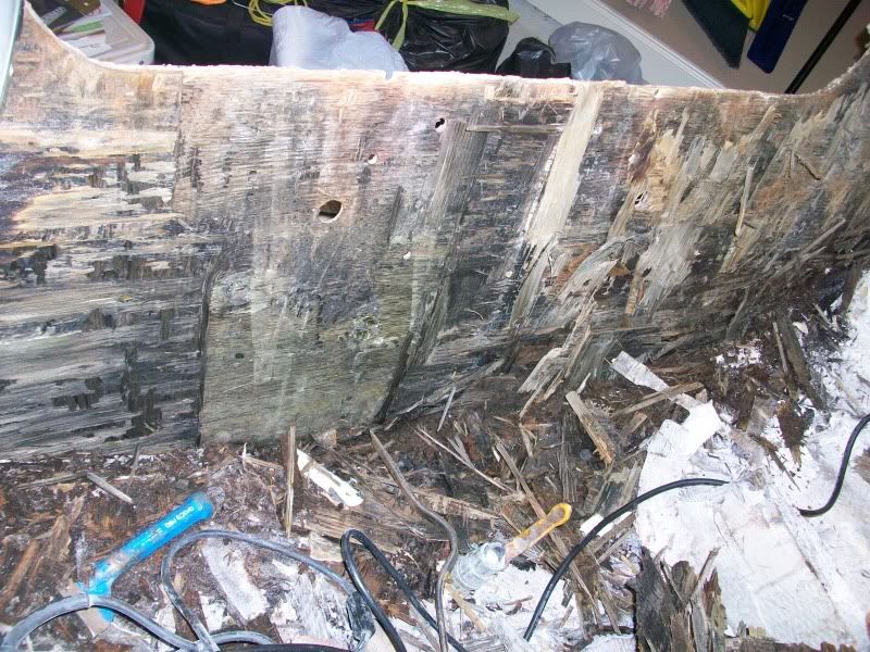

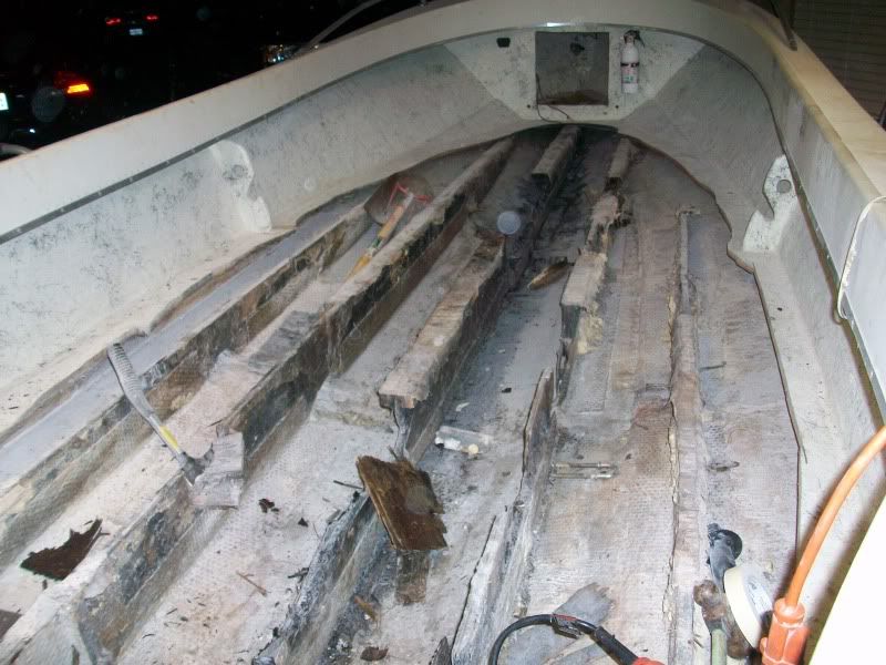

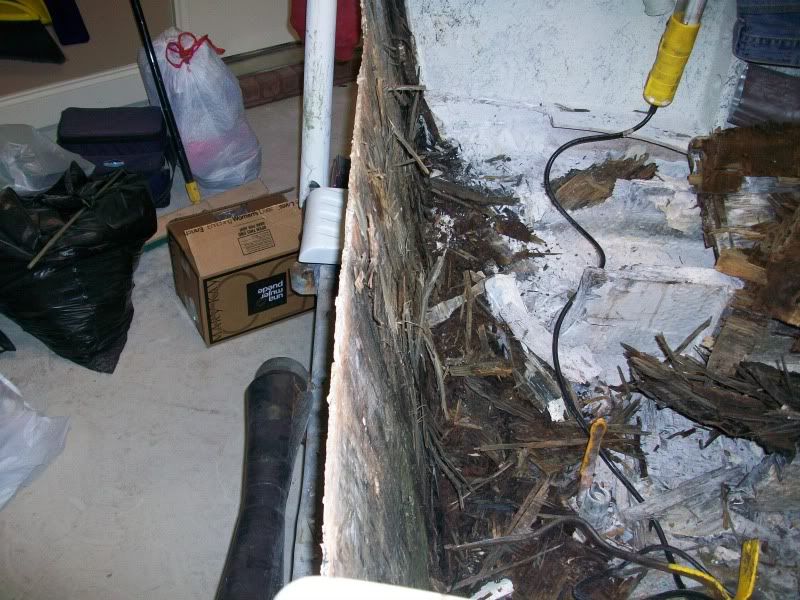

Absolutely nothing accomplished today. Had a get-together for a friend of mine about to deploy. Wanted to spend some time with him and his family before he leaves. Anyways, here are some pictures of what I did get done this weekend. You can see now a better picture of the rot in the stringers since the foam has been removed.
This is a picture of the transom after I removed the majority of old wood. You can see at the bottom how wet it was, even though here it is covered with the dust from grinding the fiberglass and gelcoat on the sides. I hope to get a new transom template created this week and hopefully a new template cut out. We are leaving to go on a cruise to the bahamas this Friday and I won't be able to work on it for at least a week after that.
So... You can see the work I have to deal with in the upcoming weeks. Still motivated, and at this point the only thing I am anxious about is the transom itself.

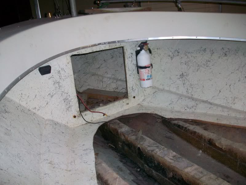

So ... I have this section of the bow which is kind of a pain to store things in and I would like to rebuild it differently to where access is a little easier. Maybe even build out a little seat which someone could sit on or something. I kind of feel that a lift-up seat would be a little easier anyways. If any of you have any better ideas about how to rebuild this portion of the boat or if I should just leave it as-is, I would love the ideas. There is a teak swing-open door that goes in the opening, only I removed it because the latch was broken and the door would not stay closed.

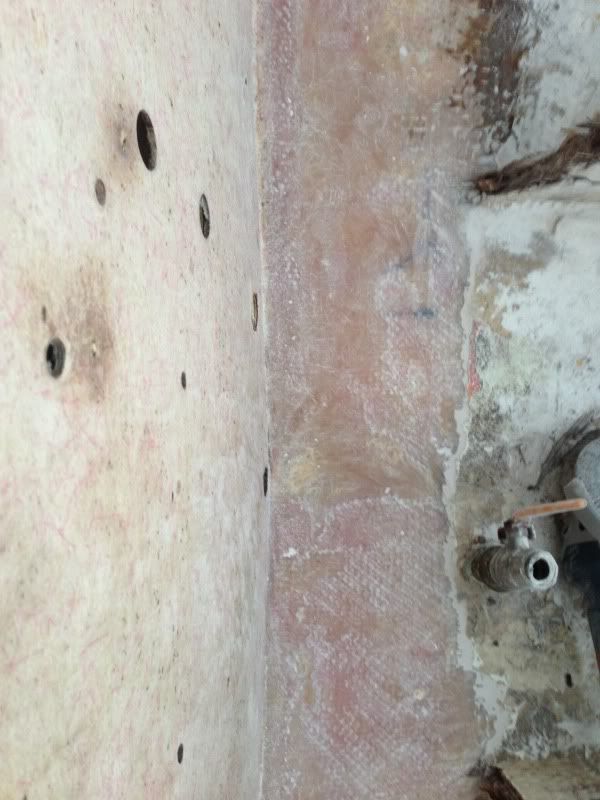

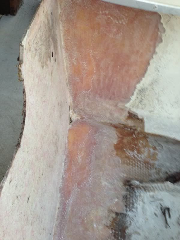

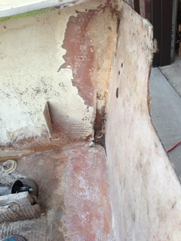

Alright. Today was another productive day. Haven't had that much time as of late, as my wife and I went on a cruise this past week. Was able to grind down the transom with the exception of the sides and bottom corners. Those are tricky to get to.
I want to make sure that I am grinding down far enough to good glass, but I'm not exactly sure what I am looking for in-particular. I have gotten down far enough to what looks like the old woven from the factory layup. Is that far enough or should I grind deeper towards the hull itself? Below are a few pictures of what I am seeing.
Here is the port side
Center looking down
and starboard

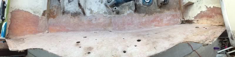

And here is a cool pic I took with my new iPhone 5... (Don't make fun) It is a panoramic photo from port to starboard. Kinda cool if you ask me, although the middle is kind of skewed since it was closer to the camera.
Tomorrow I will continue with the grinding of the corners and try to get a template made for the transom. Will be going over WoG's thread for the transom install tips and tricks again.

Looks like excellent work Gator...getting down to good glass basically means removing anything covering the glass, like bilge paint, gel-coat, etc, or any loose, flaking glass...and opening up the surface pores of the old glass, so that the new glass/resin can make a good mechanical bond...similar to prepping a painted surface for refinishing...just a lot itchier...:redface:
To get right down into the corners, I used a Dremel tool with either a diamond shaped burr or a round one...a little slow going, but gives you really good control and let's you get all the way in there...
You could also use a regular drill with a similar bit, but it can be a bit awkward to handle...
Keep up the great progress.

Well I did some more grinding yesterday and made sure all the flakes were gone, good glass shows, etc. and now I am just trying to clean out the boat so I can be ready for glassing in the transom when the time comes.
GT, I tried the oscillating tool with a spade shaped sandpaper attachment on the tip, didn't work to well even with 80-grit paper. I went to the hammer and screwdriver to get the majority of it done and back to the grinder when I could. I can tell you now that I am so tired of suiting up each time I go to grind... but down here in FL, the temperature is finally dropping so it wont be as bad anymore I hope.

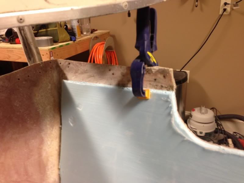

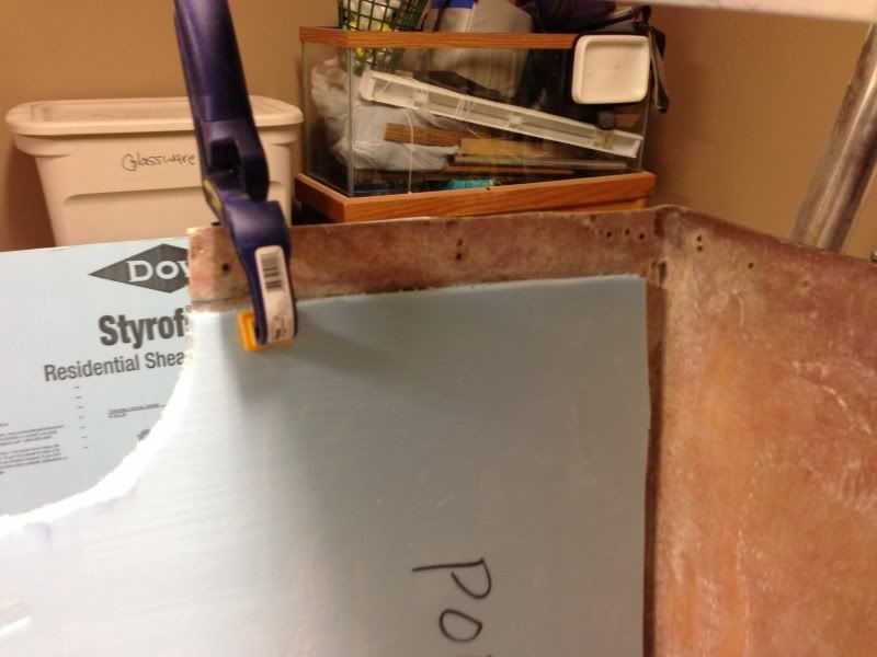

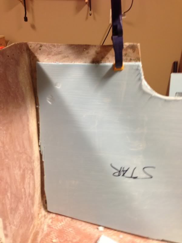

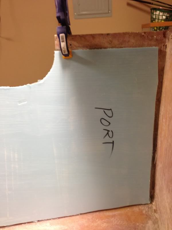

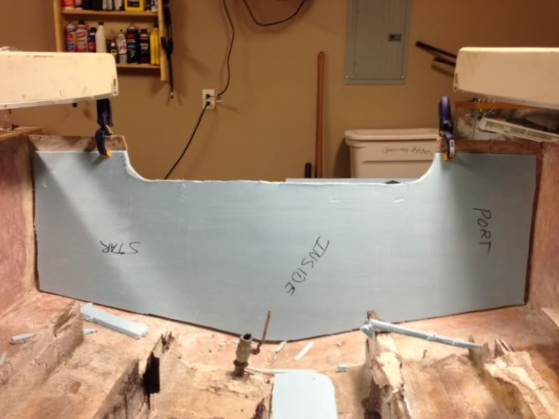

Well I definitely appreciate the advice. I cut out the template today and left a few inches above on both sides for what you are talking about GT. When I removed the cap, there was no wood there, only screws from the cap to the outer skin to secure both of them. What you are talking about sounds like a much more secure option. Only, it was like that throughout the entire cap, not just the transom. It was fiberglass on fiberglass screwed/bolted together. I could tell it had been off before with the sloppy work that was done piecing it back together. I have bought extra latex gloves, and my wife is a nurse, so she brings me some home when she gets the chance. And I picked up a jug of acetone today with the other fiberglass supplies; biax, CSM, poly, fumed silica, and milled fibers... so as of now I think I will be good to go when the time comes to tab in the transom.
I have decided to use titebond 3 woodglue to glue the transom pieces together. I've read some good reviews on it and it will save a little money. Not trying to cut corners, just trying to stay in budget. I am going to experiment with making PB though... I've never done it and I want to make sure that I get it all right when I put in the new wood.
Anyways, here are a few pictures I took for the experts to review and give some feedback. I am finally starting to have a little confidence in my abilities here... just haven't gotten to the down and dirty of glassing and all... still have the stringers and the deck to go.
