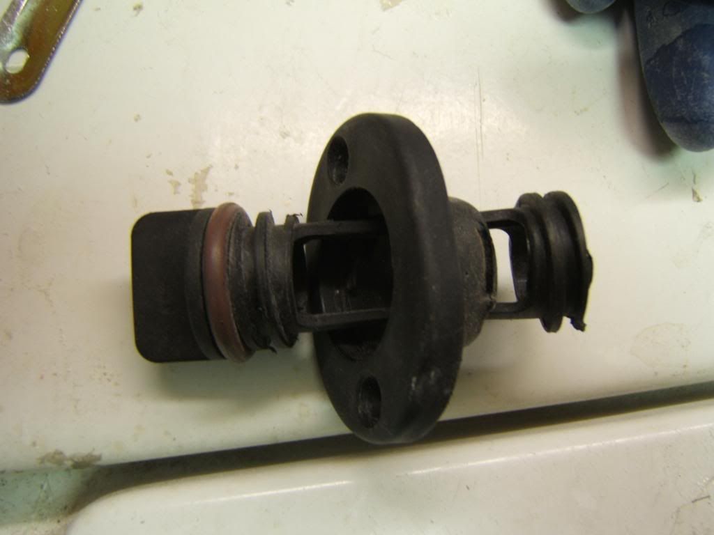

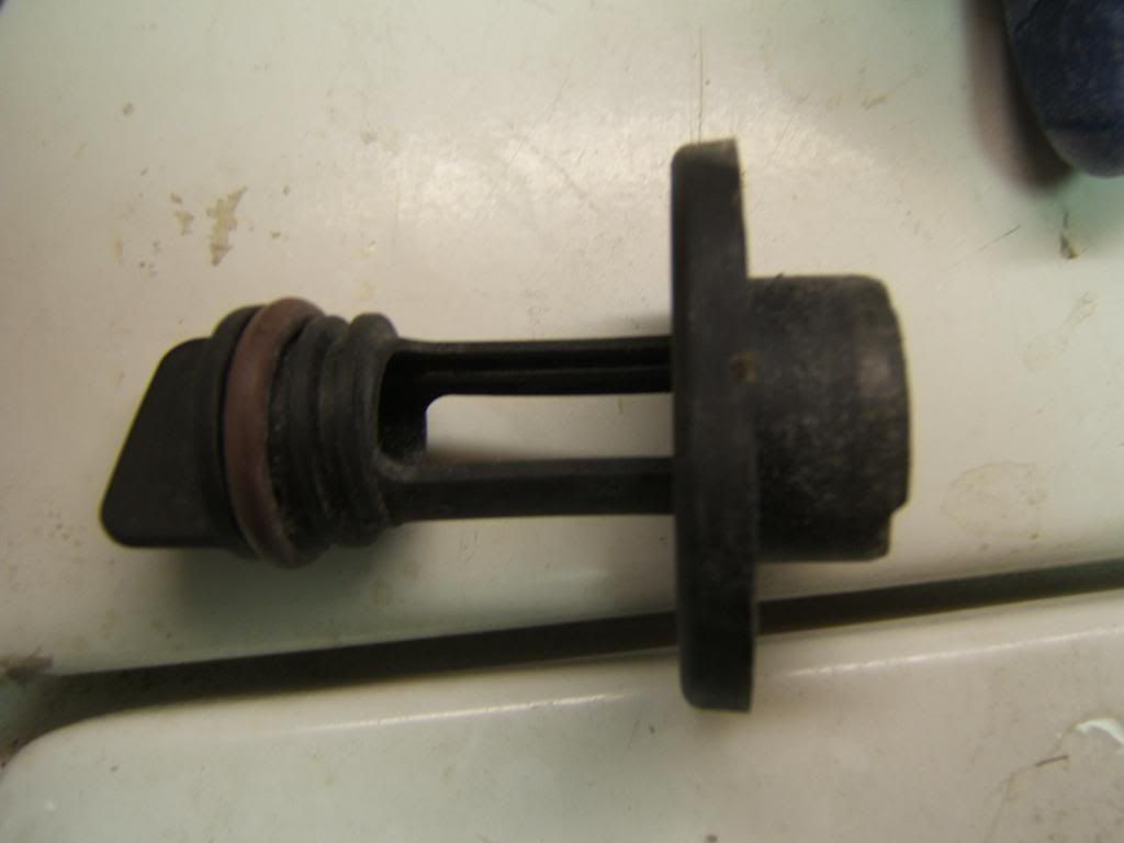

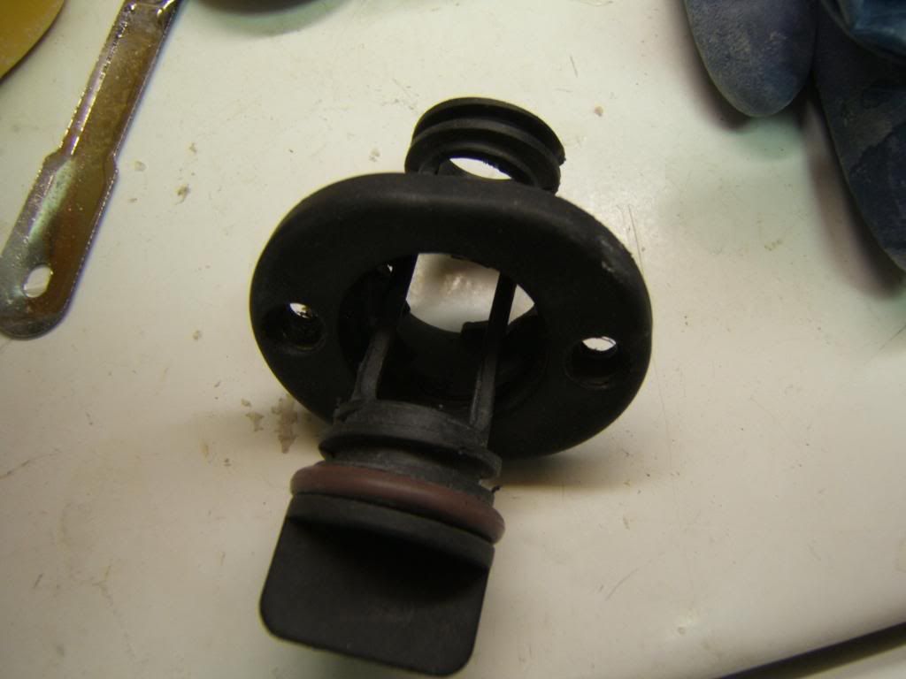

Those snap rubber seals can be threaded into themselves to make a tighter fit, kind of like a rubber expansion plug...But...
I found a plastic screw in drain for my bilge at BassPro...it is designed so that you can unscrew it to open it, yet the actual plug stays in place...here's a couple of pics of mine
Another tip I got from 'woodonglass' is to drill the drain hole oversize, say you have a 1" drain plug...drill the drain approximately 1-3/4" to 2" with a hole saw...fill that with PB, then redrill it for the drain plug...coat it with resin inside to seal it up, that way there is no way water could ever seep into the wood...check back on my thread for some pics...
