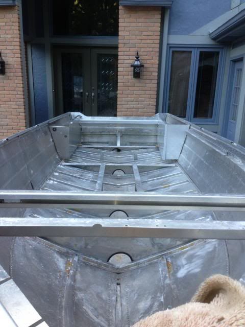

Did some dry fitting for covers to boxes.
Then started thinking that locker on port side sure takes up a lot of semi-usefull/less room. Hmmm. If I take it out sure opens up midship.
I think it is toast.

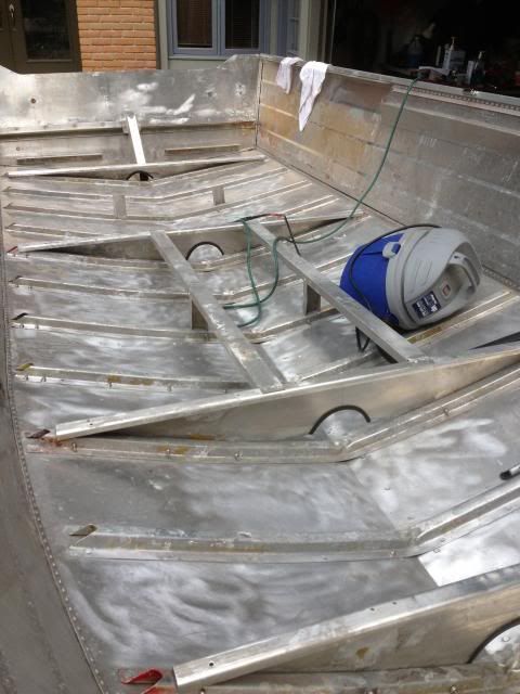

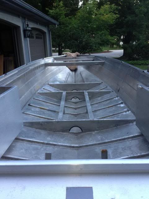

Did some clean up of hull and needed to hustle as morning sun would be coming over roof soon.
Just barely made it and that is no fun jumping around inside hull.
I dont know if this pic shows it well, but the sun was intense, over 90 today. Thinkin H2o sent their heat back east eh.

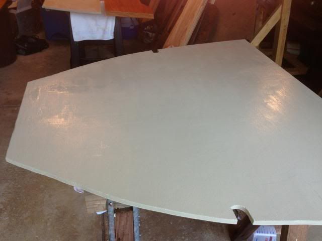

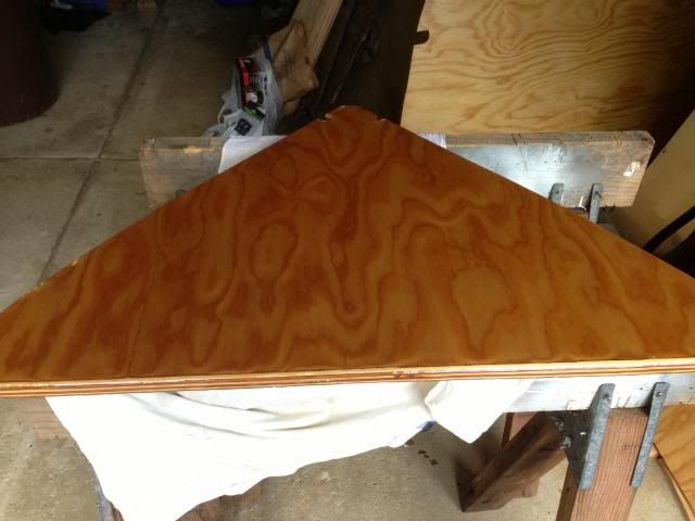

Busy day,
Got another coat of varnish on:
Also did some painting on deck. Got an interlux no skid compound and it says can pour in can of paint or can apply manually. If by hand they suggest a flour sifter...................what ? So I open small can and yup, it is about as fine as flour, so no brainer, dump it in paint, stir, let it sit to soak up paint and we are off.
I will say it is good product, didnt have to continually stir, went on easy and I am happy with outcome. Probably wont show in pic.
Got four deck pieces done and garage smells like a paint varnish shop.
A good day was had by all.

Fantastic job so far SG! Next pics will tell the tale as the wood all goes inside and she starts taking shape.

Man, that hull cleaned up nicely!!! Boards look great, and, yes, I would ditch the port side locker...
Great job!!!

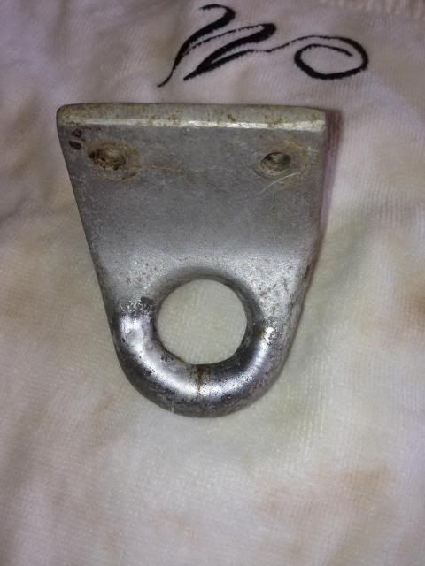

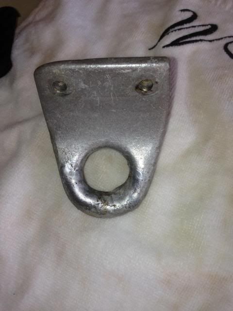

So if you recollect that previously the bow eye and the trailer winch strap hook werent happy, meaning didnt fit so the PO imo filed down the inside of the eye to make it fit...so the spring latch would close.
I took it (eye) into the shop and asked my ole bud, the weld supv. if he would ask a tig welder to see if he could fill it in a bit.
Unbelievable job. These 2 pics are with no clean up with files, grinding or sanding. Welding is an art form imo.

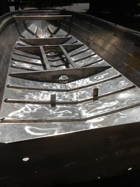

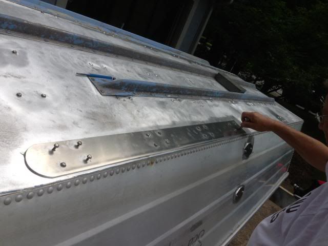

And then previously the weather provided an unplanned leak test. I wanted to do the full blown so filled her up. I really like this Gflex stuff so proof will be in the test eh.
So watched my new tire go half flat and was thinking pbly enough H2o. Didnt get water level that high but a good test.
Crawled under das boot and tried to mark the first leak with a marker but hull was too damp and wouldnt work. Crawled out, got a pencil and layed there looking at a rainstorm.
WTH, this thing is a sieve. Just about this point I am thinking OK, cut her up for scrap!
Well, some deep breathing, got me to the point of looking at big picture and it was so hot, so humid that good old condensation had made the whole bottom of hull full of condensation that was running in streaks every where.......
No pics.
I will pull her off trailer and gflex the 2 spots I know of and retest. Mostly because I want to see if this stuff works that well. I'd rather keep the water out than try and stop it after it got past seams and rivit head eh.

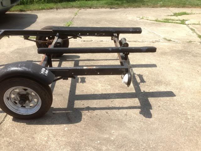

OK, winding down a bit. Previously, H2o mentioned that since my trailer bunks stuck out so far from back of trailer that if I move winch post back it would ease launch and recovery.
He was very observant and I knew somewhere along the line would have to address it.
So I'm sitting in my chair after good day of work enjoying a Molson...looking at upcoming jobs...bunks and this doesnt look right !
H2o was absolutely correct but what I didnt realize was the PO had re-installed them backwards.:facepalm::confused:
So just go with the flow and turn em around but of course they are rusted up pretty well so just a few more SS bolts and will be good to go.
Geez oh man.

trailer setup will be significantly improved with the bunk switch-er-oo! good eye h2o!
