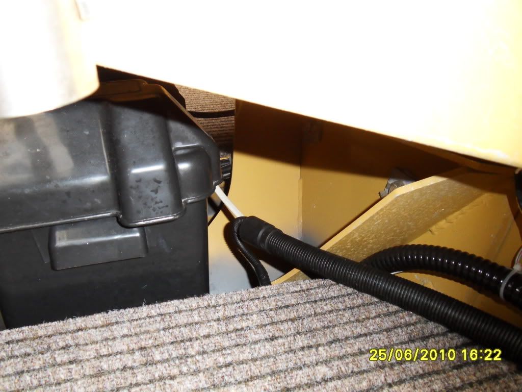

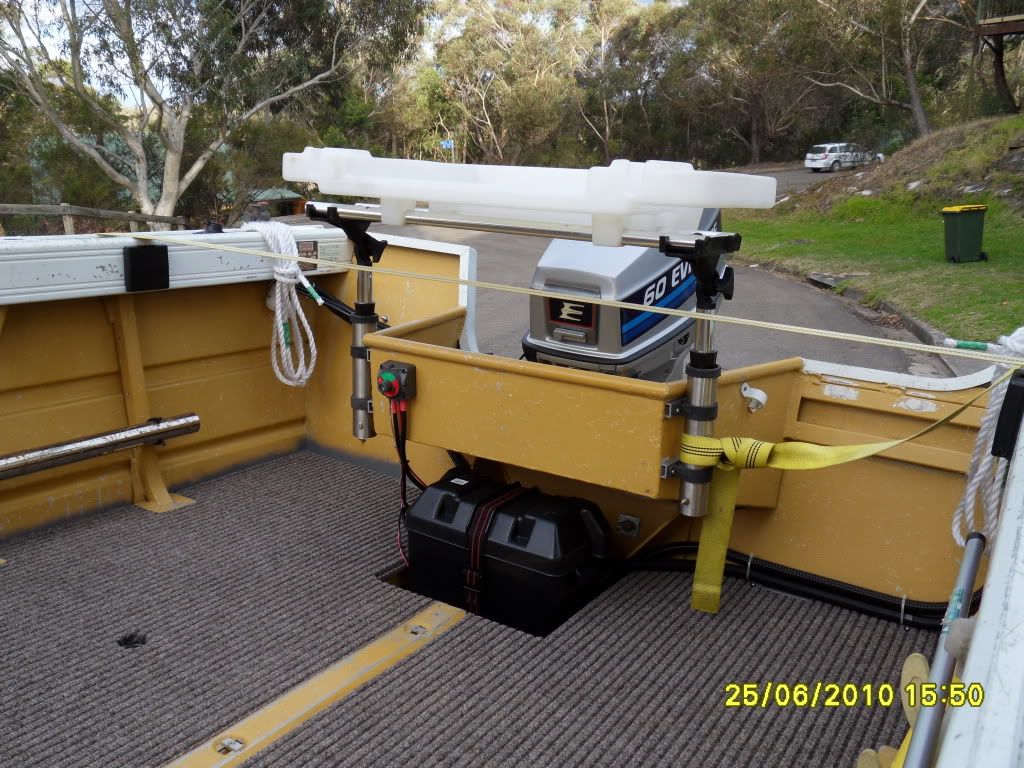

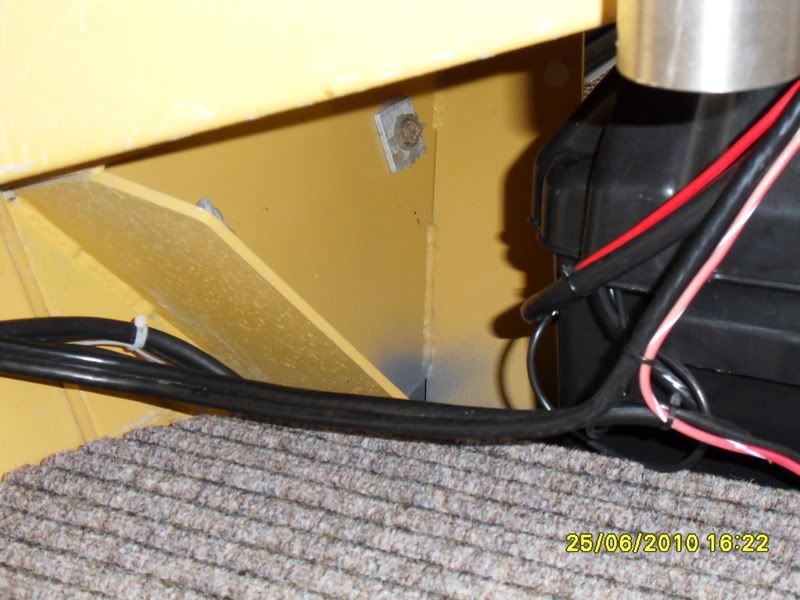

Is it possible to not have a wood transom?
The pics of mine.....a wood free zone apart from the motor transom pads......the hull is 30 years old next year.....

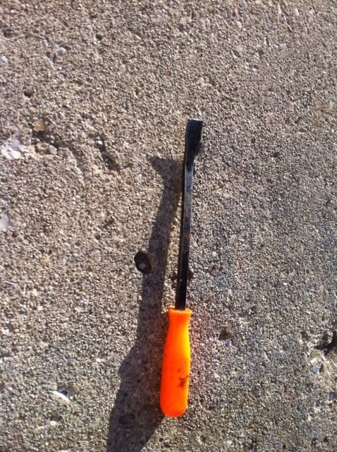

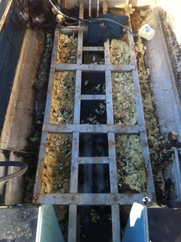

Got to take out some of the foam today. I took out three trashbags full of foam and you can barley even tell! This has to the worst part of a aluminum boat rebuild. I found a flat head screw driver that is angled like a pry bar that worked really well on geting foam out.

jpormen, just keep plugging away, I took seven 55 gallon drum sized bags of foam and crumbled plywood out of my Sea Nymph last Sunday and today. A big shop vac is really handy for the smaller sized chunks. I used a similar sized prybarr to what you have there, but cut the sections with a sawzall blade and tried to get it out in bigger chunks. Be carefull if you use the sawzall and don't punch through or cut anything you don't want cut. ;) Get a kitchen sized garbage can up in the boat with you and dump it into the bigger can.

A simple handsaw works great on the foam. Cut along the edges of the stringers and then pry out. You can also use a spade. Sorry I'm a little late with that. Good luck. Looks like you got a "good" free project.
