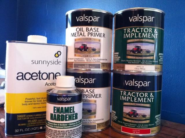

My uncle is beating around the bush, and bull****ting alot so im just going to go the tractor supply route and roll paint it my self.
I know i want to paint it white with a Red or blue stripe.
Would anyone care to make me a list of item numbers from tractor supply website. I tried to make a list but i feel like im not choosing the right stuff or leaving stuff out.

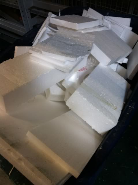

Also regarding foam, i work at walmart as many of you know and we have a recycling section and one of them is always full of random and different size Styrofoam pieces would this stuff work as floatation for the boat? As long as i ask im sure they wouldnt care if i take some haha its always overflowing

As far as how much paint ill need, its a 16 footer, primer, white, blue/red. Would a qt of each be enough? should i get a gallon of each instead? 2 qrts instead?

The white styrofoam is not ideal because it will eventually absorb water with repeated or prolonged exposure. However, manufacturers installed it as original equipment in the 70's and 80's so it's not like it's completely inappropriate. The pink or blue extruded polystyrene sheets from Lowes/Home Depot are better but go with what your budget allows.
For paint, definitely not a gallon. Prolly 2 quarts of each tops. It'll prolly be more like 1 of one and 2 of the other.

Thank you! i will Look into the polystrene sheets, i just thought i would ask about that white styrofoam since i can get plenty of it for free.
Also on woods paint build thread, everything he used i can get a tractor supply, except im having troubles finding the etching primer.

I found Duplicolor's etching primer in rattle cans at Pep Boys reasonably priced. You just need a light dusting of the stuff.
jpormen
May 24, 2011
172
Re: 1982 AMF crestliner got it for free
Will that work with that valspar paint?
ezmobee
Mar 26, 2007
23,767
I think etching primer will work with anything.

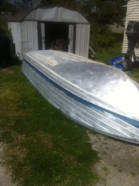

alright guys i got the boat 90 perfect ready for paint. I got paint bought.
Theres a stripe decal that goes all the way around that boat and its becoming damn near impossible to get it off, can i paint over that?

Also ill be doin the valspar roll method, how long does it take to dry? do i need to add the hardner to the primer too? any advice?

Search zinc chromate (ZC) self etching primer & aluminum. It is widely available in many places, I suspect it was available at TS when you bought the rest of the paint. I am fairly sure it is available in rattle cans, quarts & gallons, some vendors may only carry 1 or 2 of those choices. That may not be enough acetone, esp if you are mixing it into the paint before you apply it. But that may have been only if you were spraying the hull, not the roll & tip or roll & roll method. I don't know about the hardener in the primer.
If you really, really like sanding, prepping & painting the areas of exposed aluminum on the hull & cap regularly and often, the ZC is optional..... So no, its not optional.....
Just because the stripe is difficult to remove, doesn't necessarily mean it is safe to paint over it. Have you tried a hi-heat hairdrier, or better yet a decent heat gun, to soften it and use a good scraper to remove it. Have you tried some of the the commercially available adhesive, sticker etc removers? There is alot of work leading up to getting the boat painted, it'd be a real shame to have that stripe telegraph thru the paint & or have it peel or curl once painted.
Unfortunately there are few short cuts in paint prep, not so different then the foam that you asked about burning out. Sometimes thinking outside the box is great, other times you just end up outside......
It's been a journey, keep after it & you will be extremely pleased with the end results. With no: would-a, could-a, should-a's.
You have an incredible hull that you got for free, make it an incredible looking paint job & put back. It's worth it!

That i will prolly test out both methods while im primering im also going to do the bottom first, so if the bottom turns out not so perfect i wont be to mad.
Also Im trying to get it mostly bare aluminum but if there is a little paint here and there will that hurt it at all?

not if it's smooth & feathered at the edges
the ZC only needs to be on the bare aluminum. you might want to read about prepping aluminum in advance of the ZC
