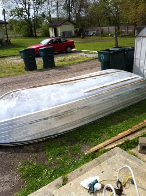

Couple questions hoping for a fast response.

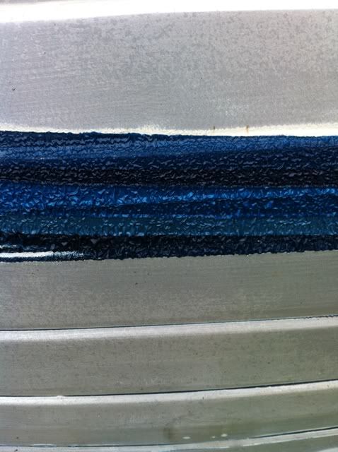

I found etching primier and bought some, got the stripe off the boat just need to do a little more sanding.
Im hoping to put down the etching primer tomorrow or wednesday depending on the weather, read somewhere i need to do an acid was before? what is this and what do i need.
Also theres a float switch on sale for really cheap at work ill attach a pic, will i need one of this and if so what does it do?! I used some stripping agent and got the stripe off it worked like a charm ill attach a pic!

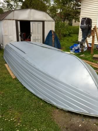

Im about to do the last bit of sandign then wash and then its time for SE primer and maybe a coat of metal primer.
Wash with the acid mix, wash with soapy water then rinse and let dry then wipe down wtih acetone and apply SE correct?
Do i need to add anythign to the primer or do i just pour it into the pan and go? also do i need to roll and roll the primer or is one roll good?

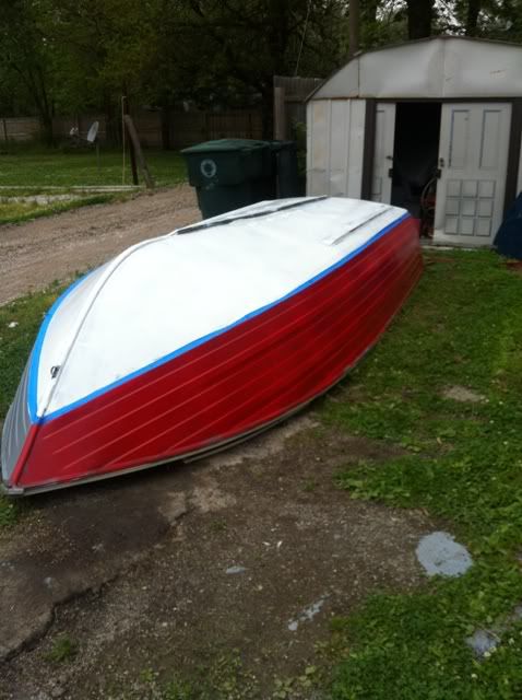

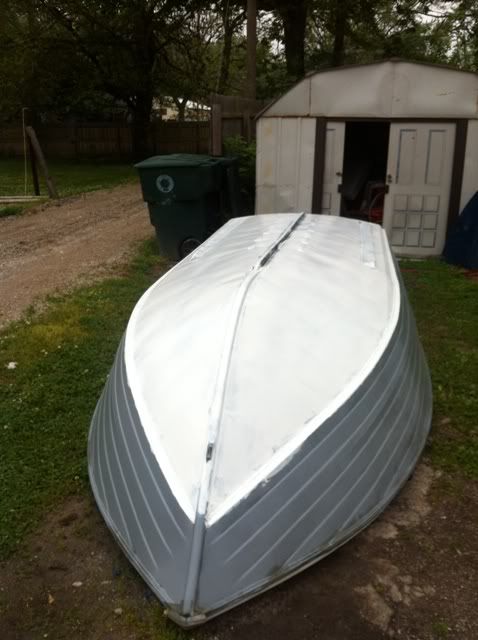

Finally making progress! I got the boat etching primed! then i got the metal primer on as well! Hopefully tomorrow(Saturday) I will paint the final white and red coats! Do i need to sand the primer or do anything before i paint the white and red on? I think i pretty much get the idea of roll and roll and how to make it smooth. I doubt ill make it prefect but i will try my best! as long as it looks good from a few feet away i will be happy! Im just not sure if i need to do anything to the primer before i paint.

Woodonglass recommended doing a wet primer scuff with a Scotchbrite pad in a recent post. I don't think it can hurt to give a little tooth to the promer.
Did you get the float switch? I put two pumps in mine, one auto 600 gph and one manual 500 gph. I wired the auto directly to the battery with no dash switch so it's always ready to go for a no brainer since I won't forget to arm it. Part of my pre-launch is reach under the transom and lift the float for a quick pump test.
Keep plugging away, JP. It will be nice the hull right side up again after paint.

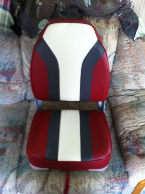

Some goodies came today!! two seats!!!

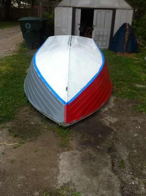

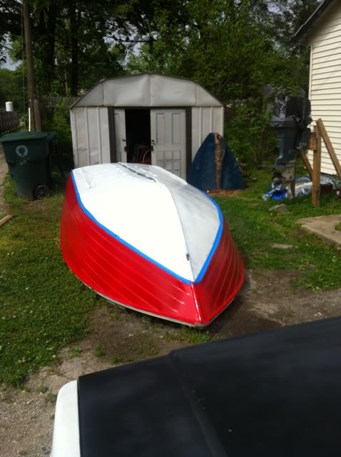

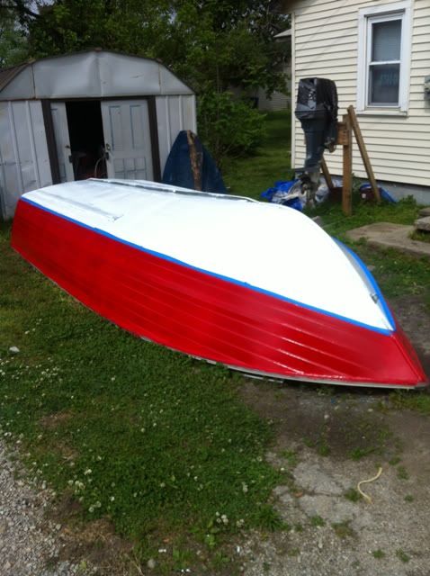

I got the first coat of red and white on the boat! im doing the second coat tomorrow! (sunday) Im pretty excited it was going pretty smoothy minus some birds pooping on it and bugs crawling in it haha
GT1000000
Jul 13, 2011
4,916
Re: 1982 AMF crestliner got it for free
Color's looking awesome...
Nice score on the new seats...
Love the color combo...kinda like an aluminum Superman...
