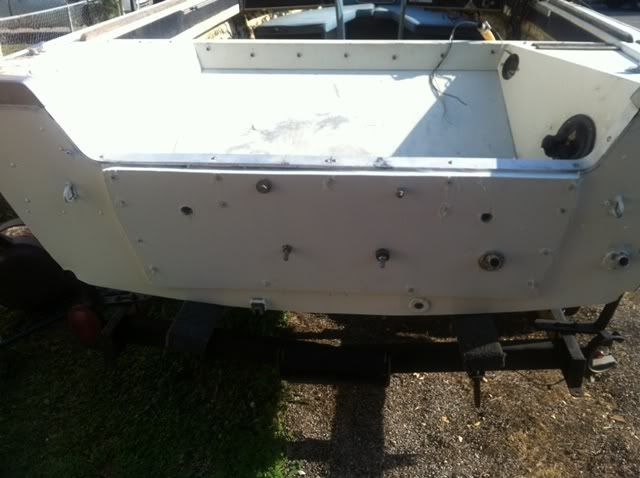

I also got my back transom plate sealed, painted and installed, also use cauking around it to seal between boat and board also cauked around the bolts on the inside of the boat from the wooden plate.

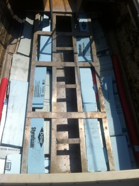

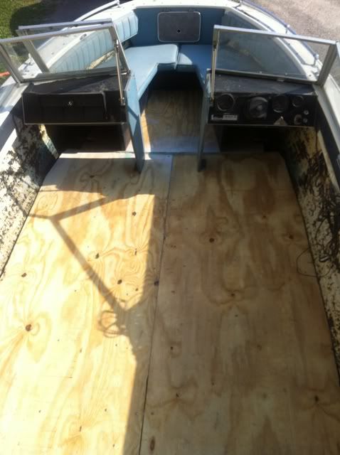

Got the foam in, which was a pain seeing how it was almost 90 outside today, got the floor installed and screwed down. Cauked the seams of it. Also got the front seats put back in. Will continue working on the interior until i can get some people over to help me and my dad put the motor back on the boat!!!! Then will come to the real truth if it runs or not.
