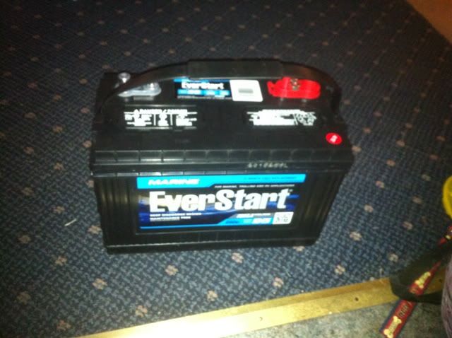

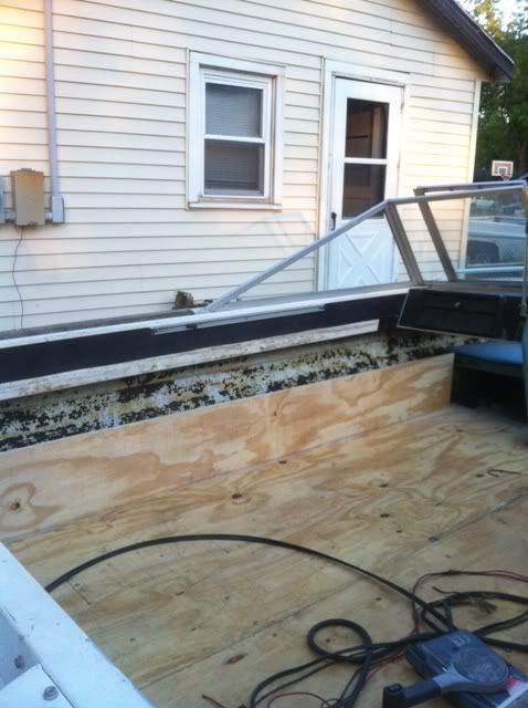

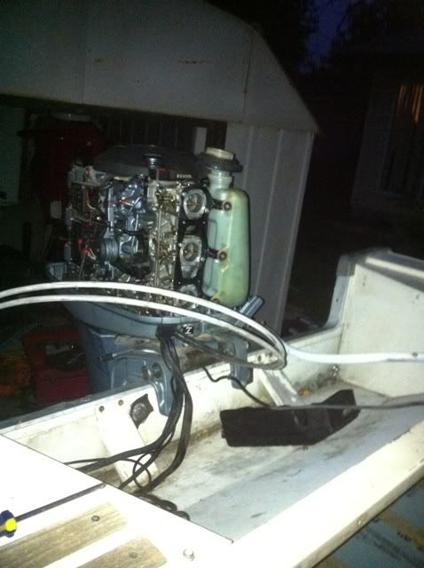

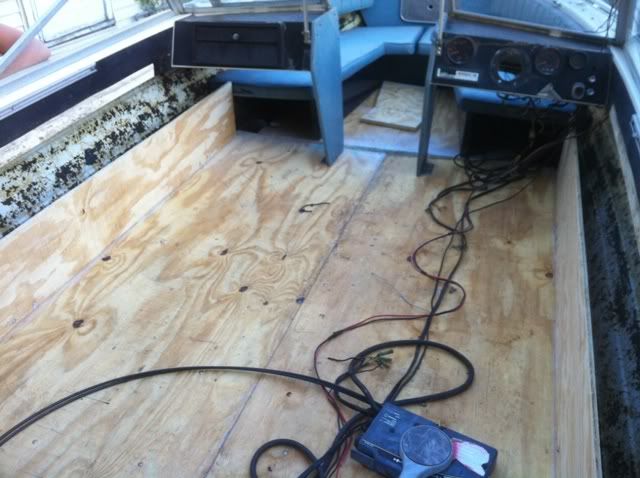

Came home from work yesterday and my dad and his buddies put my motor on the boat for me! I got most of the cables hooked back up to the motor. Got the floor seams all sealed with caulking. I got and made so side panels got the screwed down and sealed the edge with caulking. I used clear silicone stuff. It holds up outside on houses all year round for many years. So i think it will do just fine on those seams. Hopefully will be getting it running this weekend. Once i know it runs im ordering a steering cable. Once i get it running, its steering cable, new prop or getting mine fix and finishing the interior and ill hopefully be on the water soon! Sucks that it wont be ready for this weekend but im still very close to being done! i Got july 4th,5th, my birth the 7th off now im triyng to get the 8th off and the 6th haha mini vacation so i should be able to enjoy the boat then!!! I also picked up a batter today when i got off work!

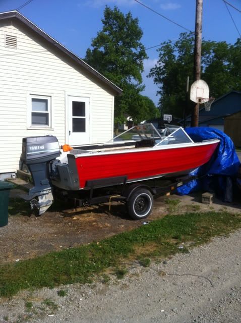

jp - the pic up there with the motor mounted looks good. Nice work, buddy.

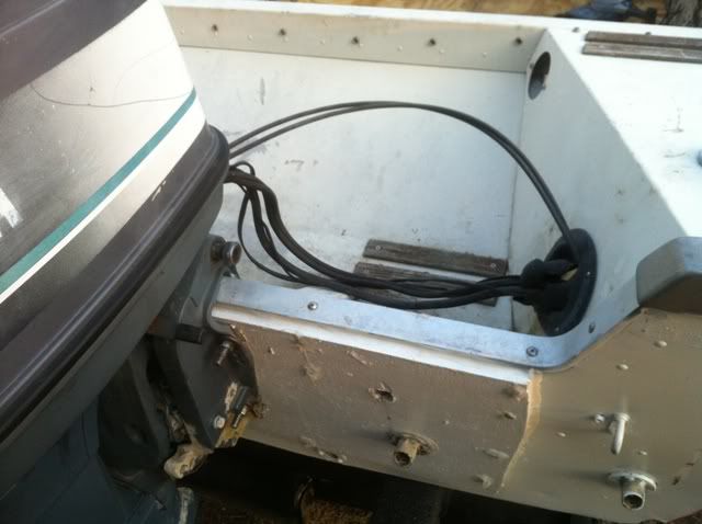

Im ready to order my steering cable tonight, i Measured my old steering cables its in two pieces now but i measured about 15 foot, if a steering cable is to long is that an issue also what kind of cable do i need? mine went threw the engine tilt tube. Rack, rotary? All my old steering cable componets are pretty much shot, HELP!
jasoutside
Dec 20, 2009
13,269
Re: 1982 AMF crestliner got it for free
A rotorary should work great for what you have there.
A little too long should be ok.
Long means that you'll have to put bends in it to take up footage, steering cables hate "S" curves. A lot long is a little better as you can make a big loop.
Short is a show stopper.

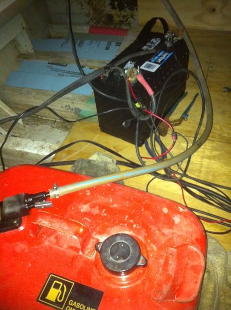

Got a key made for the boat, called a lock smith and he had one made in about 10 mins. Also got the battery and gas tank sitting in the boat and got my control unit installed!
Went to both wal-marts in town today to buy a fuel line kit, both were sold out and the marina was closed by 5:30 so i got a new primer, new connecters and new clamps but used the same hose for now.
We tried to start the motor today! very scarey moment, it didnt start but it seemed like it wanted to. just seems like it wasnt geting any fire i took two videos ill post one of them me nad my dad probably sound like retards haha but if anyone has any ideas when listening chime in please.
Also with water going to it, i didnt see any "pee" coming out anywere
Heres a direct link incase the video wont play http://s44.photobucket.com/albums/f39/jpormen/?action=view&current=IMG_3408.mp4

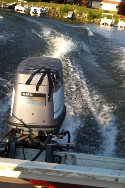

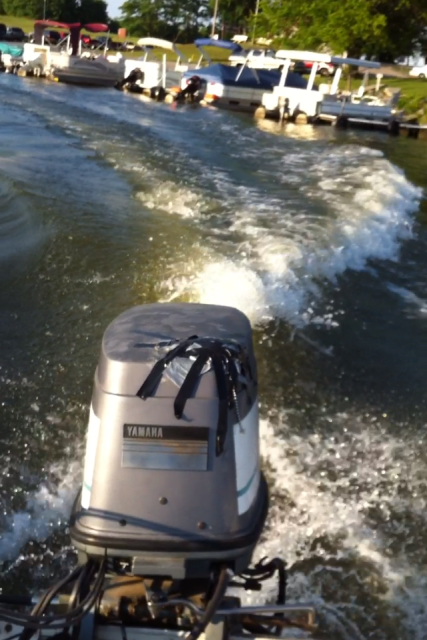

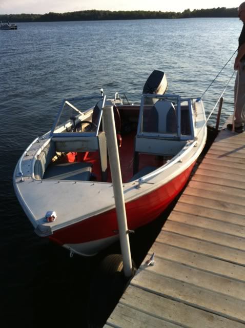

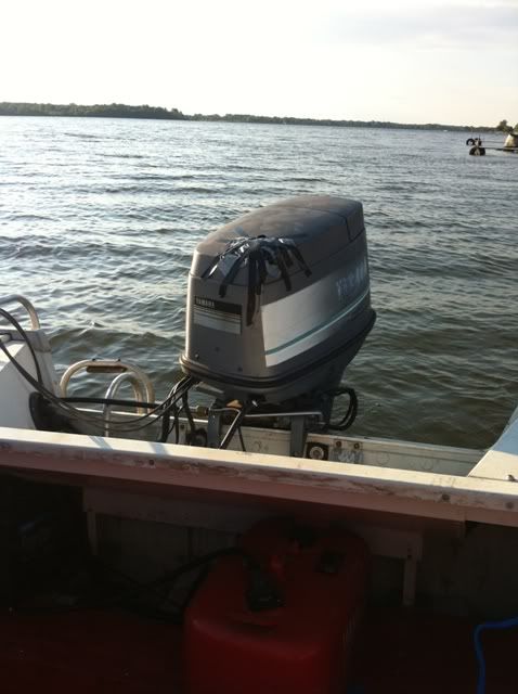

SPLASHED SPLASHED SPLASHED SPLASHED SPLASHED!!!!!!!!!!!!!!!!!!!!!!!!!!!!!!!!!!!!!!!!
The boat isnt finished but i was able to take if out for about 20 mins or so it ran pretty well, my prop is getting repaired and i got a loner to use while mine is fixed, its a brand new alum one no charge as long as we don't damage it.
After a hour at the License branch, i realized i had no title for the boat don't need it, they did have the boat on file and its actually a 1980* also found out the it was AMF crestliner, AMF ended crestliner in 1980 and a bunch of people who worked for AMF bought the rights or somthing to the crestliner name.
The pedestal seats dont seem very safe or sturdy, so im going to use them till i can get a better seating set up!
Theres tape on the oil cap because its cracked, and i just havent gotten around to getting a new one yet. Also got a video coming soon!
