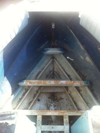

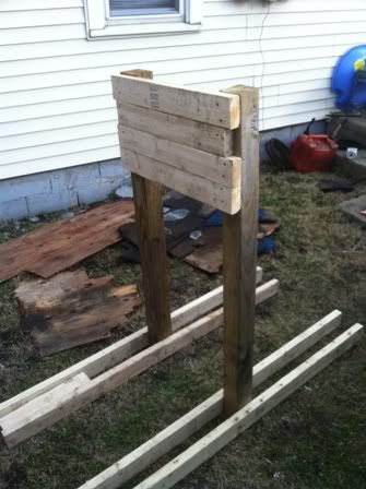

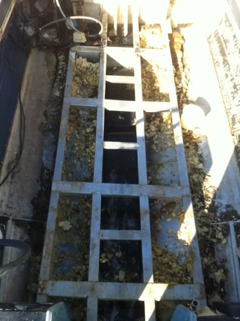

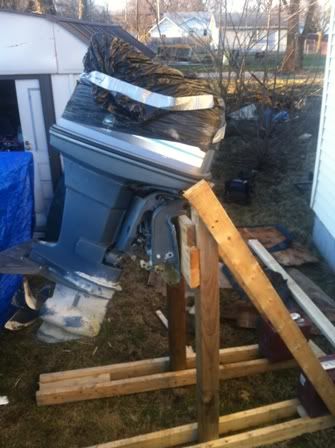

The past week in Indiana has felt like spring so i got some work done on the boat. I got damn near most of the foam out and i got a motor stand built i just need to add some support to it.

Your prolly going to want to add some more support to that OB stand. I fear your motor will flop/fold right over on that.
Cheers:)

Im going to add support i just ran out of screws, need to make a run to the hardware store.

Hey guys, i got 95 perfect off all foam and debries out of boat, im not in the process of finishing my motor stand and pulling the motor off.

Just hang the motor on the stand and drill one quick hole per side. Run a 1/2 x 13 bolt with a big washer through it and put a put a nut and another washer on the back. One on each side will hold it until you are ready to put it back on the boat. Mine is hanging on the stand with a big C-clamp holding it on.
Take the controls off at the motor, shift cable comes off from shifting linkage, throttle cable comes off from carb linkage. Electrics should be some sort of plug in with a hot wire to come off the solenoid and a ground on the block. Sorry, I forget youir motor brand and don't have time to look right now, or I'd be more specific.

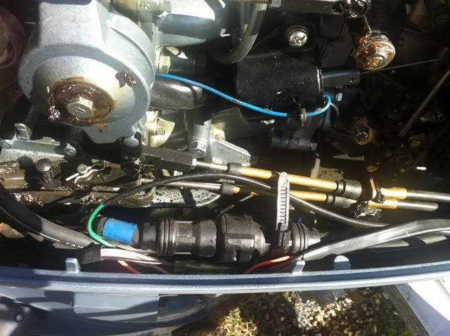

I didn't bolt my motor onto the stand. My transom bracket had a lip the went over the edge and i just set the motor up there. As long as its out of the way and not gonna get knocked or bumped; heck just lash the puppy on with some rope... that 90 has enough weight that the wind wont blow it off. Used the old batteries to counter balance the weight of the outboard. Also u work at wally world so pick up one of those kettle grill covers at $5 a pop and place it over the motor. Itll keep the elements off while on the stand Outboard on homemade stand.JPGPicture 005.jpg... just ignore that first stand it was a quick throw together while i built the one from the plans here on iboats
The industry standard is usually BIA bolt pattern
EDIT: Beat me to it! As stated unplug the easiest way possible that way there is no confusion when plugging it back up. The throttle cables come off the motor pretty easily... not sure about a Yamaha but my 'Rude had a plug inside the cowling that was clamped together for the electronics; pretty straight forward. When i started i bought myself a box of sandwich bags and labeled everything from screws to cables. Leave yourself a map in case u get lost!
Pretty sure everything u should have to disconnected ive circled in red but again im no yahama expert just trying to help out... Im sure someone will correct me if im wrong.

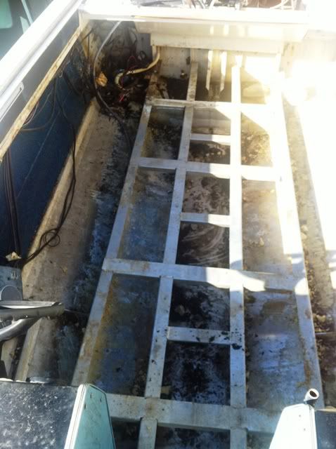

I gota all the foam out i just need to power wash the inside and scrap off the thin pieces here and there.

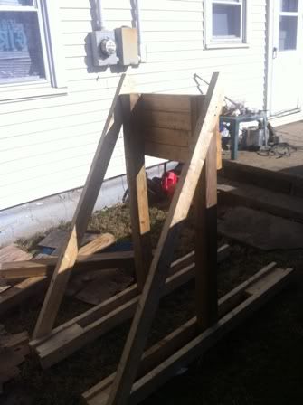

I got my motor stand braced better and im going to brace it up some more tomorrow.

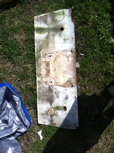

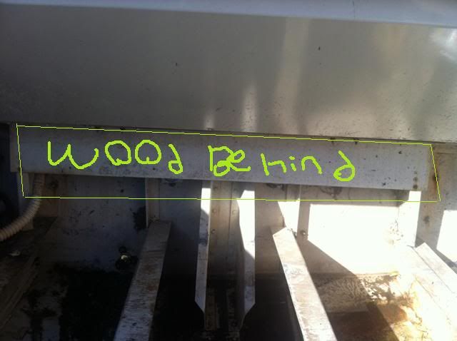

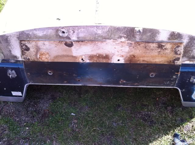

there is a small wood transom in the boat its like 6inchs by 3 feet or so should be an easy fix im postive its rotted ill be able to tell for sure once the motor is off

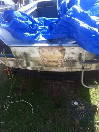

I got the motor off today and on to the stand.
We did not bolt it to the stand the weight of the motor is keeping it on the stand, only took four of us to get it from the boat to the stand.
Only bad news is that teh steering cable is definitely shot and i will need to buy a new one

I would suggest through bolts to hold the horozintal pieces to the uprights if you don't already have them in there - That sucker looks heavy.

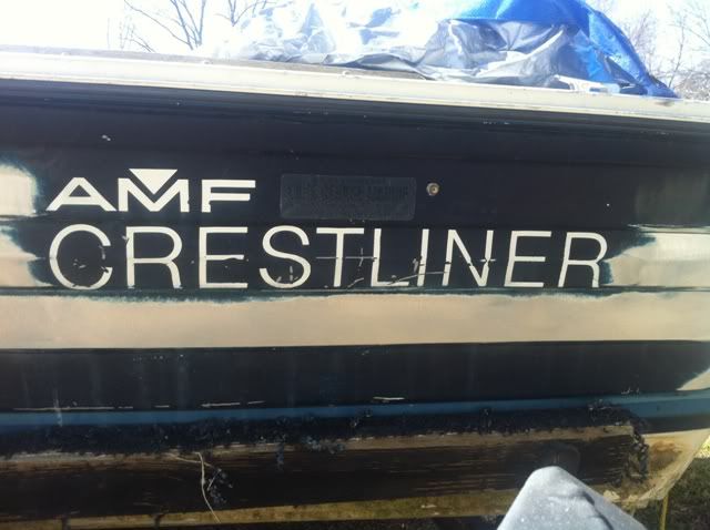

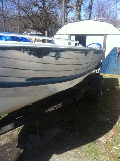

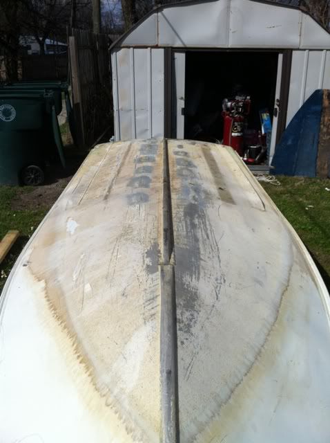

I started sanding today, its actually going pretty smoothly i would much rather sand then to pick out foam.
It took me about a month or so to get most of the foam out so but i didn't work on it every day its nice to be doing something different now and having motivation again to get the boat finished.

Paint removal is just ahead of trailer fixin' - Both are a pain. Maybe poured foam is in the mix too. :eek: At least you got out of the boat and are working on the outside. Are you going to bare AL or just a scuff to paint over?

Im going to bare all, you cant tell in the pic but the areas that i did are bare now even tho it looks white. Im going to take prolly all that i can to bare. Its coming off pretty easily and its really not to hard i dont think itll take to long i just hope the bottom comes off as easy as top of the sides were.
I bought some more sand paper after work and i bought some masks i dont want paint in my nose in mouth

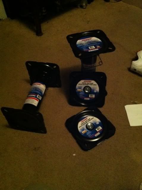

This is a little off topic for the progress of my boat, but for my interior i had planned on from the beginning to put two pedestal seats for the driver and passenger seats and im not sure what im doing for the back seats. As many of you know i work at wal-mart yesterday at work i had to take some boxes down to the sporting good department and glanced at the boat stuff i noticed they had clearance tags on two boat pedestals and with some investigation i found out we are not carrying those in the store anymore, so on my break i bought the last two pedestals and the spinning seat plates. The pedestals cost $13 a piece and the plates cost $5 a piece it was a great deal i had to buy them now why they were so cheap! they also raise up and down too

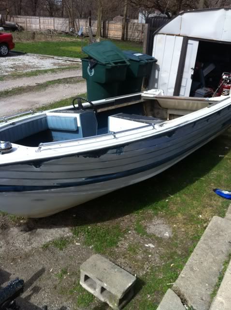

Got the boat off the trailer,now i just need to get it flipped. I thought i could push it off by my self i ended up trying to pull it off and luckily one of my neighbors came and gave me a hand.
jpormen
May 24, 2011
172
Re: 1982 AMF crestliner got it for free

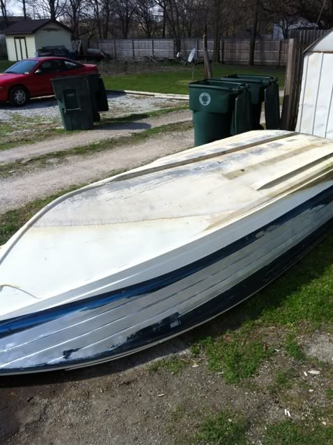

Got the boat flipped now i jsut need to finish sanding it.
My uncle has restored cars, gas pumps, bikes, you name it hes prolly restored it. He has a spray gun and he said he has alot of white paint, and he has alot of pepsi blue paint, he works at pepsi in the garage, he said he would paint it for me, i might have to buy paint thinner and a fewother things but he said he has hardner and almost everything we need, i just got to buy some Budweiser and ice!
anyone got an ideas how i should paint the blue stripe just interested in some ideas!
