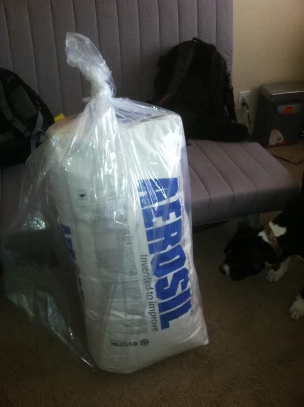

So I was looking at the wrong big bag, the one I needed was about $120 not $45. Lucky TAP Plastics is AWESOME and gives me a contractors discount since I go in every other day it seems...
Yay for 10lbs of cabosil
