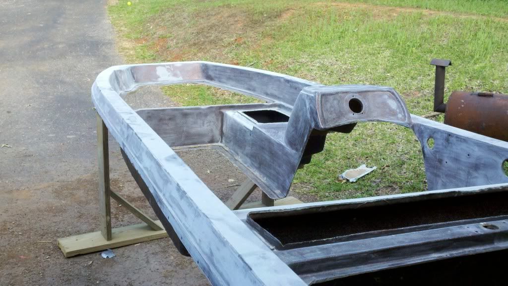

More progress! I picked up a lot of supplies last night and got busy today with getting the cap off and and ready for some work. I built a couple of stands from some PT lumber I had (nothing pretty, but they work). I pulled the cap and put it up on the stands. I started by glassing up the large holes that were up in the bow. Tomorrow I fill/fair them and fill the remaining screw holes and such and hopefully have it all sanded and ready for primer by the end of the day.
They're nothing spectacular, but here are a few pictures from today after I put the top cap on the stands. The stands are the perfect height for me to be able to work on the top cap without killing my back.

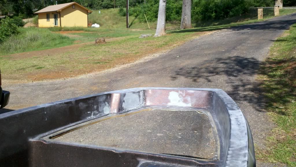

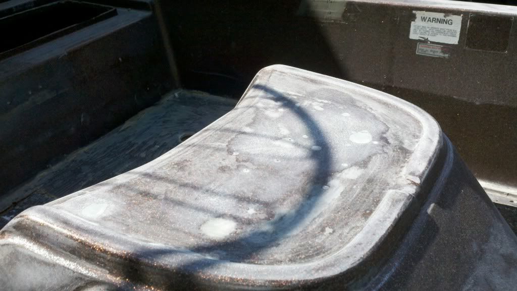

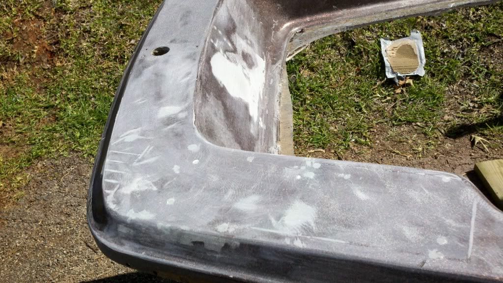

More progress to post!

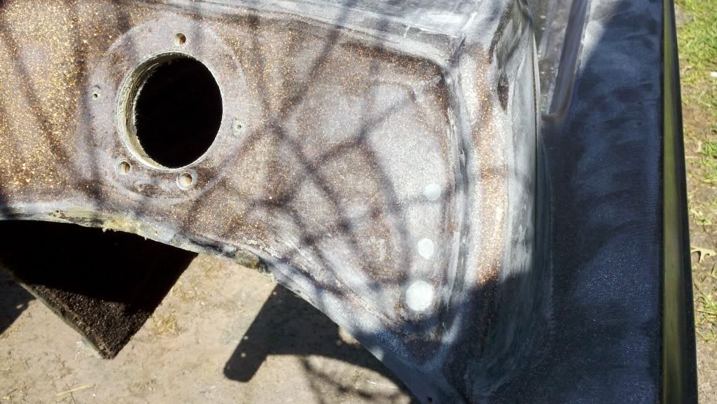

I finished 'glassing the holes in the hull. The previous owner had made pretty large holes for some reason, but had them covered by plates/stickers. Never could figure out their purpose, so I closed them up. Anyway, after glassing them I faired them (and by no means are they perfect, but they're good). I also filled the screw/switch holes throughout the rest of the cap.
Once the holes were all filled, it was time to sand. I went through an entire pack (8 sheets?) of 60 grit paper to get to this state! There was a lot more surface area than I had thought/expected. I didn't want to miss anything on the cap. The last thing I want to happen is to have paint pull up in the nooks and crannies. Anyway, I've since hit it with 150 and 220 and I'm going to hit it with some 320 after dinner (I know I don't need to go that far, but I've got the paper so it won't hurt any). I'll give it a good bath and hopefully be able to put on a coat of primer tonight. I'm starting to get nervous thinking about what the paint is going to look like (it looks great on the trailer and my stripes, so I shouldn't have anything to worry about but we'll see).

Good call on the reason for the port-side hole GT1M! There was an old TM receptacle to the left of it (the smaller hole that was filled). It makes perfect sense that a hole would be there for access to the TM. The hole not factory, though (either that or it was enlarged at some point) as the edges were not even close to even/symmetrical/smooth. I've got a new control panel that I will be putting in this place, but I needed to close it up first since my panel is much smaller than the hole.

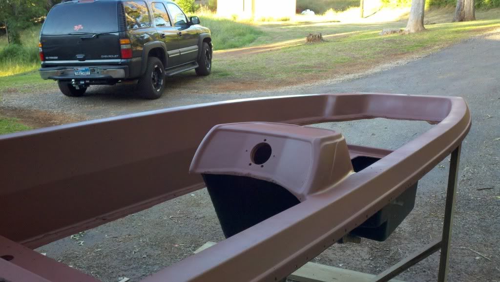

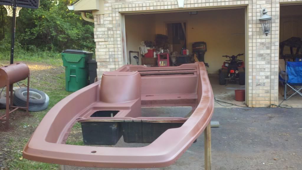

It ended up being later than I wanted by the time I got back to the boat after dinner, but the wife came out and helped me wash it down and wipe it with acetone so that I could get started spraying the primer. I had to get a new water trap and had some problems with it... and then had some problems getting the gun settings correct so it was dark by the time I started spraying. I pulled out the shop lights and was able to get a 90%+ coat of primer on (I'm sure there are a few areas that I couldn't see that didn't get sprayed). I'll take some pictures tomorrow morning. I doesn't look much different, though, because the primer I bought has a brown pigment instead of white/gray (go figure!). Tomorrow I should be able to scuff it and put down the 2nd coat. The goal is to have the top cap work done by the time my US Composites order comes in. It sure does feel nice to be busy working on the boat again. :D

Sounds like you had a great weekend. The cap is looking good.
What filler did you use on the cap.
fmjnax
Jul 21, 2011
457
Re: 1984 Skeeter Champ 16' Restore
I used the Bondo marine reinforced putty stuff.

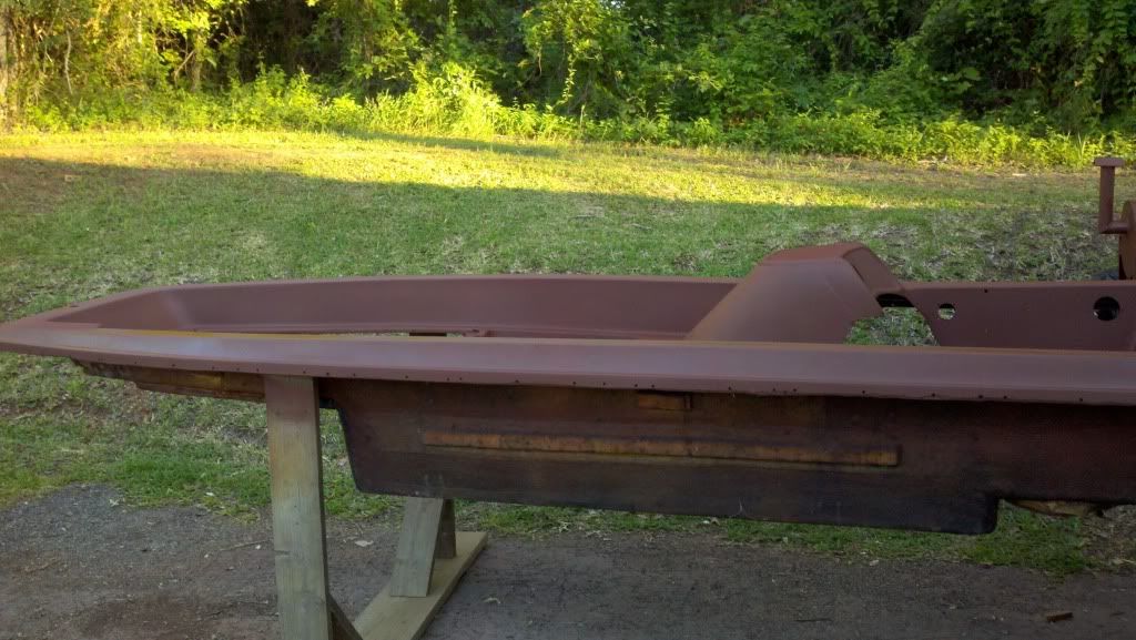

I got 2 more coats of primer on the hull today. It all looks good so I am calling it done. We have baseball and/or softball for the next few days so I'm not sure when I'll get the first coat of color on it, but it will be soon! Here are some pictures after the 3rd coat. It's a nice dull brown, just waiting to become maroon.

Yeah, that'll work just fine...a lot quicker, too...
BTW, the "red oxide" primer coat looks good, and it should make the maroon on top look real rich...

I sure hope so GT1M! I'll be honest, it wasn't by choice that I got the red oxide. Nobody in town had the "regular" primer in stock and I didn't want to wait a week. I wasn't sure how it was going to work out but my dad (who was with me) said that my color will look better over a dark primer than it would a light primer so I figured 'why not?' and bought it.
On a side note, I'm real pleased with how well my patch job on the holes up front turned out. They all but disappeared (as they should have... but with my lack of experience, I didn't know how well I did)!
