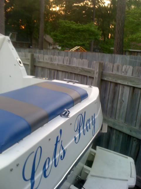

I'm going to just update this thread with the finished product of the new "L" seat. I'll also post a link to the thread that details the build and finishing. I received TONS of helpful advice from several members of iboats. Thank you very much!
Here is the new seat:
I'm unsure what the next project will be. I've started compounding the interior gelcoat areas and getting good results. Hope to get the entire area completed and waxed this week.
The captains chair looks completely out of place now with all the new vinyl everywhere. That looks like quite an upholstery project and i'm not sure if i want to tackle it. However, the price of a new captain's chair is quite a motivation to recover it myself!!!

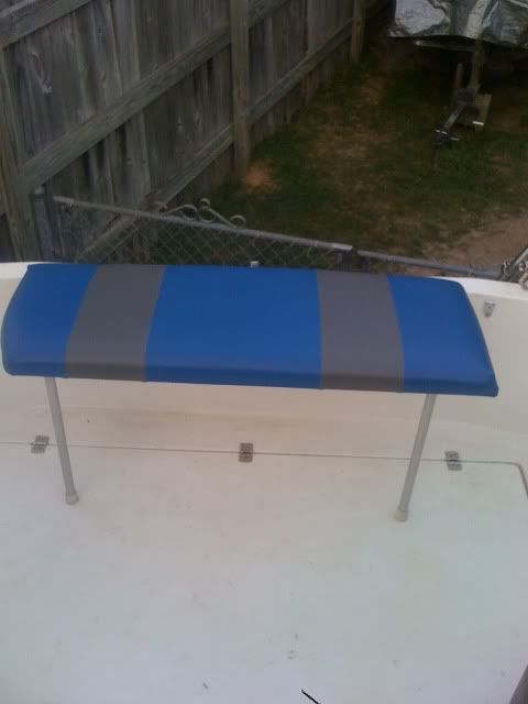

daddybx, the rear seat measures 47" x 18". I used two 1/2" pieces of ply laminated together to make the base. The factory seat only had 1/2". Its attached by three hinges to the stern and has brackets to accept the poles that hold it up.
Here are all the pics I have currently of the stern seat and parts of the build for the new one..... Lemme know if ya need more.
Ciera2450
Apr 8, 2011
1,049
Re: 1985 Bayliner 2450 Ciera Sunbridge Restoration underway!
note the small angled corner. I'm really unsure why it is there, the original seat had the angled portion and I simply copied the shape.I wish that I had just made it a rectangle. I reused the orignal 2" thick foam and covered it with new vinyl.
