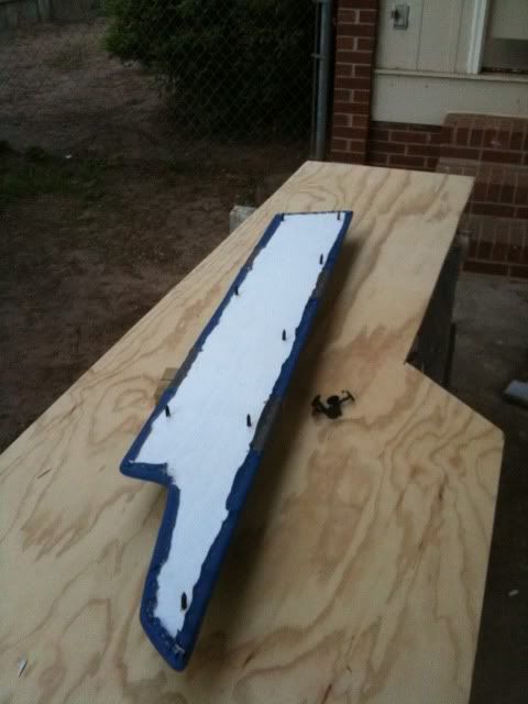

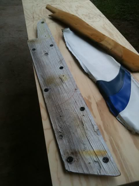

Here is the original trim piece, the vinyl is in kinda crappy shape and didn't match the new stuff.
I pulled out each staple individually and got the vinyl and foam off the backer board in one piece...the backer board is checked like crazy. Its only 30 years old!
What are these things called?
broke two of them ripping out the piece.

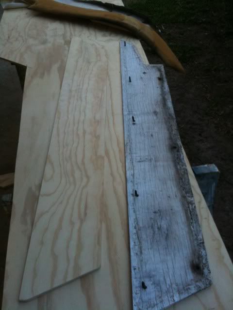

I had left over wood, so I decided to cut a new backer board to replace the old one....
Hard to see in the pic against the plywood but I traced the old one and cut out the new piece. One side has a coat of epoxy paint on it and will flip over in the morning to paint the other side.

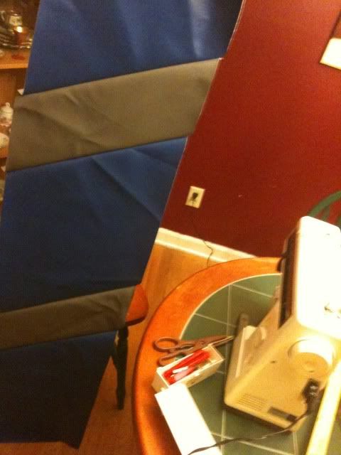

While I was on a roll, I went ahead and cut some scrap vinyl I had laying around and stitched up the new cover for the trim. I changed the pattern of the stripes vs. the original but this design will match my new upholstery design...:)
(the vinyl is wrinkled because it was scrap and balled up in a bag, I assure you the seams are straight lines! lol, and double stitched..

Thanks wood! Do you know the name of those plastic body clip dealy bops in the pic above? I gotta replace them on the new trim piece, and thinking of using them to attach the backrest of the new L seat. They almost look like the things that hold on door panels in a car....

jimmy you are right, thos thingamabob (trim fasteners) are the very same kind that auto makers use,,,, there has to be a gazillion different styles,,, i found napa had the best assortment of them.

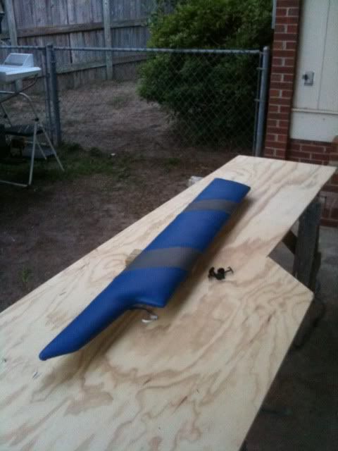

Thanks for the pics mark! I found the body clips at o'reilly autoparts. I got the trim piece finished up, just have to reinstall in the boat.
I'm happy with it! It came out nice, now if only the seating will be as easy...lol

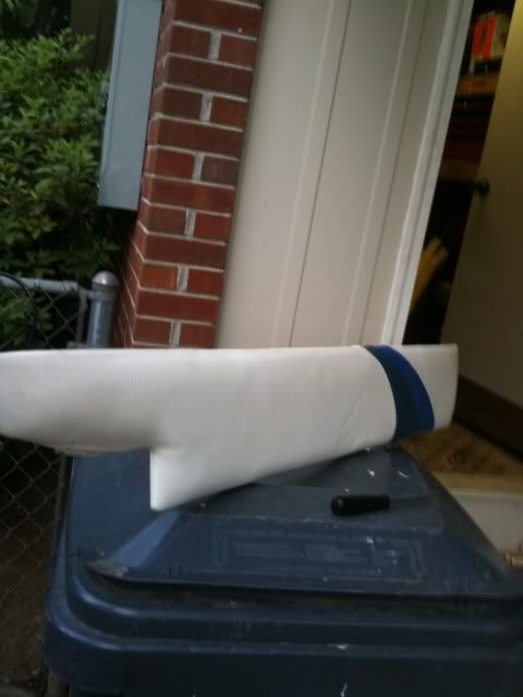

Here is a shot of the backside and the new xmas tree body clips
