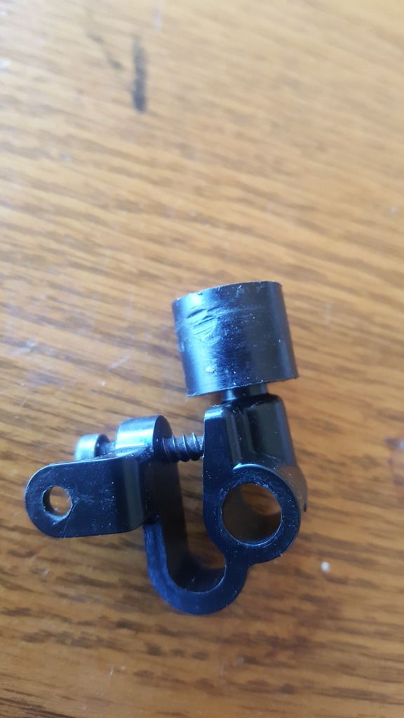

Aha!
Problem (maybe) solved. Here is my cam follower and roller.
Here is what it should look like.
Looks to me like it should have an outer plastic sheath, that pops over the top. I have a new one on order.

And....getting pretty close to success. I re-cleaned the low speed idle on the carb, and replaced the plastic insert that I hadn't replaced before - as it appeared to be in good shape.
I also had a roll of Red Green's secret weapon in my tool cabinet. A very professional plastic sheath has been fabricated.
Starts up no problem at all now. Runs pretty well, but it is still experiencing intermittent drops in power. I suspect the fuel pump is getting older.
Still doesn't idle all that well, but 1/4 turns in the lean/rich knob make a noticeable difference.
