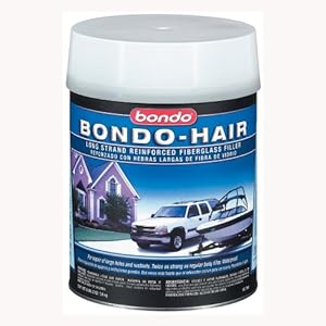

Couple of quick questions??? Since I've got everything out of the boat the side panels need to be redone. What type of ply should I use and should it have a layer of resin on it? Also, I have a few little holes which need filling since they were used to hold side panels up but after someone over drilled they no longer work. What will I need to fill these holes? I'm trying to buy stuff as I go so it isn't a huge hit to the wallet (whom I kidding, I'm married I have no money in my wallet) at once. Thanks!
MJR
I don't care about color matching since the holes will be covered by the side panels.

You can fill those with "Hairy Peanut Butter" of your own making (Lot's cheaper than buying it), or... You can buy some of this. Since it's above water and wont be getting that wet or seen...

Wood,
Thank you. I've got all the makings for P-Nut Butter so I'll do that rather than spend more money I don't have. What about they ply? Can I just use exterior ply with a coat of resin over the top since these panels shouldn't get that wet or is there something better? Thanks again for all the help.

Yeah, 1/2" or 3/8" Arauco ply would be my choice. However resin without CSM is no good. You need the mat to keep the resin from cracking. If it were me, I'd buy a gallon of Epoxy. I keep this on hand in my wood shop for all exterior projects. Since you won't be using Poly on it then no worries about adhesion and it does not require mat. If you go with the poly then you gotta use the CSM. OR you could just use some Ext. Grade Polyurethane or Oil base paint. It would make the wood last a lot longer than if it was left bare. Especially the edges. That's where the moisture gets in the most.
