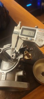

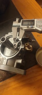

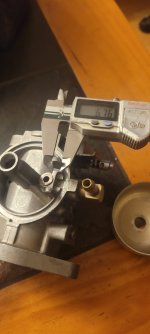

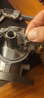

I guess I can give it a try.
Any idea if the broken piece on mine can be reattached and if so what is the best way. Don't know if you can tig it.
Nordin
Jun 12, 2010
2,748
No the broken piece can not be attached in a proper way.
It has to be pretty accurate line up for the pivot pin.
Otherwise the float and inlet needle will stuck or the needle will not close properly.
Maybe JB Weld or other chemical metal can be used to glue it back, but for how long will it last as it sits in fuel all the time.
gica
Feb 24, 2016
583
Yeah I thought so.
I am not too worried about the needle closing properly as it is pushed in by a tab on the float. But the manner in which it canbe safely attached is another story.
Honorary Supreme Mariner
39,998
Post the actual size of the part that broke off.----Is it 0.200" X 0.200" ?------Then drill and tap the carburetor for a proper size screw.-------Drill a hole in the screw for the pin.------Screw can be bent and adjusted to line up the pin hole.-----Nothing to it !
gica
Feb 24, 2016
583
Here is the piece. I don't think one bolt is enough. It holds the float. No real strength needed but some is good.
