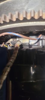

So I ordered a trigger based on the online Crowley Marine info 300-888797.
I received a 4 wire trigger with a 5th ground black. My trigger has 2 wire per cyl so 8 total. The only ones I found to be similar are for the 90hp but being a 3 cyl it's not good. Any idea where I can buy this.

Nordin
Jun 12, 2010
2,717
I would suggest you to call Franz at Franz Marine Service.
He is the man that knows all about Chrysler and Force.
He will have the right trigger base and if he not have it, he will give you information where to find it.

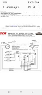

I just read about the replacement 4 wire triggers on the CDI website.
Supposetly they trimmed it down to 4 wires from 8 and the wires are stronger and longer lasting.
And this is how you install. I thought it was tye wrong part but it seems they don't make the 8 wire anymore.
Waiting for the stator tomorrow and then I will take out the flywheel yet again. Hope this time it will be easier.

The one I got is OEM Presto 300-888797 5 wire just like the CDI in your attachment.
Can I use that and install per diagram below?
The resistance between leads is in the 90s between 4,3 and 2 and in the 70s between 2 and 1. So that is a bit different.
I had another look & I see now the second white-green lead, sorry yes it looks like the correct one

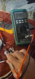

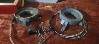

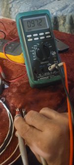

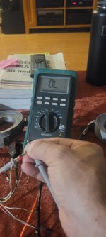

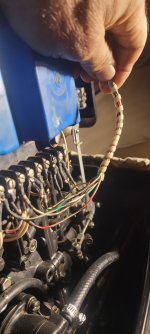

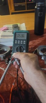

So earlier I removed the flywheel, so easy this time thank god, and I have the old trigger in front of me, I don't get any readings between 1, 2 , 3 and 4. I only get readings between 1 an 1, 2 and 2 3 and 3 4 and 4. Remember there are 8 wires. And I get OL between any of the wires and the body of the trigger.
On the new 4 wire plus ground I get a reading between any of the wires. And all the wires are continuous to ground and body of the trigger. Wtf.

On the new one I get 96ohms between any leads and 48 ohms between any lead to ground. The ground seems to be common. The 8 leads also had ground on every second lead when mounted on the outboard. It tested continuous to the mounting bolt.
Anyways I do hope this fixes the hesitation issue.
I still need to know if I can use the 4 wire in the place of the 2 wire. I think I can.
It was redone to eliminate the second wire from each pack.
