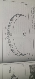

Wanted to ask I set the cranking timimg at 28BTDC. Mine is a 1990 Force 120. I am going based on the book. Some have 30 but I think mine is at 28. Just double checking

These are the flywheel timing marks

Ok so cranking timing on Prestolite has to be set at 28 BTDC which I think I did. I will doublecheck tomorrow. And the 28 mark is the right one out of the 3.
gica
Feb 24, 2016
583
Ok so both engines were at 32 BTDC put them at 28.

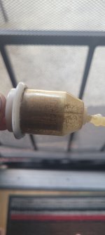

My inline filter on the starboard side had sand in it. I could not prime or pull any gas to it

Ok changed the filters and one prime bulb. One engine is great. The other has idle issues.

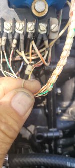

So unplug #1 and use the #3 lead wire in #1 for spark. I bought the DVA adapter and the spark gap tester. So as far as the trigger testing are there specific wires? Thanks.
gica
Feb 24, 2016
583
So ine of the 2 # 1 trigger wire came right off when pulled on.

So now I have no spark on any of the leads. I fixed 2 wires that came from the trigger. I tested by taking off the two yellows and no spark. Also the black and yellow at the rectifier. I am teying to find the tests for the stator and trigger with DVA adapter for 1990 model 120HP.
Also I removed the tachs because they were the 12 pole types. Can that causeissues when removed?

THE YELLOW WIRES going to the CDI-modules GENERATE THE POWER FOR THE SPARK, they NEED to be hooked-up
Make sure the kill-circuit is open/ not grounded
I send you a PM on how to check the ignition/Ohm readings etc etc.
I.....would change all the connectors on the trigger-wires/check condition of wires for breaks in them. they're very thin!
IF you have a 12 pole stator? (the 85/90 hp does) a 20 pole will not work
RE-check your hook-up of the wiring & make sure the starter spins fast enough to create the power for spark

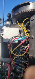

Weird I could not get any spark on any of the spark testers, so after fixing the trigger wires for number one I put it all back and it started. I get spark on number one also. It doesn't look strong on the cheap tester, really faint red light. Maybe the daylight is causing the spark to not be so visible.
My stator is a 20 pole the tachs I bought from Furia don't show the right RPMs. So I just installed the ones from Amazon for 20 pole and one works the other does not. So I replaced the older style rectifier with the square one. Haven't tested it yet to see the tach is working now.
Ok just checked and 2nd tach up and running. The old style rectifier was junk.
So if the gray didn't get give signal the yellow that was linked to it aldo probably was not good. On the old rectifier one yellow is linked to the gray.
