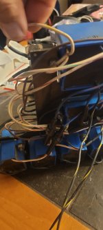

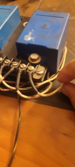

Anyways, I did find another broken wire from the CD module that goes tonumber one. It's the white and yellow wire, connector came right off. I removed the whole assembly and repaired it. This goes to the second number one connection right next to the mounting bolt. It's a ground wire.

Okey, that can be the thing that gives you the issue.
Check all those thin wires, pull gently at the wire and check if it is loose at the lug.
They can be loose under the shrink tube.

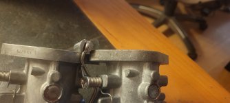

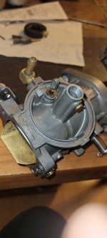

Hi guys so one of the carbs, top one, had a mishap and a tab that holds the pin from the float broke off.
So I bought what I thought was tye same carb. It was listed as F589061-1 TC106A TC-107A Force 1989-1994 Carb 120 125HP.
But this thing doesn't have the same thing on top. The adjustment screw is long and goes through where the air jet 8s on tye other one. I completely did not notice the difference in tye pics. It is for Force engines.
Any idea if I can use it. I have the bottom one also same thing.

If the carb intake diameter is the same and the main jet has the same size it should fit.
You have to check that the throttle rod and the choke rod lines up with the other carb.
The new carb is from a earlier Force as the air fuel mixture screw is not siting in an angle but the function is the same of it.

I was hoping that it'd work. The inlet needle looks shorter too. and it's all shiny metal no rubber. I hope the adjustment is the same for the air mixture screw.

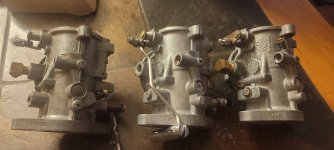

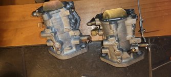

Here are the pics of the 4 carbs side by side. Left is my broken one.
The numbers show 589061-1 on the 2 I bought and on mine 589061-3.
Plus mine has tye TC-106A-994 also stamped. The other2 just have 086 or 104 stampe.
Outside identical except for tye aforementioned changes, of tye air jet and adjustment screw.
I'm confused, in none of the pictures are there 4 carb in a row!??
The one picture with three in a row shows a bottom carb (center one)
I thought we're trying to match top carbs only?!?
How many carburetors did you buy? 1 OR 2 ?
gica
Feb 24, 2016
583
ok, I am getting over the flu here so brain fart, since the middle carb had no nozzle for the gas hose I confused it with a top carb, omitting the choke fitting entirely. Sorry about that so I guess I have 1 top and 2 bottom that I got newer. in the pics of the 3 it is like you said thanks for pointing it out.
