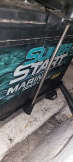

Batteries are SuperStart Marine Deep Cycle. I almost always charge them before going out. I don't know if I did that when I took the picture. The motor was acting up so maybe I turned it a few 20 times and one went down a bit.
When I did test it at idle it was really slow to gain voltage but it did. I didn't know it starts to charge at 1100 or 1200 RPM.

Ok but my question stands should the reading with a voltmeter read say from a standing 12.5 battery go up right away or really slowly. When I read it with a voltmeter it went up slowly, I mean really slowly like 1 volt at a time it didn't jump up to 13 or so.

I would say the voltage should rise right away.----It does on other motor brands.----Have you considered getting a pair of different motors.----Seems there are a lot of issues.

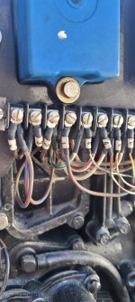

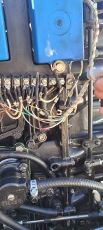

OkForce Power, so I don't know if I am doing it right but I measured resistance between all the 4s, 3s,2s and 1s. I fillmed it all. Between the 1s I get 55ohms and between the last 2 and first 1 I get OL. The rest are 51 or 52. The other motor shows 51 or 52 also.
Mostly 51 ohms.
So between tye 2 wires that have 1s on them I get 55ohms. But from any other one to the 2/1s I get OL
Also from any of the firsts 4,3 and 2 to tye mounting screw I get 52s and from the second 4,3,2 wires to tye same bolt on tye picture below I get 0. But from the 2 wires to the same bolt I get nothing.
Gor tye stator I get 576 between 4 and 3 and 717 between 2 and 1
Again don't know if it's what you suggested. Let me know and thanks.

I'm struggling with these issues myself & for myself to simplify this;
I disconnected ALL the trigger-wires from the terminal-bar to eliminate any false readings & clarity
(1) verify you're taking a reading from the correct trigger-wires (per set)
Then disconnect all the Stator-wires (except the two for the rectifier)
(1) Make sure you're taking the readings from the correct wires (per set)
by checking if indeed the two wires are in the group of coils on the stator
(2) The set that was reading 576 Ohms check the the wire-terminals by bending & pulling on it to see if the wire is actually properly secured
Hook everything back up & check the voltage-output on each set of trigger-wires & Stator-wires
