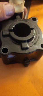

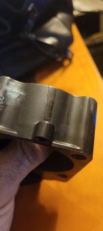

As far as the heating issue well, I cracked the impeller housing guys. And it was new.
I screwed it up. I will provide pictures.
I reordered it. Wtf. I should have known better. And when I angled the engineit went in right away. I guess I always screw it up first then get it right. Oh well.

The torque spec for the pump housing bolts is 70 IN LBS....or about 6 FT LBS....think maybe you cranked it down too hard?

No, I did 70 inlb. It's from lifting it with a jack like a moron. Hipefully this will fix that issue.
When you put the impeller in the engine is twisted clock wise right?

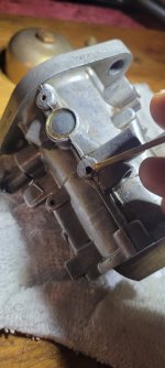

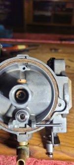

So the hole inside the bowl and the one hole it leaks through are connected. I blew air through it.
Any thoughts? Am I missing something?

1692507146758.pngThe impeller spins clockwise .....this pic is what it should look like from underneath.....with impeller mounted in the housing, flip it over and slide down the shaft and engage the key in the slot.
The carb leaking from that hole......could be the float needle not shutting the fuel off and causing it to overflow out that hole.

You know I thought that. I adjusted the float because when I turned it upside down it was sitting down passed parallel so I bent it to keep it parallel. In the book it says it has to be parallel to the body on one end and almost touching the jet onthe other adjustment end.
But the holes that leak are linked to the bowl and the other to the main channel also in the bowl.
I don't think I want to mess with the idle tube and contact nozzle if I don't need to.
Any idea if the float being out of adjustment can cause the idle issue?

It doesn't matter which way the vanes of the impeller set when installed.
The second it is turned over to start it straightens out.

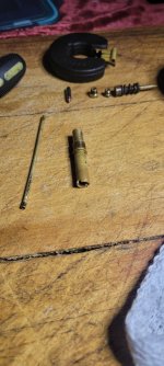

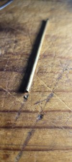

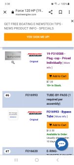

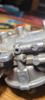

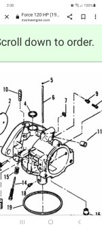

So I took the carb apart. In order to get the main nozzle unscrewed I had to remove the long tube #6 that was in the way. There seems to be a plug cap #5 at the end. I hammered it from the bottom out through the bowl. I did not see the cap but the tube was plugged up couldn't blow through it. opened it up with a paper clip. That might have been the end cap who knows. So now I have to buy a cap.
What is the purpose of that tube? Is it supposed to be plugged up?
I took off all the jets air and fuel. Idle mix adjust screw. Did not remove the welch plug.
So just clean and put back?
Found this on the floor. Last picture. Is that a plug. It's minuscule. And it doesn't really stay kind of moves around. Should JB weld it? What the heck!
