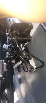

1990 Force 120HP trim and tilt not keeping motor up no leaks
gica
Feb 24, 2016
583
So I rebuilt this motor successfully. I have a fual motor on my 24 footer. And after I raised it up it slowly started sliding down. It foes stip but too low for confort. The other one slides down only half way. There are no leaks on the outside anywhere. So I read and bought some cylinder kit for trim tilt and shock, but after reading some more I found out that the pump is most likely the culprit. So I wanted to know where I can get some o-rings and info on what to do so I do not screw things out.

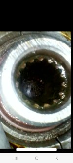

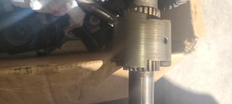

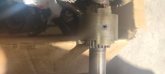

OK so I pulled the drive and before I did that. I drained the liquid Inside and surprise surprise there was water with a little bit Of fluid luckily it was only lake water. I removed the propeller and the shaft inside I didn't see any rust
I looked at the spines in the crankshaft and they look fine.
I saw o rings In several places Including the lower shaft.
Now when I when I lower the gear link Rod And spin the propeller It seems to engage the main Shaft

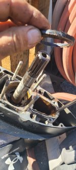

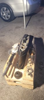

So I took the drive apart. Need some bearings and seals
Nordin
Jun 12, 2010
2,718

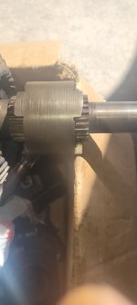

Now when you have the LU apart check the clutch dog.
It is the clutch dog that make the shifting from forward and reverse and vice versa.
The edges at the clutch dog teeth should be sharp and perpendicular not rounded.
If they are rounded it maybe slip out of gear under load.
Will do

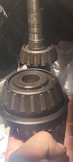

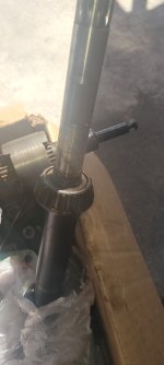

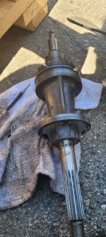

So there are 2 bearings one on the main shaft which was definitly full of crud and the other attached to the reverse gear don't know if it is salvageable.
That one is big. I cannot find a part number for it. Any ideas?
Here are pics of the bearings and clutch dog(I think)
