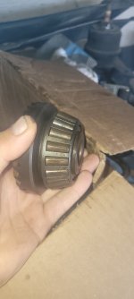

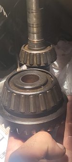

It's attached to the gear. Is this the forward or reverse. It goes all the way in up to the shifter.
I am watching a video of a guy doing the exact drive and it seems to be tye forward gear.

Nordin
Jun 12, 2010
2,748
The gear and roller bearing furthest way in the gear housing is for forward.
Looking at the pics it looks like you have to replace the roller bearing and race.
Clean the gear and roller bearing and lube it with thin oil.
Spin the bearing and listen and feel how it sound when spinning.
Maybe it is reuseable.

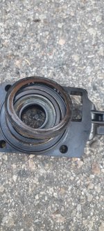

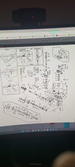

I am trying to locate the seal in yhe picture.
Nothing in the diagram shows it. Have no clue where to locate it.

2,748
Part number 18 and 19 are seals.
18 seal for drive shaft to water pump housing and 19 seal for drive shaft to gear housing.

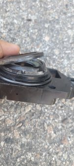

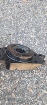

So what tye heck is that platic hard seal looking thing.
This is how I got it out right above the retainer.
Nordin
Jun 12, 2010
2,748
Looks like that is a part of the cover and it has broke from the rest of the cover.
The cover has a grove for an o-ring and the two seals #18 and 19 are seated in the cover too.

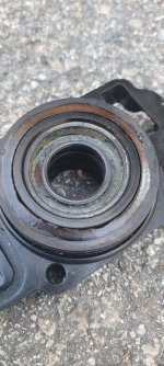

That's what I thought too. The cover has the o-ring on it still. I will show a picture in the morning. I haven't found another cover so am wondering if I can still use it
gica
Feb 24, 2016
583
Here is the cover and the piece they go into each other. Don't know if it is broken or it goes seperately. It has 4 grooves that it fits in. Second picture shows the areaon the cover. Should I JB weld it together?
Or silicone it?

I am a bit puzzled, have never seen that typ of cover but it looks like it is broken.
I can not determind that.
Maybe jerryjerry or pnwboat will chime in.

It actyally fit back pretty good and I hb welded it. That holds the o-ring in place.
Should be all good now. Last night I did the forward gearupper shaft and bew bearings. Replaced all the needle bearings from the spool assembly and the 2 seals pmus big o-ring. Also on the plastic Cover I changed tye 2 seals and o-ring. So today I willinsert tye upper bearing race and then the retainer. Get the cover onand water impeller. Do the bottom shaft reverse gear spool assembly and spacers plus retainer and be done with it. The right side motoris fairly new now top to bottom. Hope it will last awhile.Got to putit on water adjust the carbs.

Yea looks broken(never saw that before) fix? a thick glue will cause problems, superglue is probably the way to go??OH OH too late.

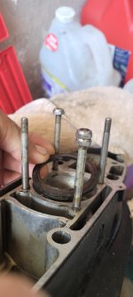

OK I installed the gears and the shafts with retainers. I am at the cover and water pump case. the top of the black cover in the center where the impeller is has an opening. There is a robber seal in the picture does that go on top or inside the black cover?

I got it could not understand why there's no seal inside the upper end between the impeller and the black cover.

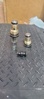

Check valves out. Where are these seals?
How do I get to them?
