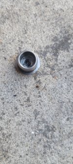

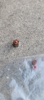

Ok one done. I use a heat gun. Safer.
The black are is tye old seal I guess.

tg3690
May 7, 2019
1,121
Good job! The little black seal in that hexagon shaped part....use a pick to get it out....then put one of those red ones in there.
Three more to go......and great idea using the heat gun.

In the link it showed flat side out for the little seal

tg3690
May 7, 2019
1,121
That's correct, according to jerry's pic.....

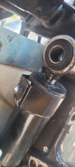

gica
Feb 24, 2016
583
Wanted to point out that there is a lip on the contact area and it is not flat with the surface so it will press against the seal.
I hope that's the way it should be.

tg3690
May 7, 2019
1,121
I didn't get this far with mine, lol. Jerry will probably see this early in the morning if you want to be sure and ask him.....but I don't see any other way to do it.

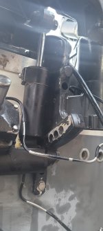

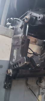

I put it back and even without bleeding it stays put. So it should be right.
But as I staryed to do the second engine
the line that goes to the tilt cylinder broke off the cylinder. Wtf.
The little part that's left spins and it might come off. I was trying to remove the cylinder by taking out the 4 big nuts but the bit bolt s won't come out even hammered. Looking for pointers.

tg3690
May 7, 2019
1,121
Maybe use some penetrating oil and heat......salt water probably has them solidified in there.....
may be able to find that fitting and a new line on ebay.....

jerryjerry05
May 7, 2008
18,196
Did you bother to read the sticky (post #4 ???)
It covered a lot of these things for the T@T
Pic# 193650 shows a broken Banjo bolt, can be expensive!! last one I bought was over 25$. Take the top of the ram and get it loose and the banjo bolt will fit over the top.
Taking the bottom bolt out is an almost impossible job, Most times they get damaged and need replacing.
An acetylene torch will help, just remember it gets so hot the aluminum will melt and it will NEVER come out.

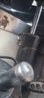

gica
Feb 24, 2016
583
I moved the top one. The bottom is stuck. That nipple is pretty bad I tried to spin it to remove at it did a few turns really hard to grab.

gica
Feb 24, 2016
583
That sticky deals with the valves I don't see any references to the broken Banjo bolt. I could be wrong
