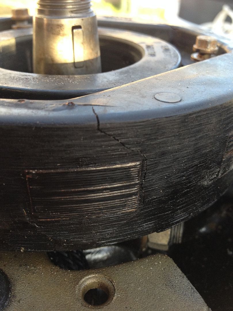

I picked up a used 18' Tracker Bass Buggy with a 60HP Johnson Pro Series the other day for next to nothing. Boats in decent shape but motor has no fire at all. According to the previous owner he thought the stator was bad so I checked the stator and it does have some cracking going on with the shell. It is also the wrong part number. The part number of the stator on the boat is 584560 which is for a 92-2001 motor. Upon seeing this I also checked the power pack which is also the wrong part number. The power pack part number is 584808 which is supposed to be for a 93-2001 motor.

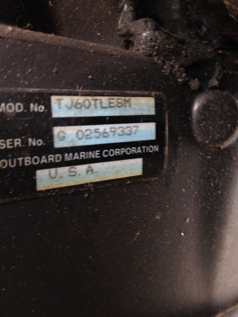

I forgot to mention that the model # for my boat is TJ60TLESM. Also when I look up the part number for the power pack that is supposed to fit my boat it doesn't look anything like the one that is on it. It doesn't look like the power pack that is supposed to fit my motor would mount with the way the bolt holes are lined out.

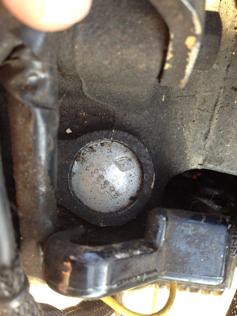

I check the serial on the transom bracket and it matches the serial on the freeze plug in the power head so I'm pretty sure that it's a 1990 motor.

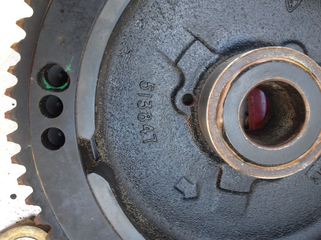

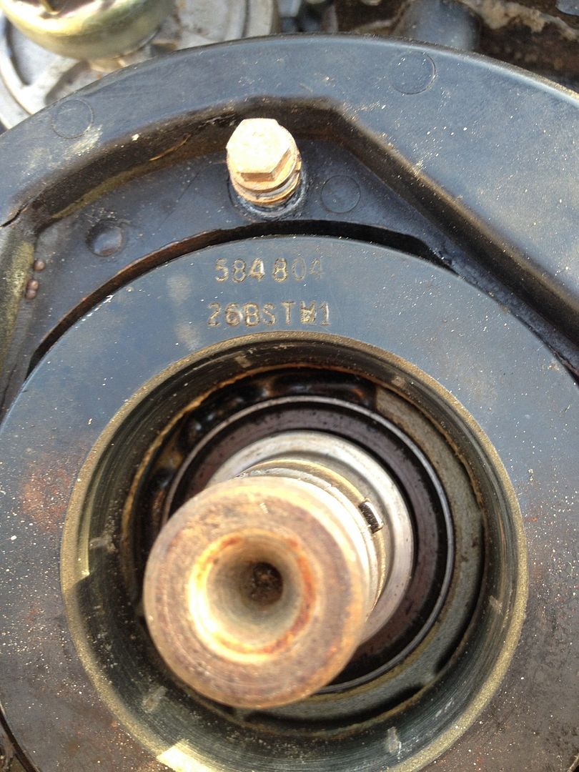

Post a picture of the flywheel.----May need the newer flywheel too..

Ok I will get some pics and more part numbers this evening. What really stinks is I ha already ordered a new stator based off the previous owners comments and the model number of the boat. I'm pretty sure that was a total waste of money now.

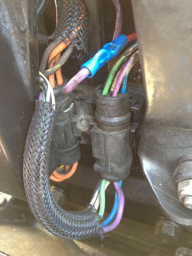

i'm not able to answer your question directly, but the power packs have different specs 90' 4 wire, 6700 limiter and slow mod,, 93' 5 wire, 6700 limiter, slow mod and quick start , maybe an upgrade?

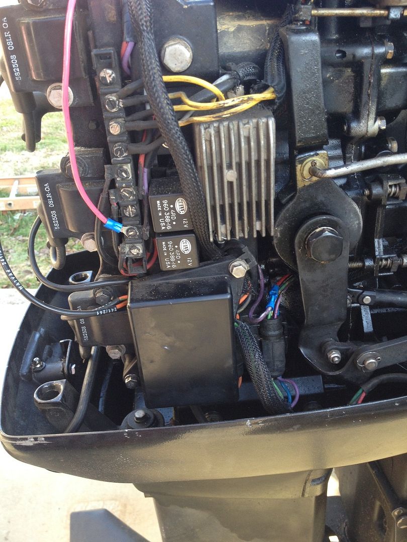

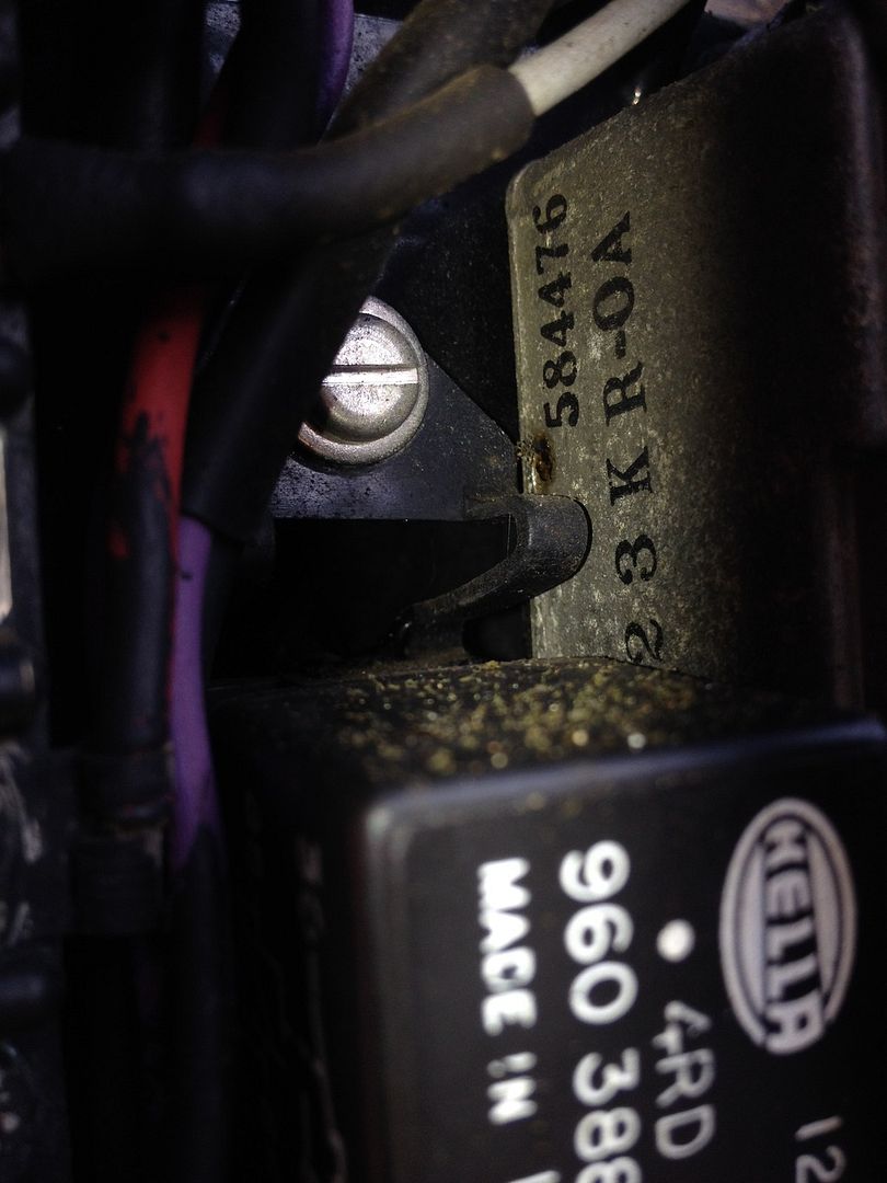

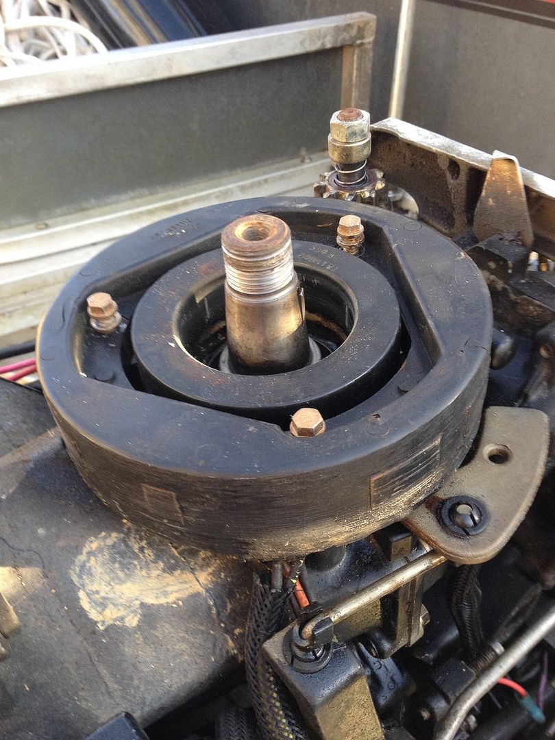

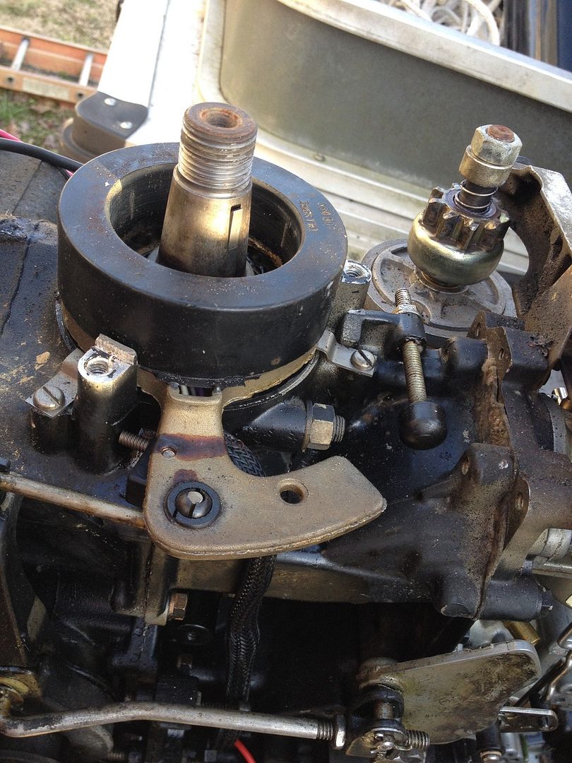

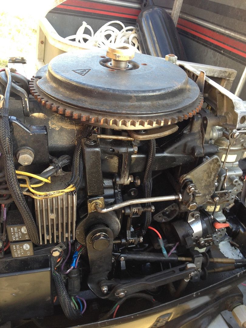

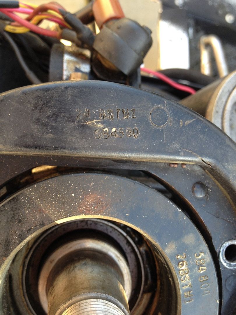

At any rate, I took some photos of all the mystery 93+ electrical components today. I really hope someone on here with more experience can shed some life on what sort of basket case I have purchased.

a lot of 93" parts, maybe just go with its a 93' , and start trouble shooting, for the starter there is a fuse close to the start solenoid to check, and yes odd there's nothing when directly jumped

I would get the starter working, then check the compression . Compression OK, check the voltage on the 2 brown wires from the stator. The stator has a crake in the insulation , stator probley. bad.

You know how to test,i don't, go to CDI and keep on testing until you figure it out, Cracks in stator plastic means replace it, make sure you get the correct stator.

I agree about the stator though. With the case cracked I'm pretty sure I need a new one I just don't know which one to buy. Somebody "upgraded" this motor to '93 parts so I don't know if I should go back to the correct stator or get another '93 stator

stator and power pack are matched now because of the 5 wire plug, the 90 was a 4 wire
