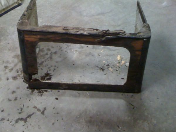

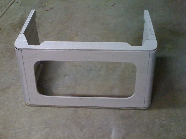

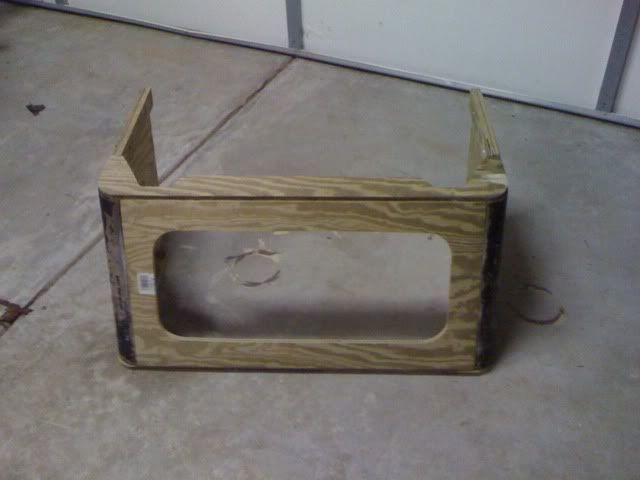

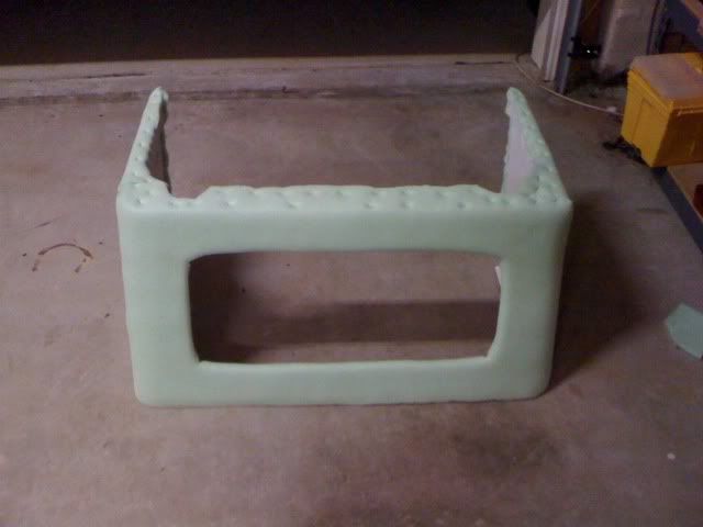

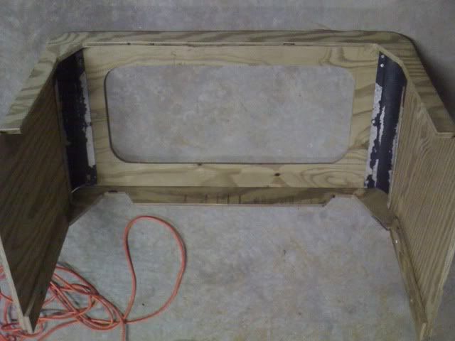

Well I 'assumed' I would need to round some plywood. foam, etc. But it turns out that there were already curved plastic pieces in the original construction.
Here are some pictures of the new motor cover (the quality isn't the best - I used my cell phone).
Let me know what you think. I'll post pictures of the old cover and its condition when I get home.
Thx
New cover with treated plywood.
New cover with treated plywood from the back. Notice the plastic corner pieces.
Some paint to clean it up.
Foam in place.
Finished cover - front.
Finished cover - side

That is some of the best non professional work I have seen! Nice job.

i can't find anything wrong with what you did.
Very nice work.
Should last a long time as long as it is sealed good.

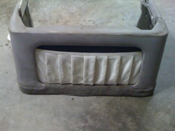

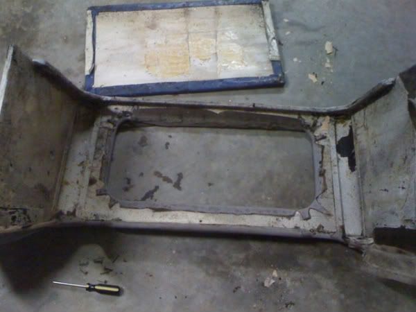

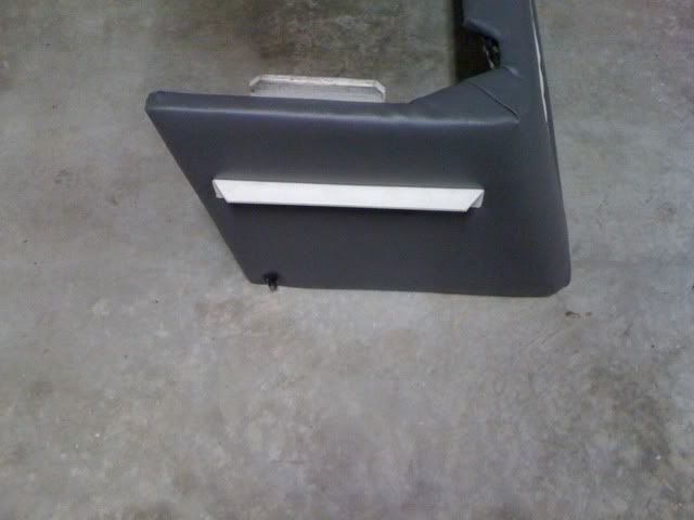

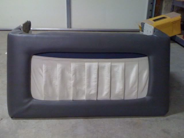

Here are a few pictures of what it used to be for comparison.
Old cover - front view
Old cover - back view
The vinyl is off. It was all I could do to keep it standing up without crumbling!

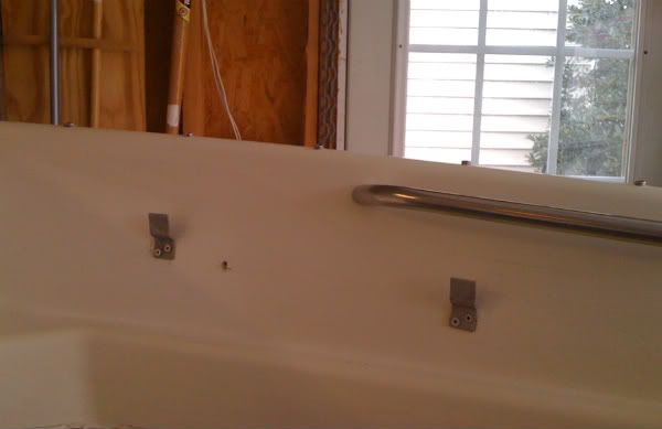

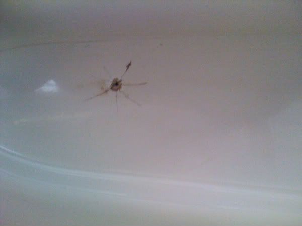

Last night I removed the bow bolsters. There were three screws accessible through the dash panel. After that there were two metal clips that attached to holes in the wood backing. The only problem I had is that there was another screw further down. The wood was soft so it just pulled out, but now I don't know what I'm going to do to replace that screw.
There is no way I could have reached it unless I popped the cap off. I was thinking that maybe one of those plastic fasteners used in cars might work. I just don't know. The other funny thing is that the screw on the other bolster was in a completely different place.
Any ideas?
