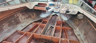

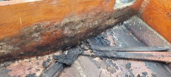

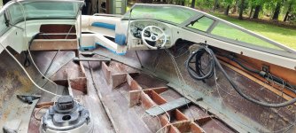

Initial exploration....

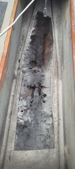

Ski locker floor... it was like ash.

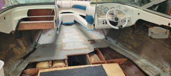

Between bilge and gas tank

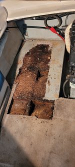

I ended up cutting out the fiberglass section in the front so I could get to the decking below.

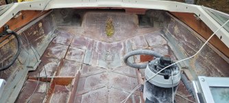

Current status
I'm currently grinding away on the fiberglass. It seems the main water issue was in the bilge area and it was not pumping out. As a result, the water was collecting and going up the center of the boat, under the fuel tank and ski locker. As a result, everything down the center line was rotted. The stringers up the side are fine so I'm not taking them out.

Yeck.....got me itching just looking at your pics.....good luck and keep us posted. Hope your using a good respirator !! Fiberglass dust is toxic to your lungs !!

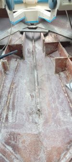

More progress... Removed the rotted piece running along the bottom (which I will replace) and cut out the lip of decking. Still need to finishing grinding some of the bottom to make sure I have a good surface for the new glass. Then will grind out the deck lip and sides.

Safest bet is put it back as it was only better. Mine had a "keel stringer" but it really was only under the fuel tank and I assume for support of the weight. (Triangle for strength) I extended it a foot or so in either direction because my fuel tank was larger and I figured it would tie in the areas outside the bulk heads.
It looks it was only done with chop strand on yours (hard to tell) so it may not be providing the same structure that you would get by using a traditional layup like your main stringers are.

Definitely a structural piece. To prevent the bottom hull from flexing in rough water or sitting on a trailer. Or even a couple of boat stands. Do it. It is the keel of the boat.

Saturday is grinding day so more progress today. Finished with 95% of the floor. Just a few places that I couldn't see when it was covered in dust. Also got the deck lip ground away and up the sidewall. Ground down around the transom lip well. At the top of the transom, I can only get a few inches ground due to the interference of the top cap. Any suggestions on how grind with only a few inches of clearance?

Finished with all the big grinding this weekend. Still need to hit a few small spots, corners/edges with a dremel and get that top area above the transom smoothed out. Also need to cleanup all the residue and dust. It's hard to believe just how much dust is still there after numerous blowing and vacuum sessions.
No matter how well you think you mask everything, it WILL get all over the whole boat. You never get it all.
Good job ao far. I can't see any signs of missed cracks or delaminations.
