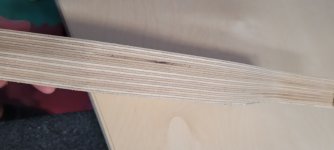

After some summer getaway time, I'm back at it. Made my fiberglass order from US Composite and found a local source with marine plywood. It's nice to be able to by it in by the sheet as I need it and not have to store extra as I really don't have room. Others have mentioned it before but USC can ship to a transit terminal and you don't have to pay the hazmat charge on the resin. Shipping was half of what it would be if I had it delivered to my house. Well worth the 15min drive to pick it up.

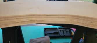

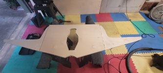

Got the transom cut out and glued using Titebond III. Based on the keyhole cutout, everything looks good. Did a dry fit and all looks good. Going to route out the extra space for the steering linkage at the top of the keyhole next. Hoping my USC order arrives by Friday so I can start the glassing this weekend.

I did cut the bottom off. It may not be clear in the picture but there is a couple of inches between the top of the drain hole and the bottom of the wood.
